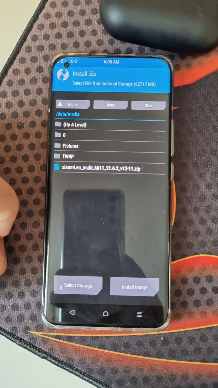

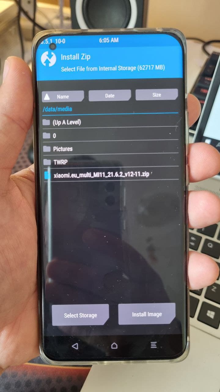

connecting the phone to the pc (Mounting USB Storage) will get 2/3 folders, if you copy the rom next to those two it will be on /data/media.
After that i can flash it.
Format data didn't worked for me when i tried, several errors, specially into mounting /data.

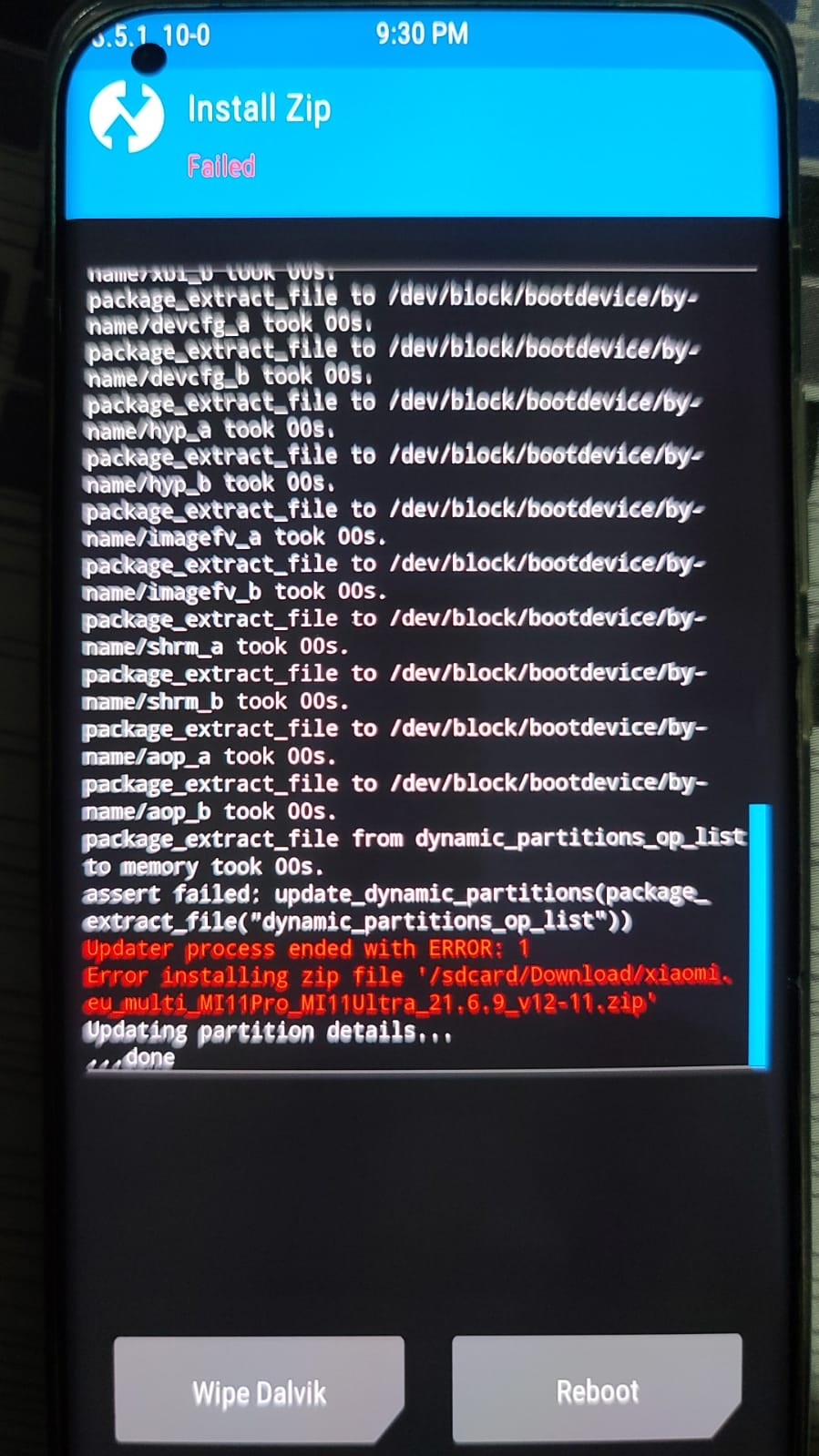

Hi All, I am having a problem when I update the weekly rom. I am using Mi 11 Ultra weekly 21.5.26 try to update to weekly 21.6.9 but the attached error stop me to update. Anyone how know recovery can help?
37366
Hi All, I am having a problem when I update the weekly rom. I am using Mi 11 Ultra weekly 21.5.26 try to update to weekly 21.6.9 but the attached error stop me to update. Anyone how know recovery can help?View attachment 37366
I think you should download the rom file by PC. Then unlock the zip file. Copy to phone and try to flash again
What does it mean unlock? I never unlocked the zip file with right mouse coz its not encrypted with a password and its working like a charme :)
Reactions: Poney70
Yes, that's true for you. However, in some cases, there will be an error when not unlocking as recommended by xiaomi.eu.
I have experienced it myself :D
Reactions: katerpanne

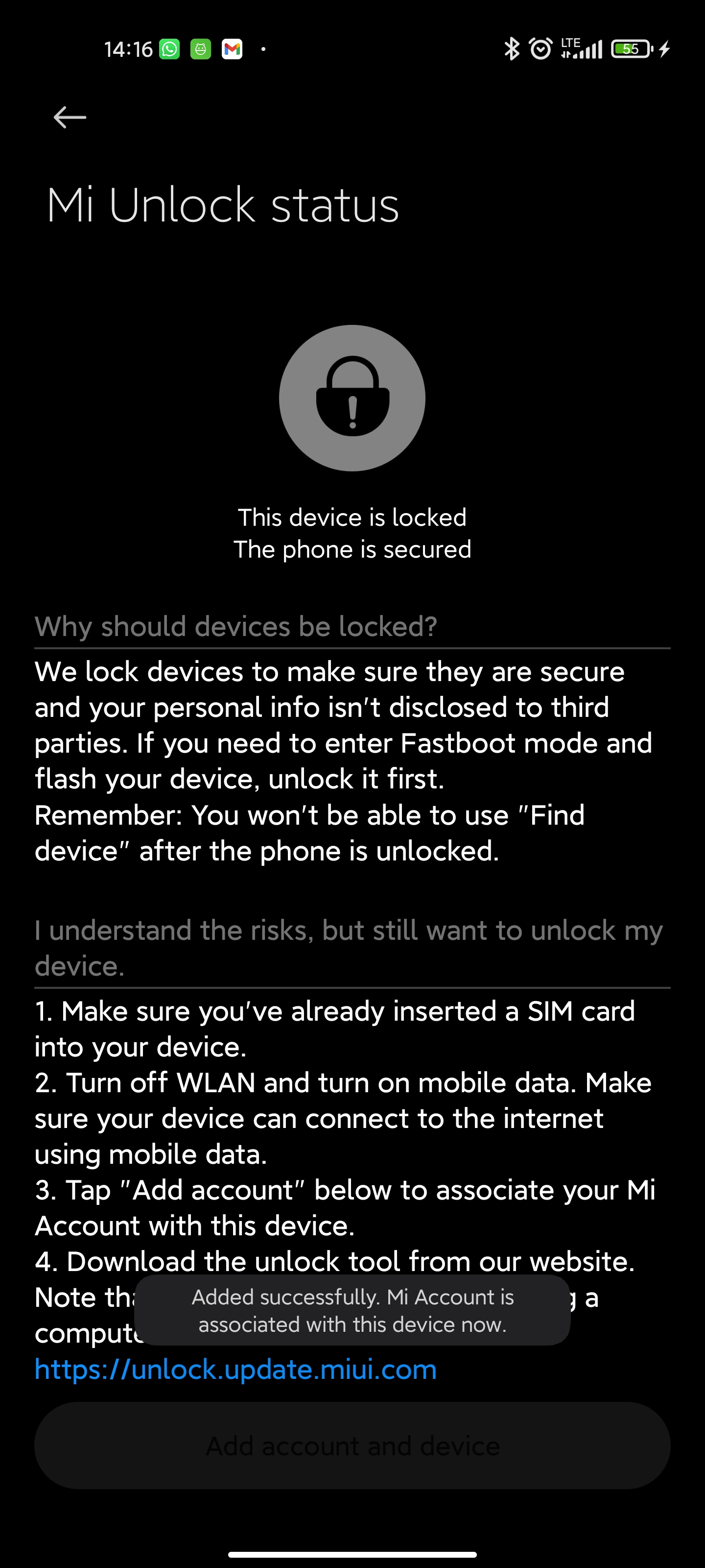

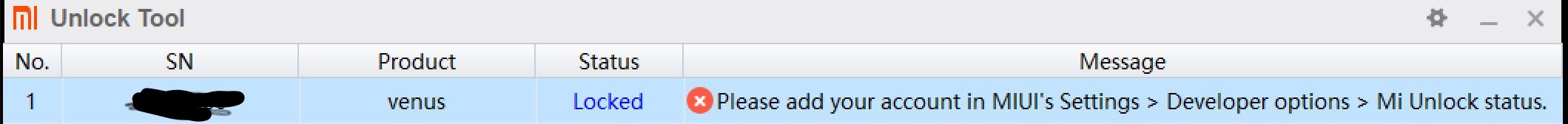

Hey there,
I was following all the steps to unlock my MI 11, but the Mi Unlock tool says "Please add your acoount in MIUI's Settings > Developer options > MI Unlock status." (see screenshot). I did this but when I'm tapping on "Add account and device" (yes, wifi is turned off and mobile data on) only a message appears: "Added successfully. Mi Account is associated with this device now." (see other screenshot)
I can hit that button as often as I want to, there will allways pop up the some old message. That status doesn't change and after turning it off, going to Fastboot I will still have that message in Mi Unlock tool... Is there a mistake during my process or can I do something different?
Thanks in advance... I'm becoming very desperate...

Hey there,
Thanks in advance... I'm becoming very desperate...View attachment 37368
This error is caused by your Mi account. You only need to log in with another Mi account to register successfully.
