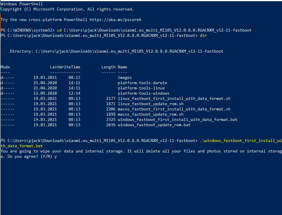

Thank you for that release. All seems to be straightforward. My Bootloader is unlocked, I've ADB drivers on my PC but waiting, and waiting... and nothing happens. Screenshot below.
I tried through PowerShell and normally, by opening the same .bat file. Any ideas why it's not going thorugh?
Install TWRP and latest of our ROMs...
ah right..
restart your device to fastboot mode..
I've been restarting it a few times now. Maybe Current ROM (MIUI Global 12.5.1.0.0(RGACNXM) blocks it somehow?
