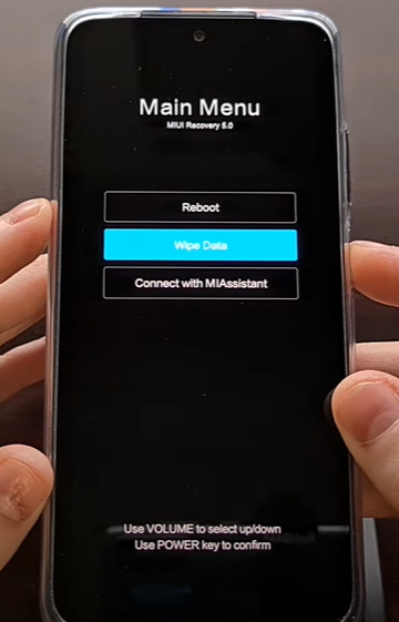

If you are using a fastboot ROM:
1. sign out of your Google account
2. Sign out of Mi account
3. reboot to MIUI recovery
4. wipe data
5. wipe all data
6. reboot to system
Or install TWRP and follow the previous procedure.

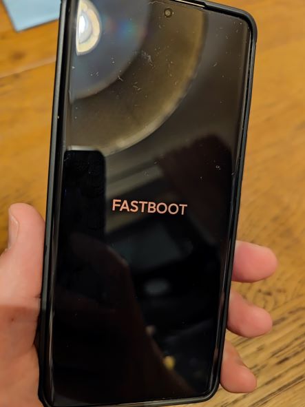

Hi, just got my 12S ultra. When I have been using 10 Ultra and 11 Ultra the fastboot mode have looked exactly as in all instructions with the blue text at the bottom saying "FastBoot" and then the dog(?) in grey and a green andoid.
When trying to start my 12S Ultra in fastboot mode I ONLY get one row with orange text saying "FASTBOOT". Also (the important part) the computer can not see the phone.
Anyone that can explain why this is the case and what I can do about it because currently I do not get anywhere when trying to use the Miflas unlock tool.

did you install the adb drivers? You can find it in the Xiaomi Unlock Tool folder
Reactions: tusenkonstnar
The instructions in the original post aren't for the 12s ultra, are they?

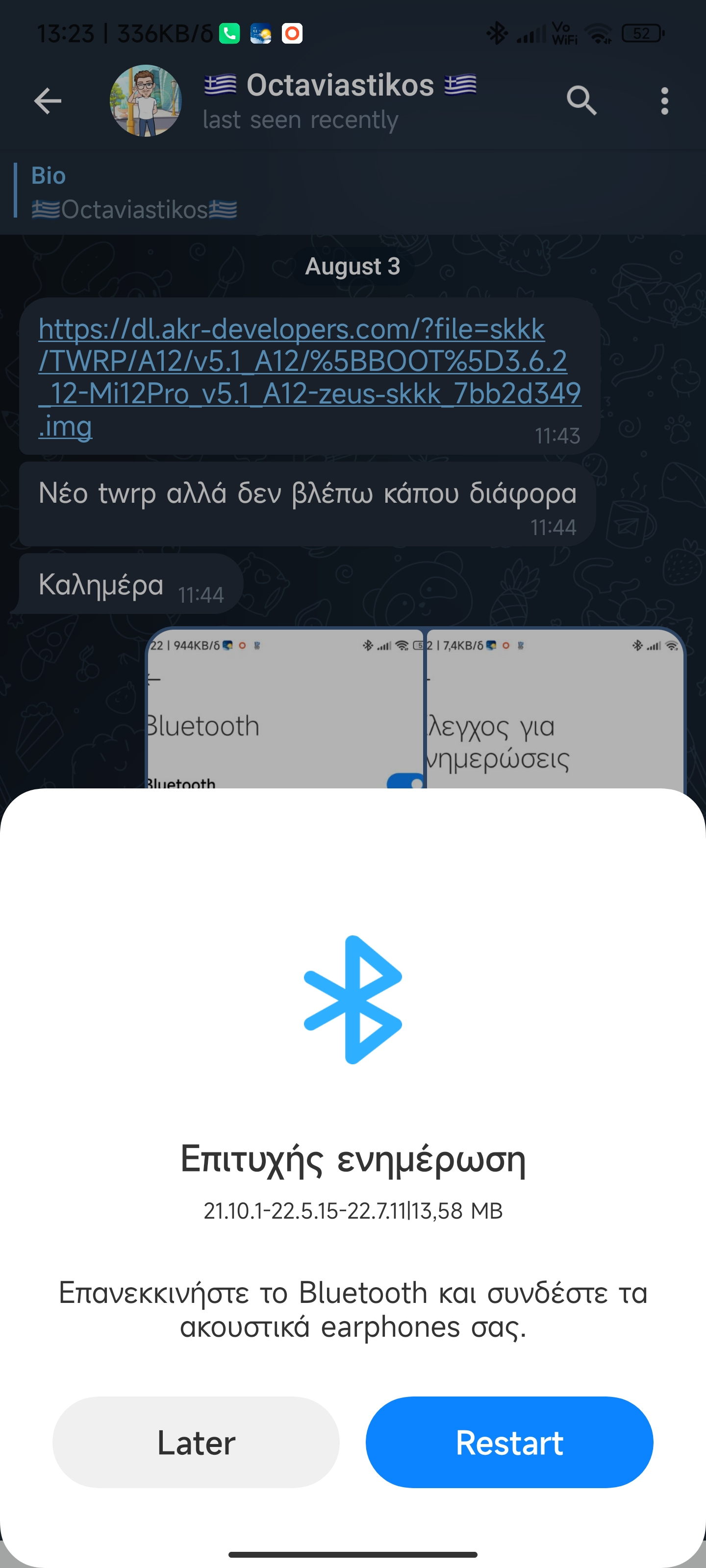

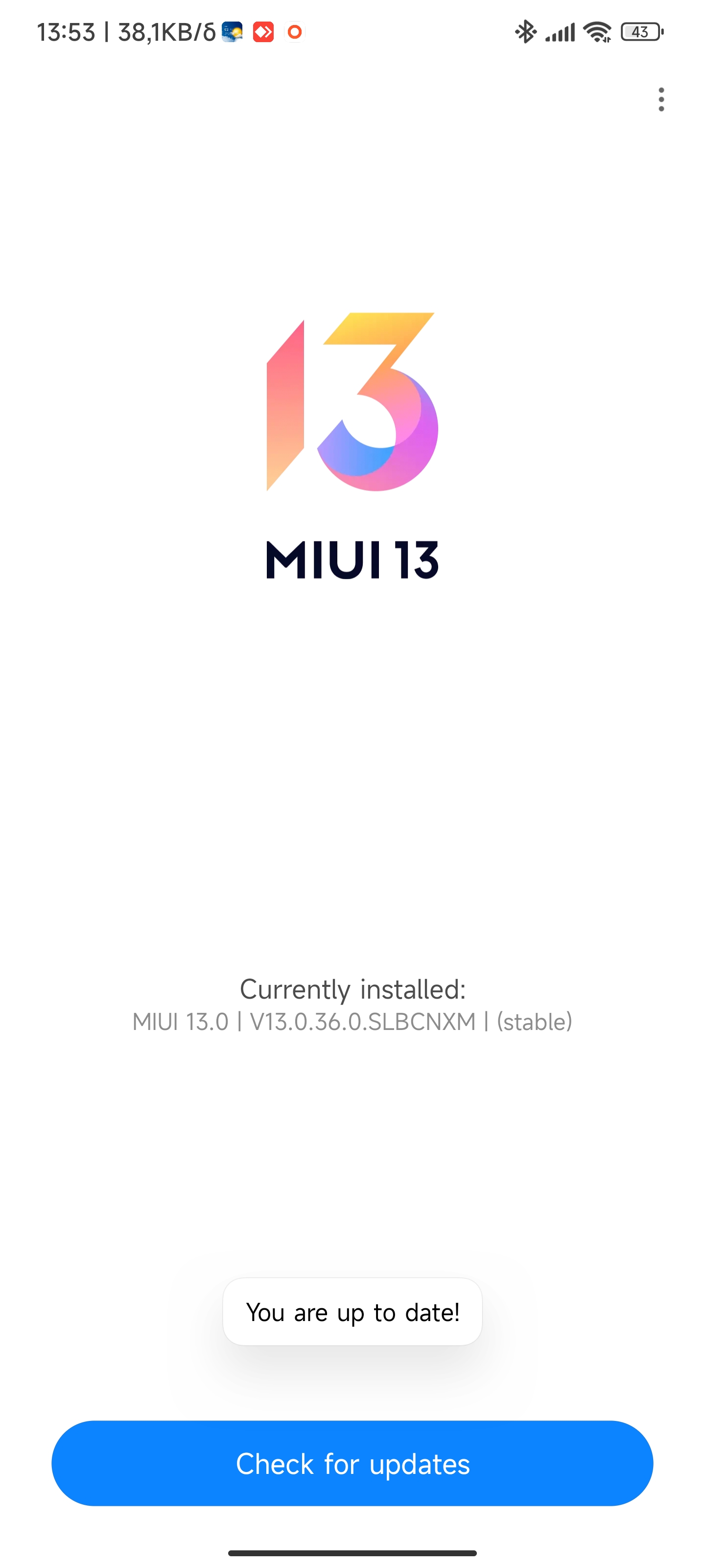

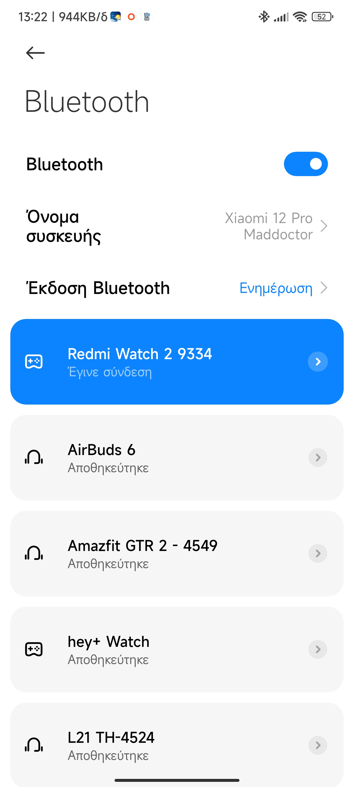

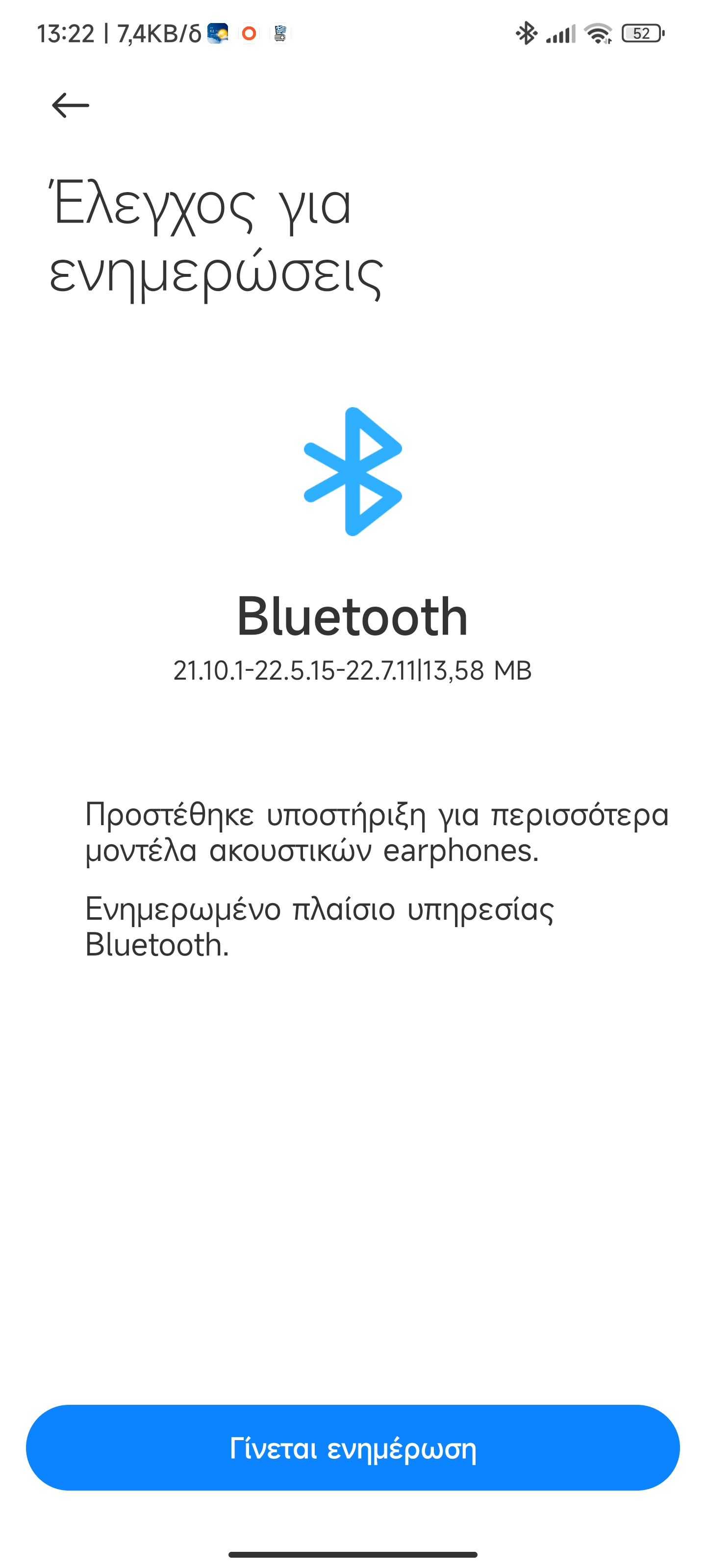

Something strange just happened. I have the latest ROM from here, the 36 and just got an update only for the bluetooth. I went to my BT menu and was waiting for me to download. Images are in Greek, but I guess you can understand. Check yourselves if you have any similar update to do

I guess it will dissapear after activation with simcard. Will try that first and write again if that is not the case.
I had but I had missed to activate with SIM-card in phone. Now I have started the "168 hour process". However even now when it worked I got the orange text and no graphics so it did NOT look as in all instructions/examples.
