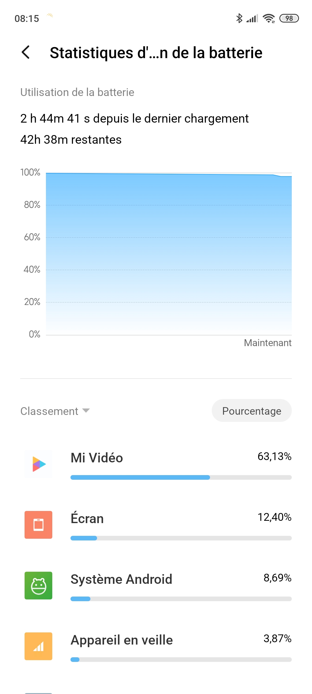

Thanks for the work you do. Does anyone witness an heavy usage of "mi video" in its battery stats ?

I see the battery draining quickly, ie 10-15% during the night (7-8h). Battery stats say that Android system is consuming a lot of power. so I assume Doze Mode is not getting active. I've restarted my phone immedeately before unplugging it and it is a constant issue, i.e. not happening occasionally but frequently (all the time)
Has anyone seen (or better: fixed) that issue?

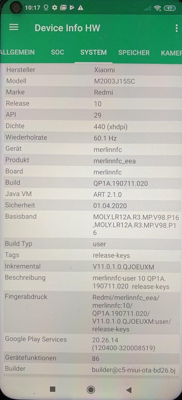

Install Device Info HW from playstore.
Post the complete screenshot like i have done
I fear you have the cheap note 9 with mediatek cpu.
This HW is not supported here, sorry for you.
His image shows he has the EU Merlin version of the Note 9.
So he should take a look here.
Krontas for future reference your on Redmi Note 9 Merlin (EU).

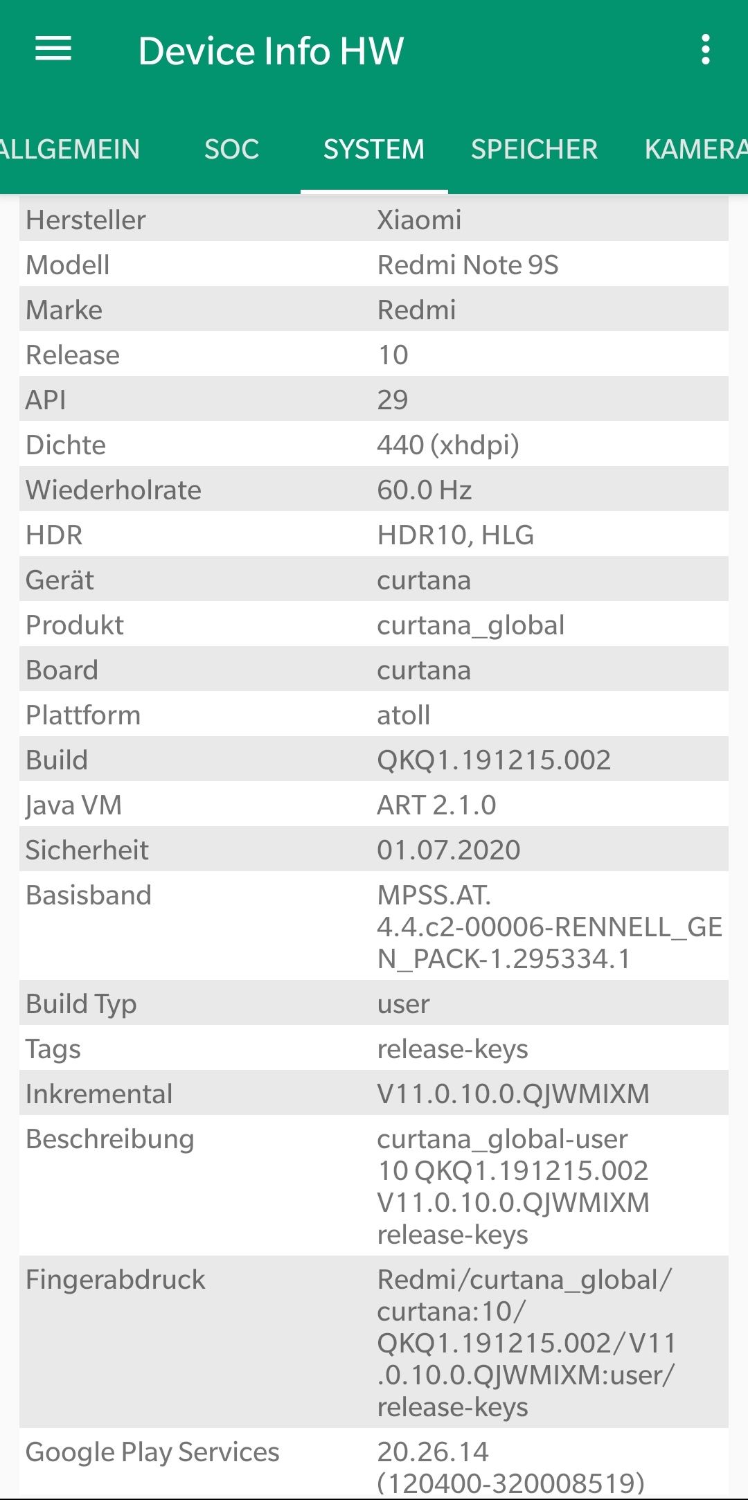

This thread is for the Note 9 Pro JoyUS (EU) version.
The other is the Note 9S which is Curtana.
You were trying to flash three wrong model firmwares.
Make sure you only get Merlin firmware.
Your phone is Redmi9 MEDIATEK HW.
NO rom available for this phone.
STOP everything before you kill it!
Go look at my post above.
He has a Xiaomi Redmi Note 9 Merlin EU rom also known as the Redmi 10x.
