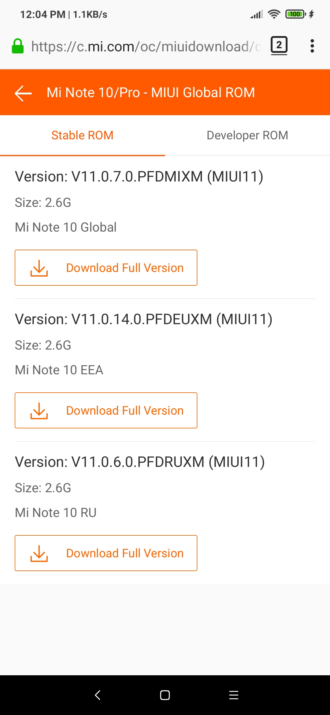

Did your phone originally have the global rom or EEA (Europe) rom? Normally the EEA roms get updated sooner than the global. If you go back to the original rom, you need the same rom version that you had before unlocking the bootloader or newer to avoid the antirollback
Thank you, I'm not sure and will try the EE -version. Or should i wait for the release of an Android 10 rom?

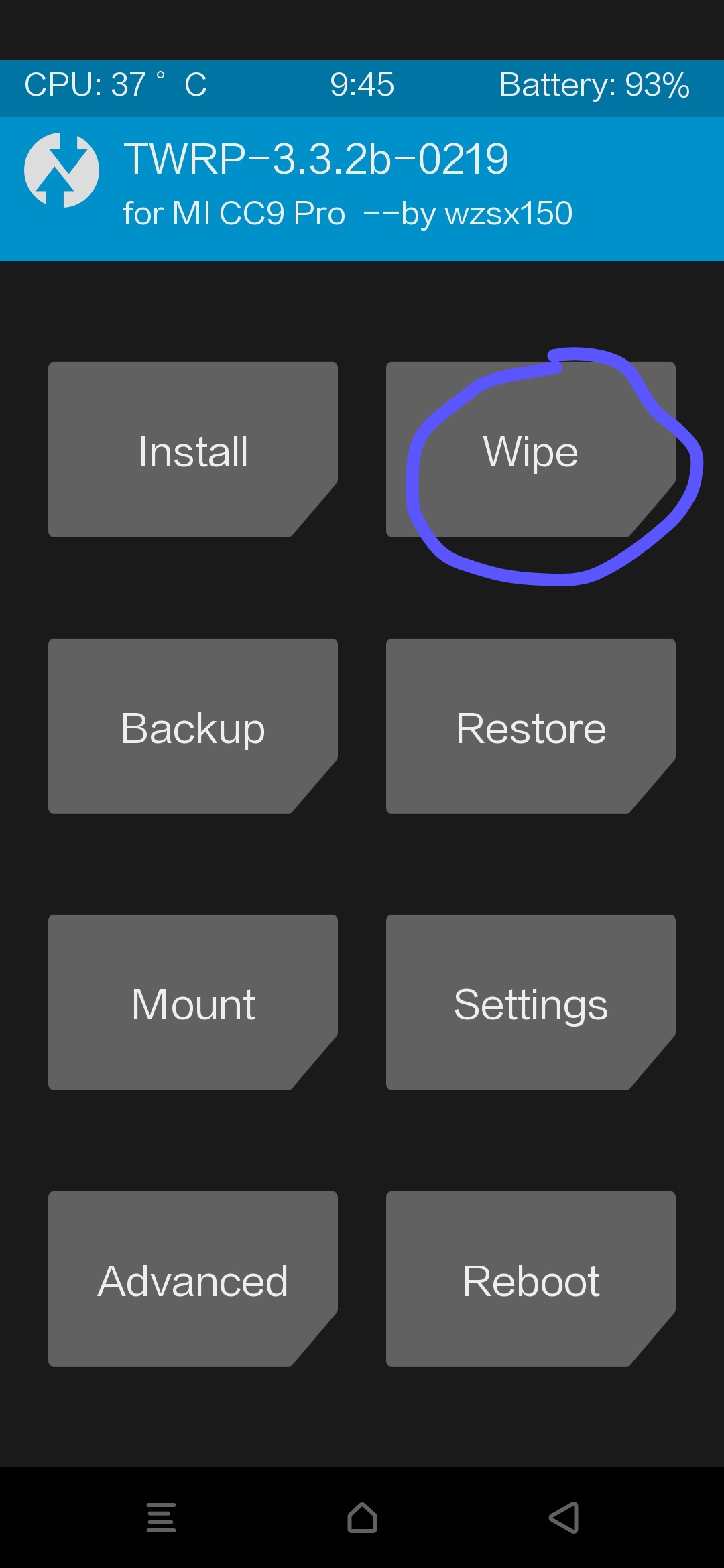

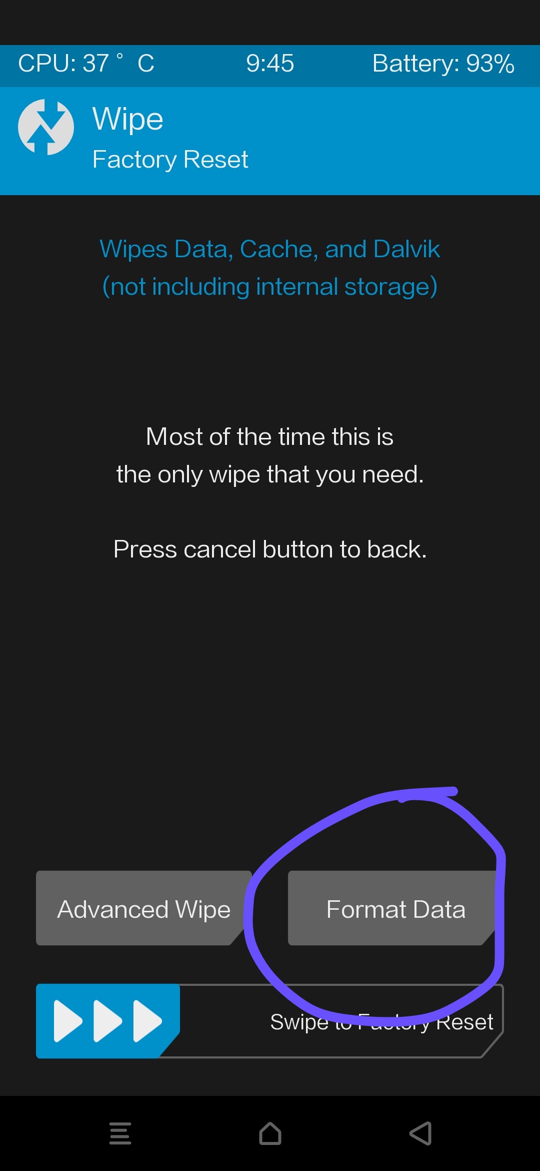

In TWRP, Format Data and type yes
Then factory reset in twrp

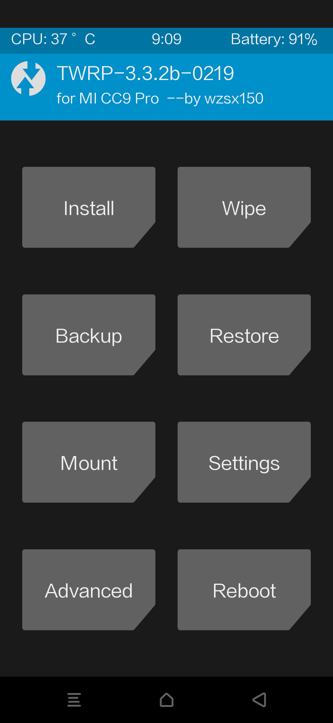

Are you using the same twrp. L.R. Team twrp seems to be the only one that works for me. The screenshot shows the version of twrp on top

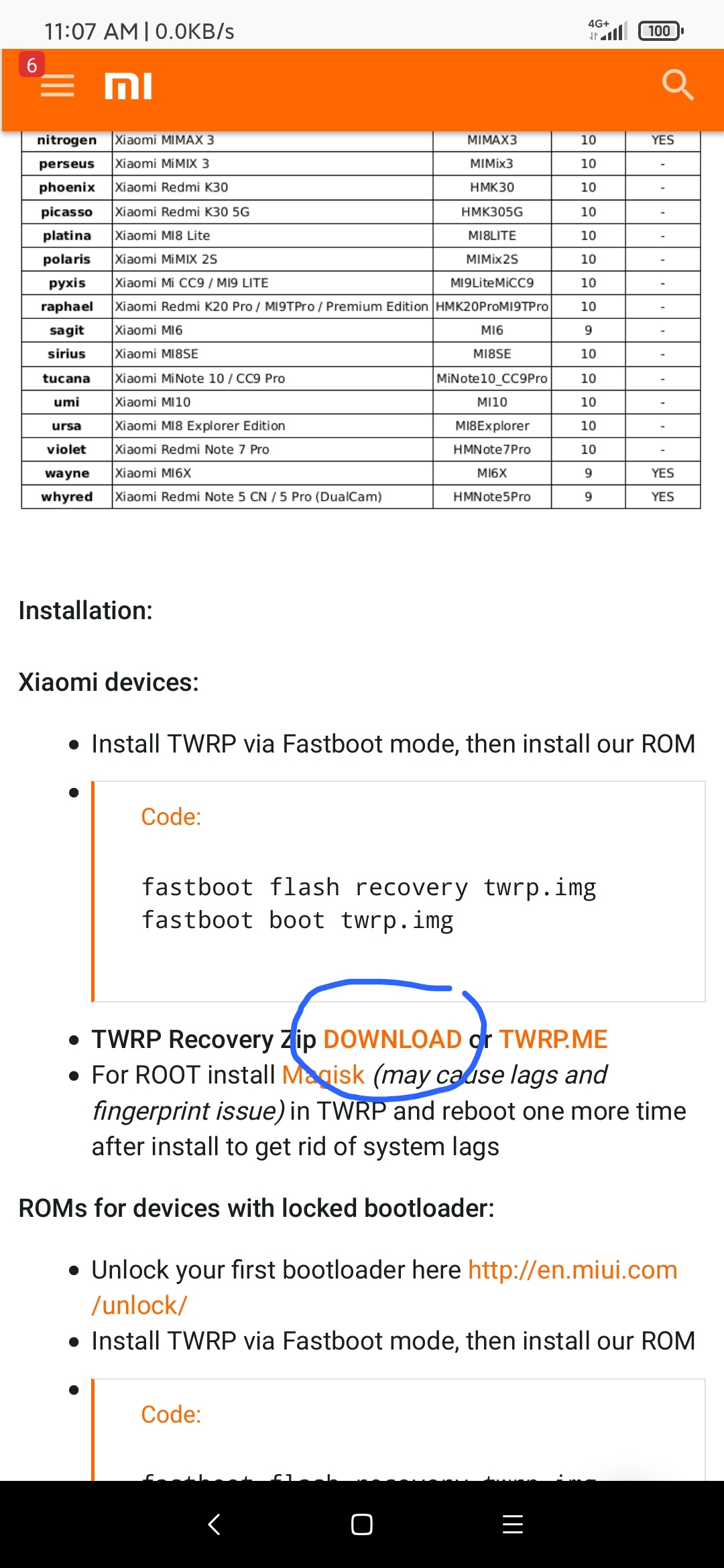

First page of the rom, click download. Look for the twrp for tucana. Works for android 10. It's the one I'm using
