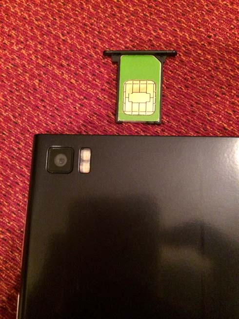

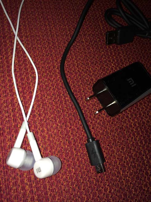

I bought a Xiaomi Mi3 from ebay. I received the phone and it smelled from the beginning but it is the first time i buy xiaomi so i do not have a point of comparison . But I opened case on ebay, the dealer never answered , so I escalated the issue. The item was protected by ebay moneyback guarantee. He replied saying that to get a refund you will need to proof that it is fake the latest by someone else third party and official . For this I'm here to upload photos and tell me your opinion . Also, there is nowhere authentic updater app as I think it should have been. In pictures please pay attention on serial number out of the box (which I did check but because they are in Chinese i did not get what it says , the only thing I know is that I bought it on 5/5/14 , and that I read say that they put fake serial numbers also ) and the serial number into the device .

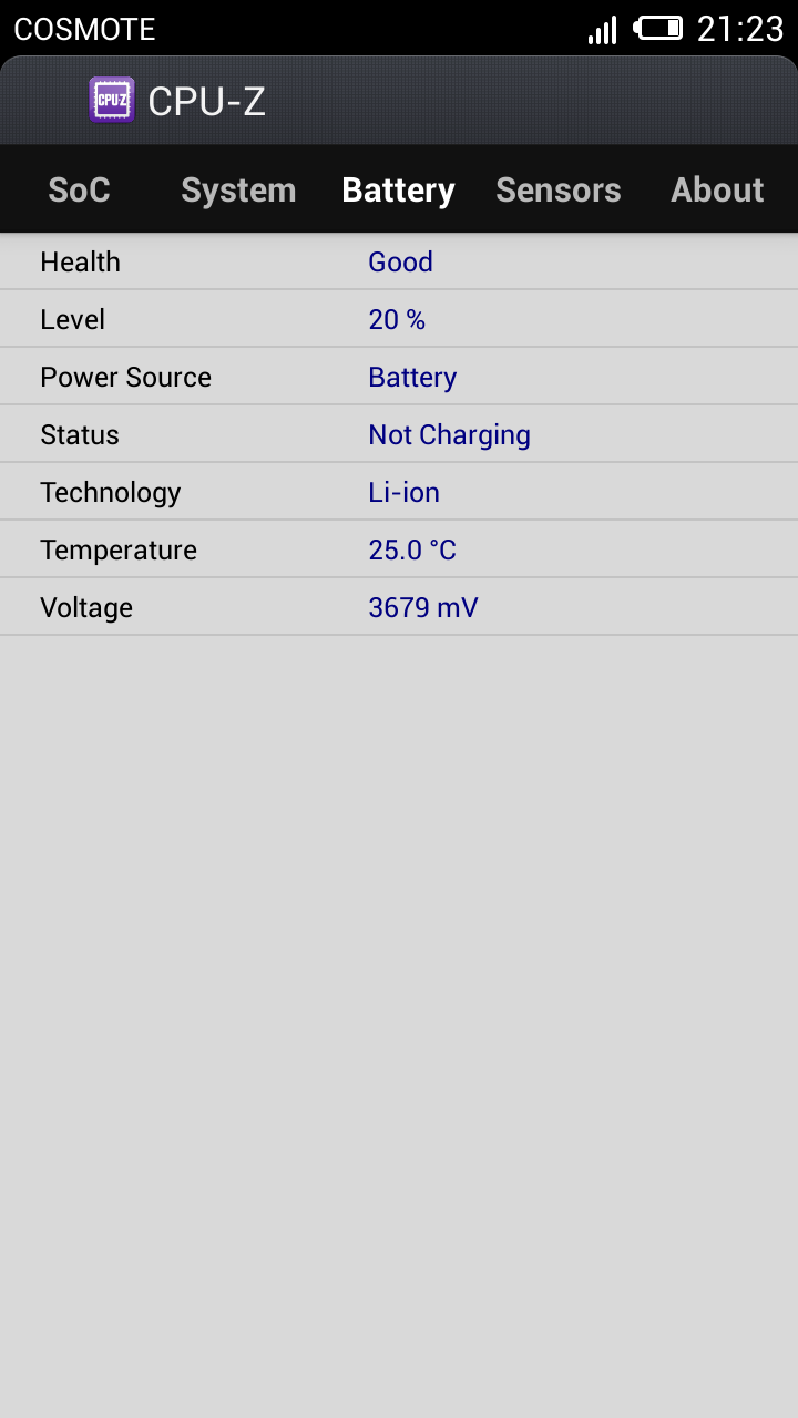

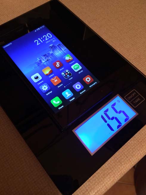

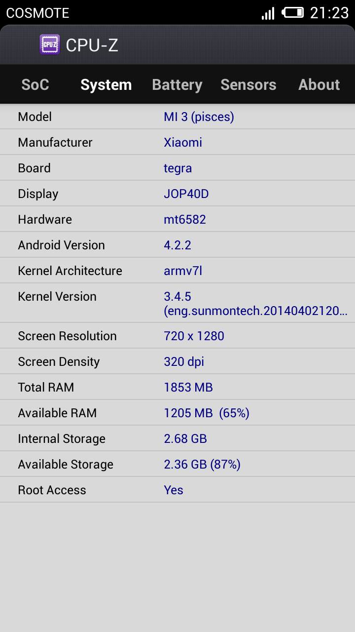

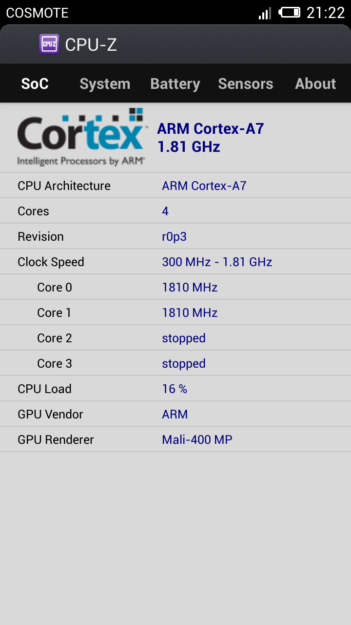

IMG_0787.JPG IMG_0792.JPG IMG_0797.JPG IMG_0806.JPG IMG_0808.JPG Screenshot_2014-06-04-21-22-59.png Screenshot_2014-06-04-21-23-35.png Screenshot_2014-06-04-21-23-44.png Screenshot_2014-06-04-21-28-55.png
Thanks for understanding.
The real MI3 has a Qualcomm Snapdragon 801 (shown as Krait 400 in CPU architecture)
So it's definitely fake.

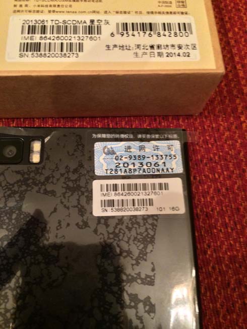

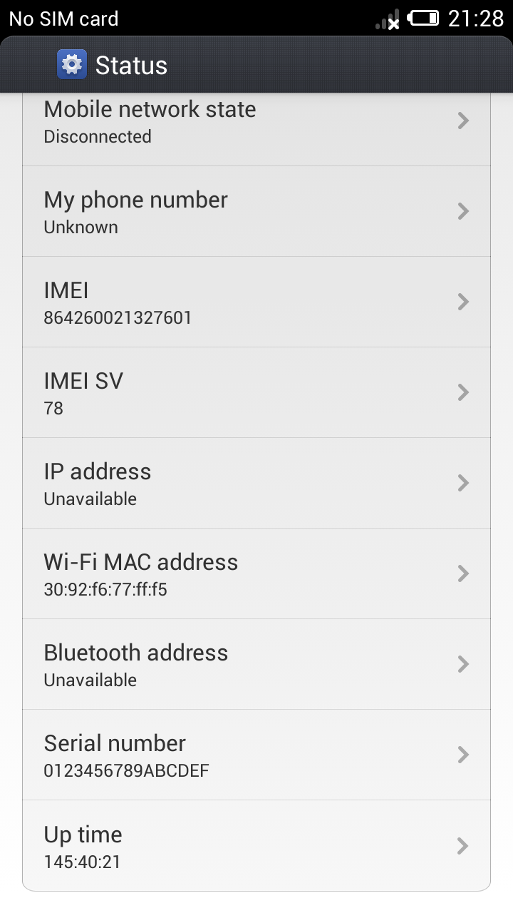

Serial number in my phone also shows something "real", not 0123456789ABCDEF.
The exterior looks almost like a real MI3 (i would say the border of the lense is a bit more "flaky" than the real one, although it's hard to say on pictures), seems copycats are getting better in making fakes :-(

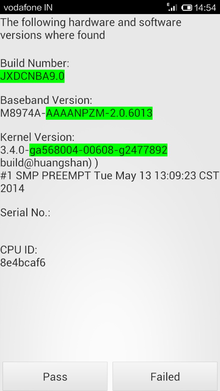

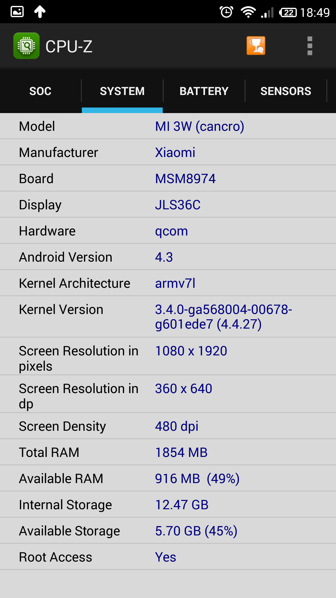

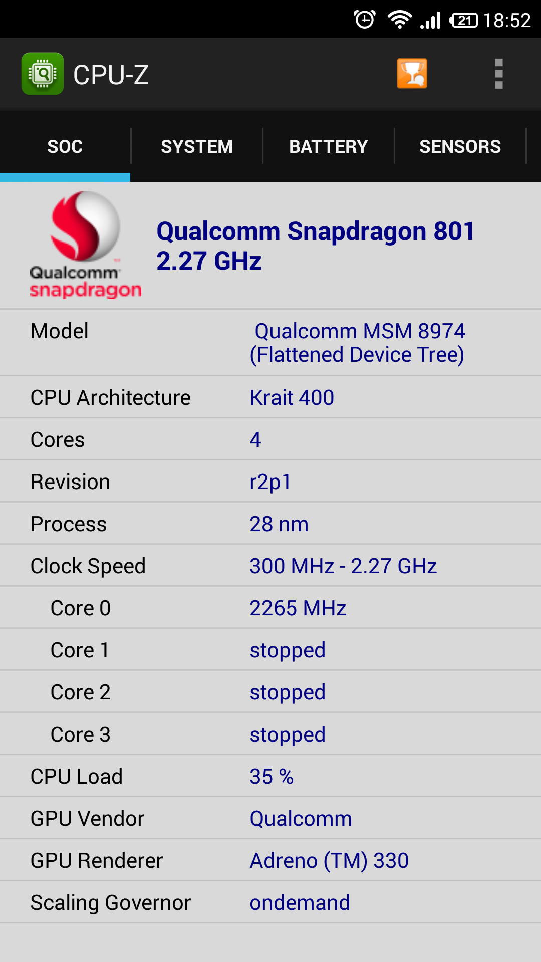

Screenshots from my Mi3W. Yep, your S/N is bad. I have 8 alphanumeric length code.
It will be hard to get such a document, because, eBay doesn't state WHO has to make this.
Anyway, I would make the comparison myself.
- (screenshots) of the real and the fake one (CPU-Z). Mark the Mi3 specs from the Xiaomi website, spot the difference with your screenshots, explain that they don't match the official specs
- They even seem to have copied a real MI3 IMEI number, you can check it on the main Xiaomi site: http://order.mi.com/service/imei. But the fact that the phone doesn't show the correct serial number I would definitely report this serial number and IMEI to Xiaomi. If they serial doesn't show up on the offical website, you have a bigger case to prove that you are right.
- Demand invoices from the seller, from Xiaomi. If he would have bought it from Xiaomi, he should have an invoice that states the IMEI number.

Also the serial in about phone, definitely bad. This is 100% a fake.

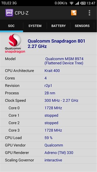

Sorry to hear that you got a fake one ... your screenshots can clearly prove that hardware doesn't match original hardware.
Here is mine which is original ...

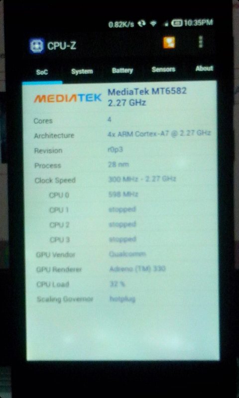

That's basically perfect proof. There are only 2 versions of the Mi3. There's the tegra 4 version which is only sold in China. And then there's the snapdragon 801/snapdragon 800 version. The cpu speed should be 2.3 ghz. Your cpu seems to only go up to 1.8ghz.
The other big indicator is the gpu which seems to be a mali-400 in your phone. Those GPUs are only found in Ti OMAP phones (which aren't really around anymore), Mediatek chips (which are cheap as hell and often used on fakes) and Samsung's "Exynos" chipsets. The Mi3 should have the Adreno 330 found in all Snapdragon 800/801 devices.

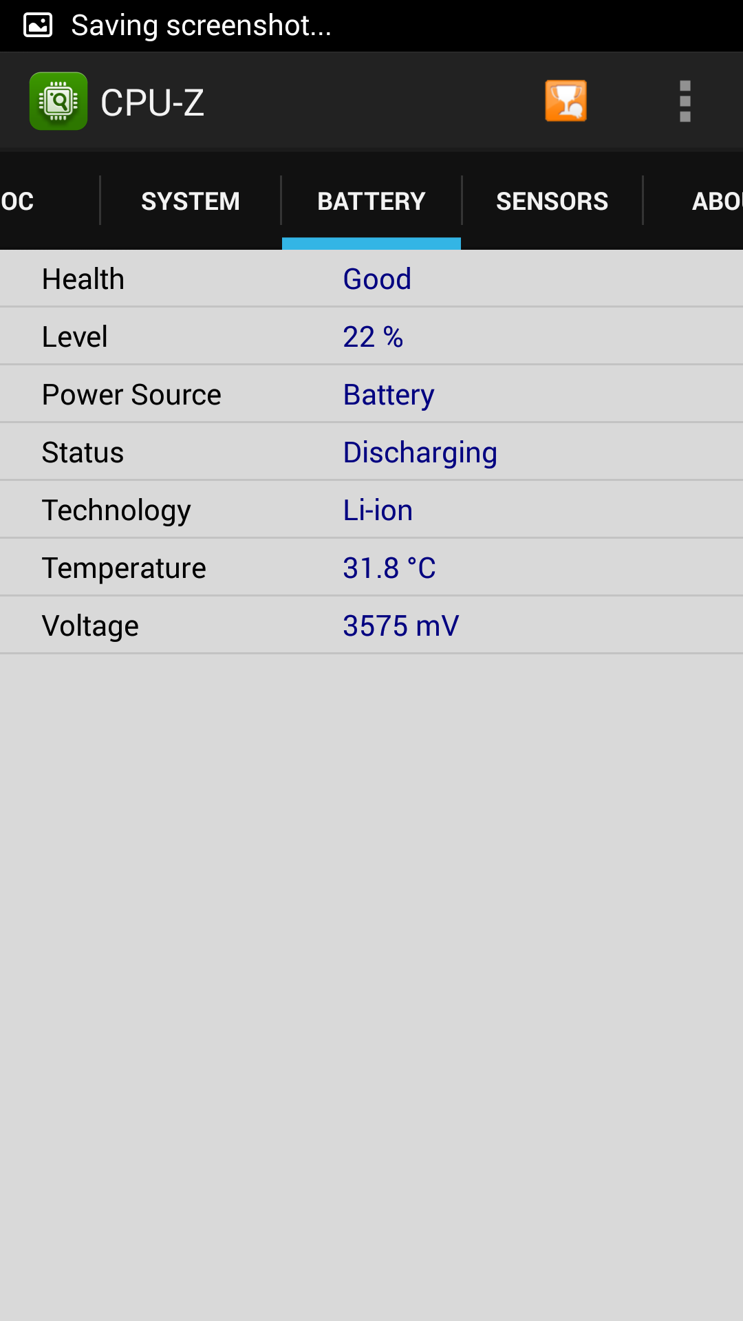

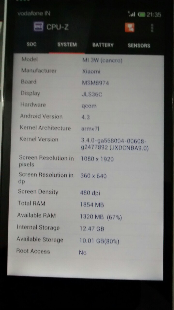

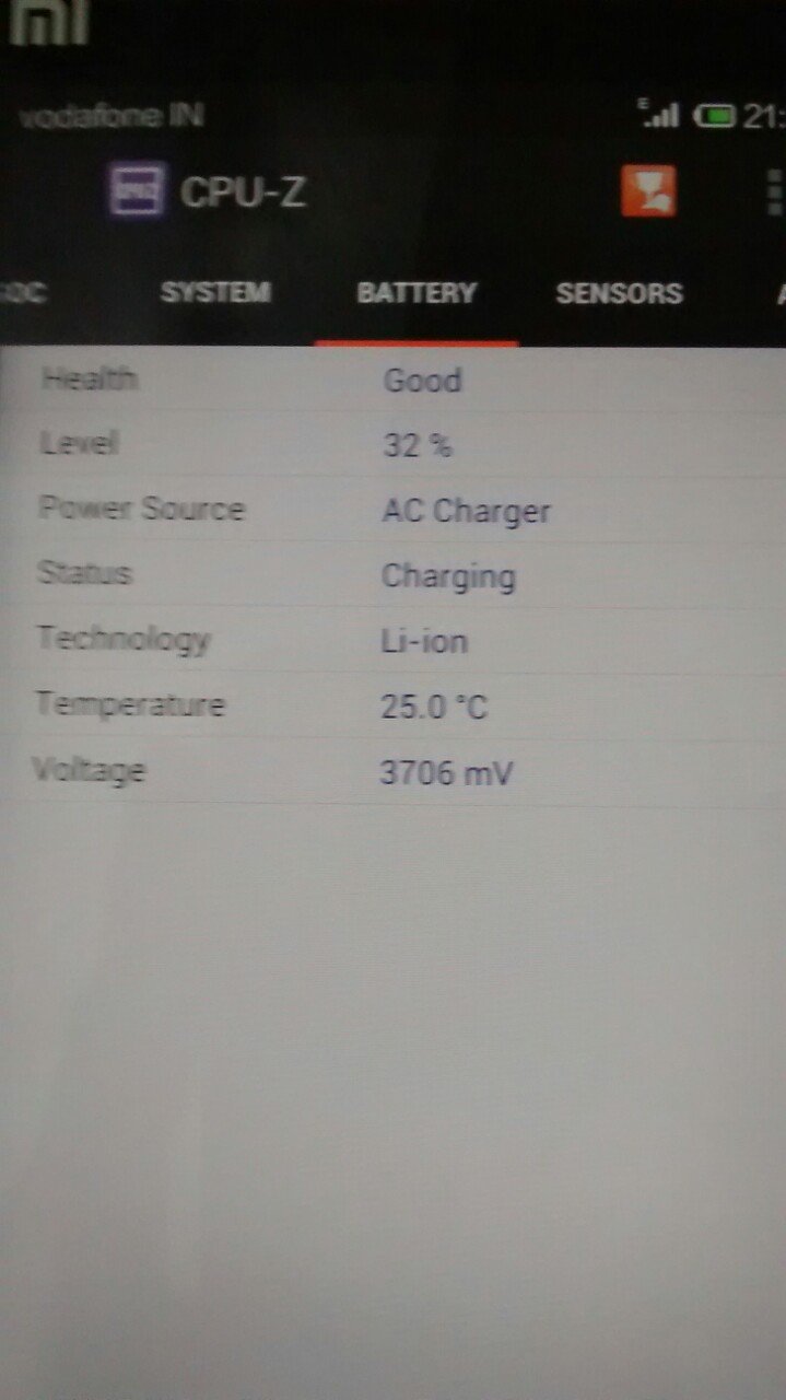

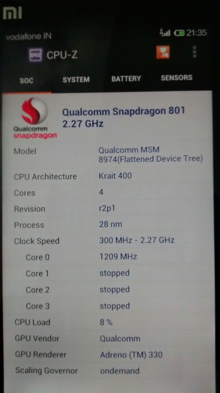

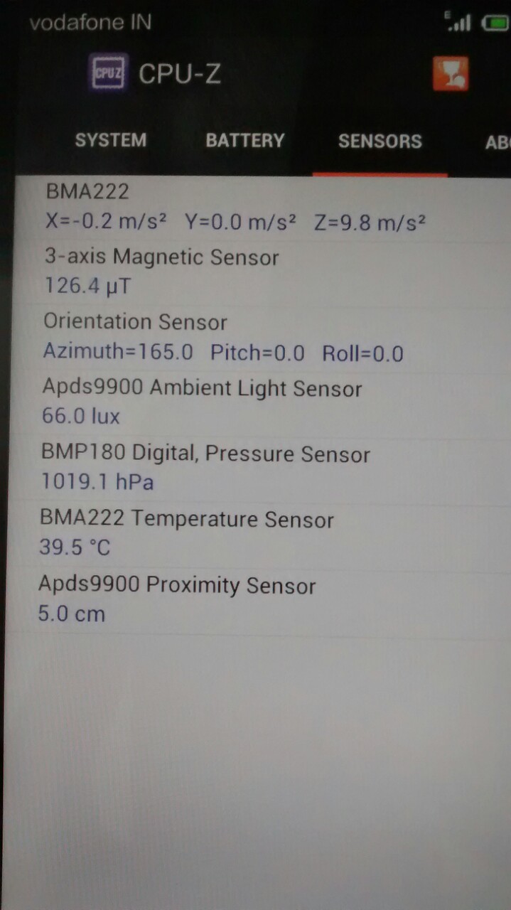

I am attaching cpuz screenshots. Everythg looks proper, but battery won't last a day. And how did eBay accept that its fake?IMG_20140706_213547332-1.jpgIMG_20140706_213558995-1.jpgIMG_20140706_213610638-1.jpgIMG_20140706_213618487-1.jpg
Well, I have bad news for you. Your Sensors screen does not look OK. Check
at about 5:34 and compare with your screen. You have way too little.
As soon as you submit case to eBay Resolution Center even without human intervention plenty of thing happened. If your item covered by eBay protection ( most are) they put aside amount equal to complete refund from sellers PayPal account and send email to seller strongly encourage him to find solution that will be acceptable for you. In case of counterfeit or fraud they also send you special invitation to call them and MAY suspend ALL activities for that seller also effectively freezing his access to his PayPal account. For serious professional seller it is what can kill his business.
SoC screens look OK. Battery screen ... Nothing special, but try to fully charge under ambient temperature of about 20C if possible, reach 100% and make screenshot. Sensors screen is NOT ok to me.

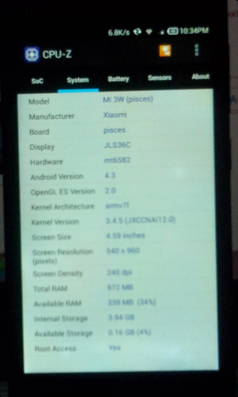

I have a fake MI3 i guess so, anyways hello people, i am stuck into a problem, as it had networking problem due to buying from other country (china), i thought of rooting and flashing indian version rom of MI3, as i was seeing MI3's official thread, i rooted the phone with a chinese pc software successfully, but then i checked the updater app, menu option isn't available, i was not able to select installation package, so i thought of installing CWM.img manually by some flasher, i flashed but then i restarted and i saw NO SERVICE!!!, after deeply checking i found, it was some efs problem, INVALID IMEI!!!, then i followed steps for MI3 official Imei repair, i was taking wrong turns, Recovery(Dead),IMEI Invalid, Then again i flashed a recovery again, Now The INTERNAL Storage Partition is dead, I am really frustrated, After some doubts i installed CPU-Z for processor info, Its showed MT6582, i was shocked, 1gb ram, Resolution 540X960, 240dpi. i searched Google, on official thread i found this phone is Fake!!
So now i started seaching threads for this fake phone, i found flashing technique by Sp flash tools (MTK only), i downloaded all required files for it (from need rom threads), as it said for flashing, remove battery, which is not possible, Please if someone has found some useful information, plz help me, whatever s**t i have buyed for real cost, i have to use it anyway!!! :(
