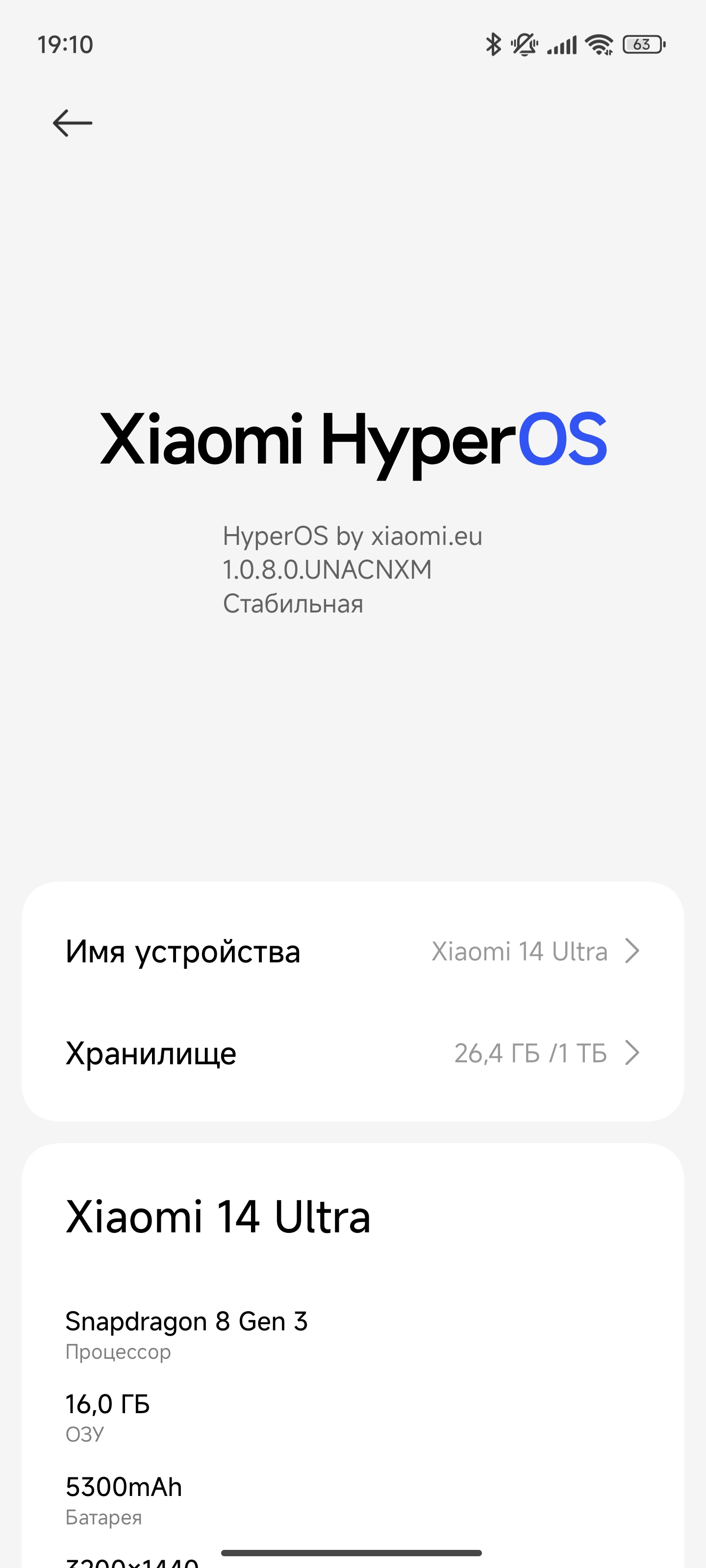

Hi everybody,
it looks like this installation method mentioned above works for all versions (global and CN). I have a Chinese one.
Install EU Rom 1.0.8 —> Fastboot loop —> Install original CN rom 1.0.4 —> Install EU 1.0.8 again —> profit!

Hi everybody,
Install EU Rom 1.0.8 —> Fastboot loop —> Install original CN rom 1.0.4 —> Install EU 1.0.8 again —> profit! View attachment 52166
