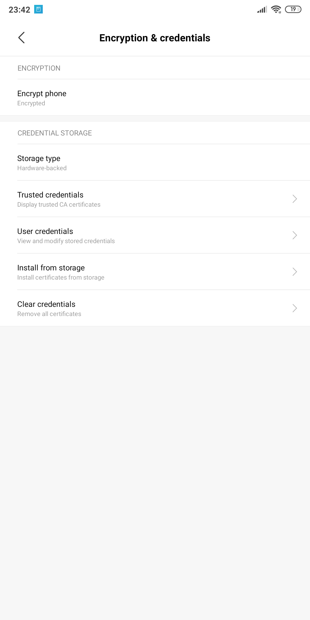

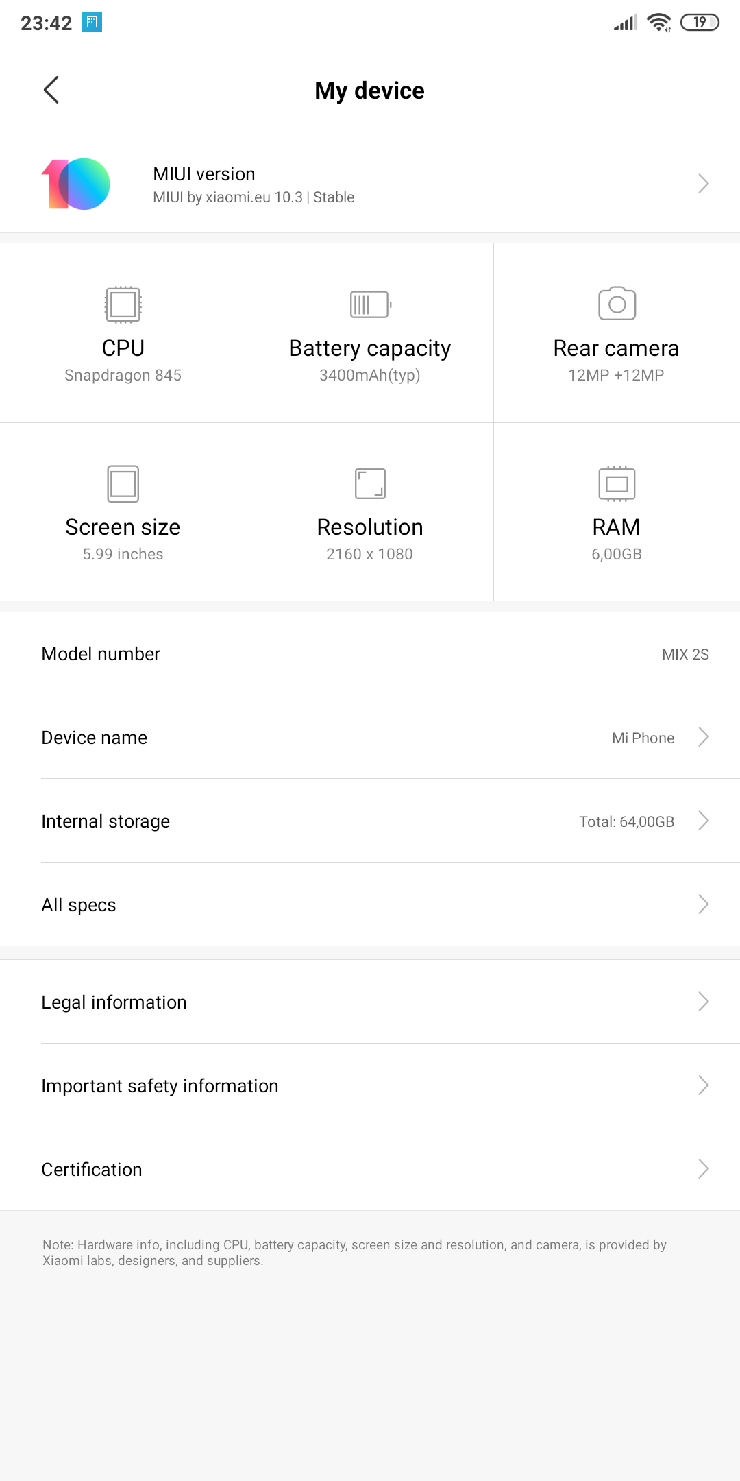

if anybody is interested i found the way to encrypt xiaomi.eu rom.
I downloaded miui_MIMIX2SGlobal_V10.3.2.0.PDGMIXM_7e27e6e0d5_9.0.zip and xiaomi.eu_multi_MIMix2S_V10.3.1.0.PDGCNXM_v10-9.zip
than i extracted these three files from global rom:
vendor.transfer.list
vendor.new.dat.br
vendor.patch.dat
than i deleted those three files fom xiaomi.eu rom
than i repacked xiaomi.eu rom with three vendor files from global rom (i used winrar, just drag and drop )
than i installed .zip on my phone
vendor.new.dat.br
vendor.patch.dat

Good solution.
Any trouble with the system rom doing that?
Did you check twrp is requesting password and decrypt as well?
Should be redone at every rom update. Required also for fstab modification
Fencrypt.zip doing fstab trip is simpler to use.
System is stable. Im using it since yesterday.
Using official TWRP it is asking for pattern or password and it can decrypt fine.
Yes i think it should be redone at every rom update.
Reactions: LOLO9393
