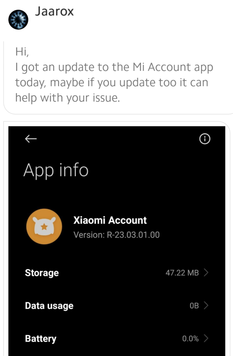

There's a new Update of the Mi Account App!
It said that many Bugs are solved!
Has anyone tried to unlock after the new update?
Thanks in advance!!!

No!!!
I tried to unlock my Renoir & a friend's phone (POCO X3 Pro) with ours EU Accounts: The same issue!!!
Keep your US Account!!!
The new update doesn't solve the problem!!!

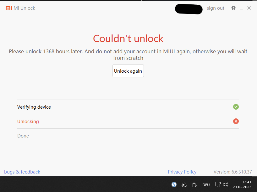

I tried with new us account but my wait time is now 1368 hours anyone idea? I tried with my original account from switzerland and after 600hours wait time it reset to 531 hours .
