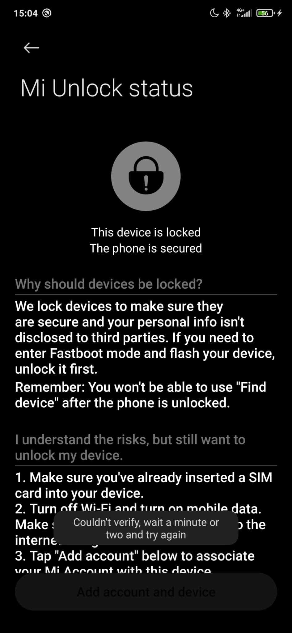

Hey All,
Lately Ive been wanting to refresh my Xiaomi Mi9t and put a custom ROM on there. For this I need to unlock the bootloader.
However when to do this, I need to bind my account to my device via 'developer options' -> 'Mi unlock status'.
Everytime I try this, I get the same error:
"Couldn't verify, wait a minute or two and try again."
What I've tried:
- Multiple accounts from different locations
- Multiple times login/logout
- Different SIM card slots
- All the steps with VPN enabled in CN/USA
- Find my device on/off
- sync on/off
- Language on CN/US
Posting on this forum is my last resort, sadly i've tried everything that is available on this issue.
If there is anything that could help me, I would greatly appreciate it!
Kind regards

Thanks for all your replies! I've tried everything but sadly they did not work.
However! I got it to work on a different way. Apparently I disabled some Mi services to access the Internet via cellular data, such as xiaomi account. This was why I could not bind my account.
I changed this like this:
- open scroll down menu and press on your used data
- press restrict data usage and scroll all the way down
- press system apps
- enable all system apps to access data
- try again
