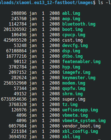

Can I unroot my MI 11 Ultra using images from MIUI 13 EU?
momenezes
Dec 27, 2022
I bought my MI 11 Ultra with Global ROM; last week I've installed MIUI 13.0.12 with fastboot.
My wish was to have certain internet banking operations working again, but it failed. Bank support said such operations would not work on rooted phones.
One such operations is validating credit card added to Google Wallet; this can only be done through bank app and it simply does not work.
Previously to installing EU ROM, Google Wallet would not even allow to add the credit cart, so I was very happy when it passed this first step.
So my question is: can I unroot my phone using images from MIUI 13 EU? I have these files:
Android version: 12 SKQ1.211006.001
Phone Model: M2102K1G
Thanks.

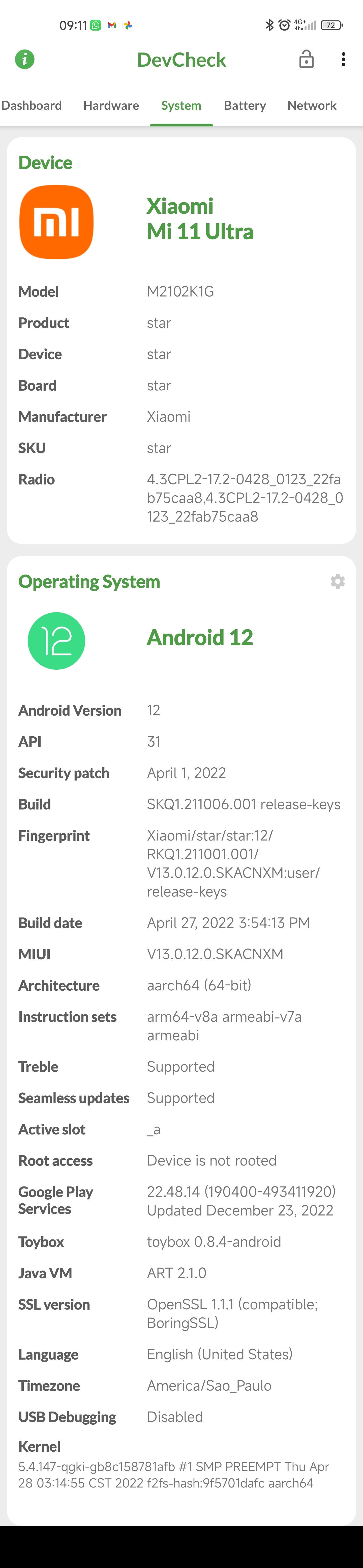

But I ran some apps (e.g., "Root Checker" and "DevCheck") now and both say my phone is not rooted. Confused now ....
Does "unlocked bootloader" means another thing? Or does installing Xiaomi.eu ROM through fastboot locked things again?
Any other hint on how to have those banking apps working on my device? Additional checks, config options, permissions, etc .. anything to help?

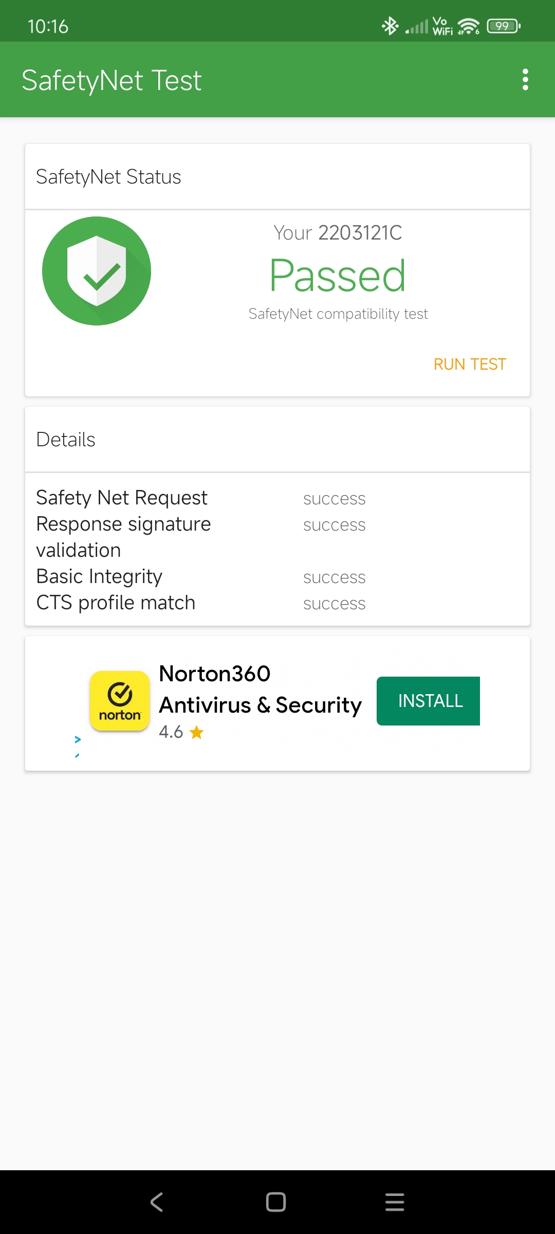

Test your phone with the safety net app (screenshot attached). It will tell you if you are secure. You may have magisk app still installed.
If you want to be rooted and want bank apps to work, there are magisk modules that can hide root from apps too, just do a search but if you just want a normal rootless phone, flash an EU ROM, check for the twrp folder and then check that safety net passes.
The ultimate way is to download latest EU ROM and use the first install option and reset your phone.

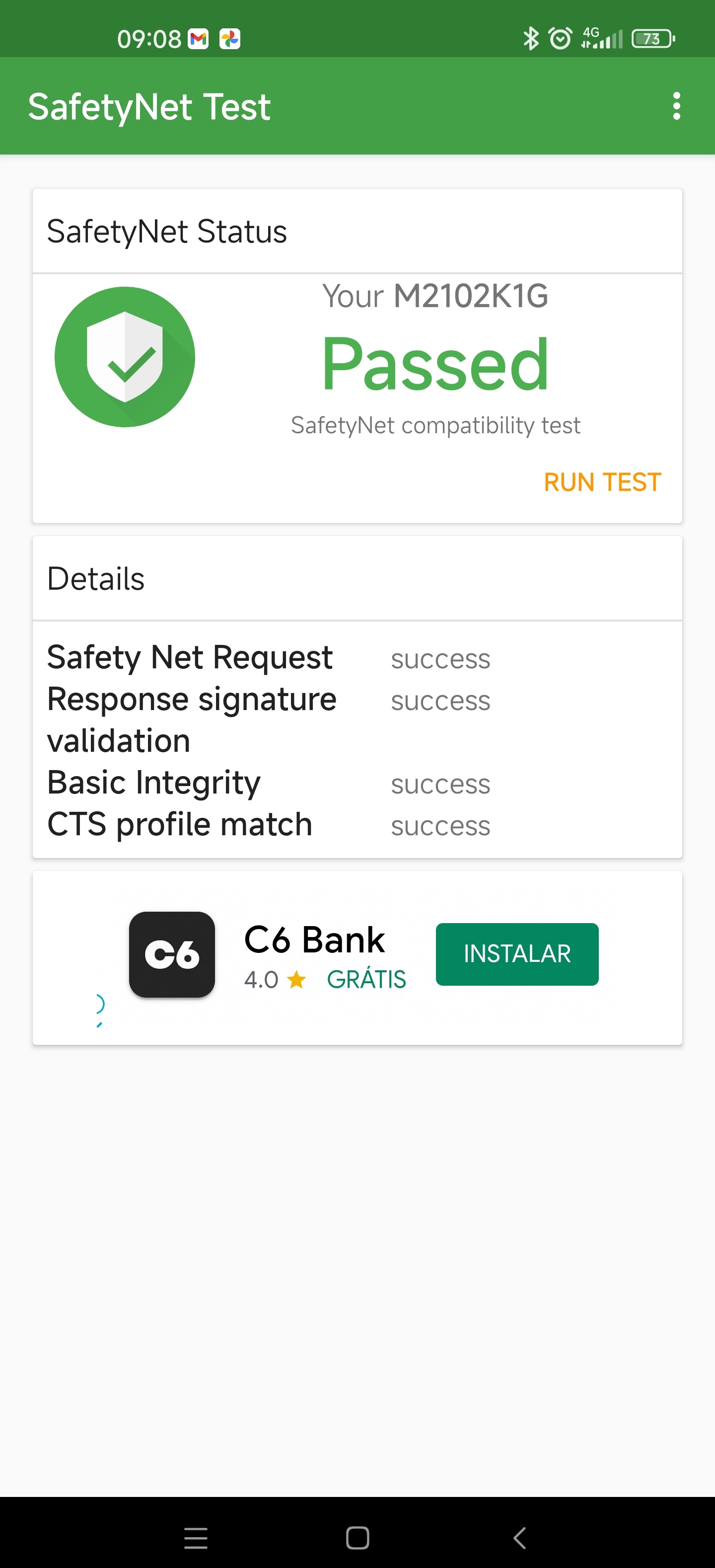

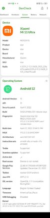

Hi, tks for your answer.
I don't have twrp folder and don't have magisk app installed; never installed any of these.
I've done SafetyNet app test (screenshot attached) and it passes on all test; did the same with other tool (DevCheck) and both seems to show that my phone should be ok with these banking app + Google Pay.
I'll have to wait for some update on their apps and also continue to ask their support channel for a solution.

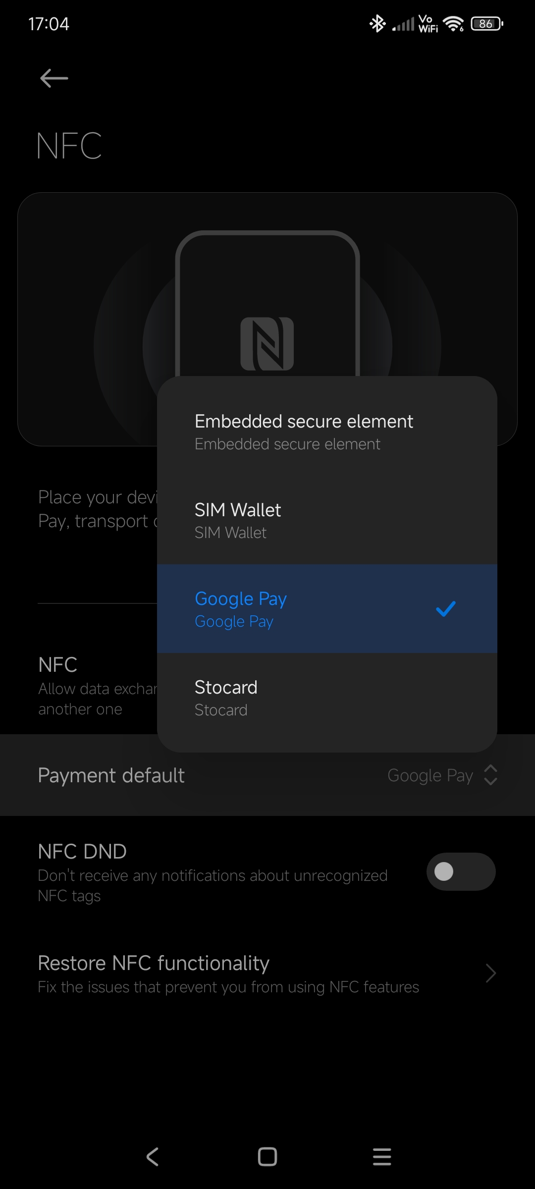

Which apps don't work? Maybe if we know,we can ask others if theirs work or not or if anyone has other get around. Google pay should work out of the box with EU ROM. Is it the NFC payment not working or the app? You may need to change wallet type to pay. See screenshot but it is from my 12s ultra but you should have it set to gpay.
Hi Mark. Tks for your answer.
I'm having problems with Itaú Internet banking app and also with XP banking app (Brazilian banks). The one that is working is BB (Banco do Brasil) bank app.
The problem occurs when, after adding the card to Google Pay, I've to validate it in the bank app. Error messages are useless; nothing can be used to learn about the problem source.
In the Itaú app, I'm also facing another problem with virtual card generation (to use on Internet payments); it seems to me that both problems are related. In this case (virtual card), the message says something about a suspicious activity on my device and because of this the transaction would not be allowed. Support channel are also dumbs; anything that goes beyond their script, they can not answer or help.

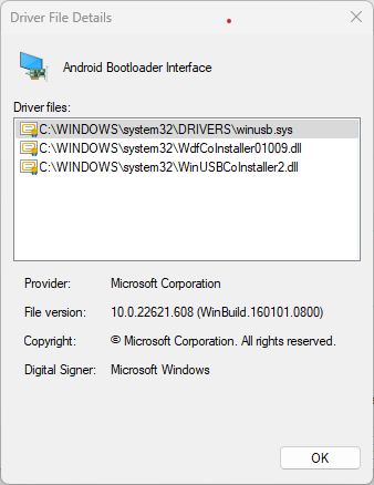

I tried to connect to my phone using a laptop and despite tiredness this has worked.
PS C:\adb> fastboot devices
???????????? fastboot
PS C:\adb>
Can someone confirm this non numeric response is a valid reply.
Today back on my PC I forced the "driver installer" to accept a google driver for USB.
This produced the same response as the above.

Think you need to install drivers for your phone as well.
Did this a long time back and I'm running blank.
PS C:\adb>
Facet never post when you are tired.
Do I just have to run this File? (windows_fastboot_first_install_with_data_format.bat).
Sent from my M2102K1G
I ran windows_fastboot_first_install_with_data_format.bat and received this respponse:-
Waiting for device...
Compatible devices: thor
Your device: K80HD_BSP_FWV_512M
Press any key to continue . . .
Pressing return closes the cmd window.
