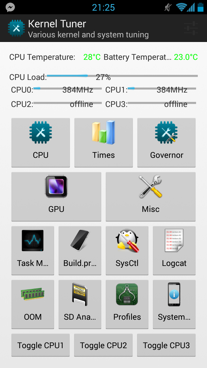

Huarray! Enemy killed...until you turn your screen off..then it will resurrect..this setting wont stick, so you cant turn off 2 cores of 4, BUT, now you can set your desidered cpu frequencies and governor for each core, and this will stick (Es: 2 cores 384/1.7 ghz ondemand, and 2 cores to 384/384mhz powersave)!
For cpu settings i suggest Kernel Tuner, that can set freq\governor for each core.
EDIT:
With the new method for disable mpdecison, you can set your preferred numbers of cores on just with kernel tuner.

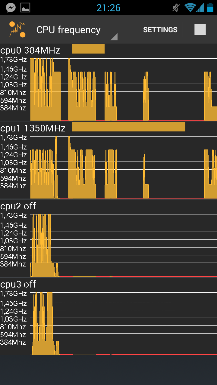

After reboot, usemon claims that cpu2 and cpu 3 are indeed off.

Usemon:
