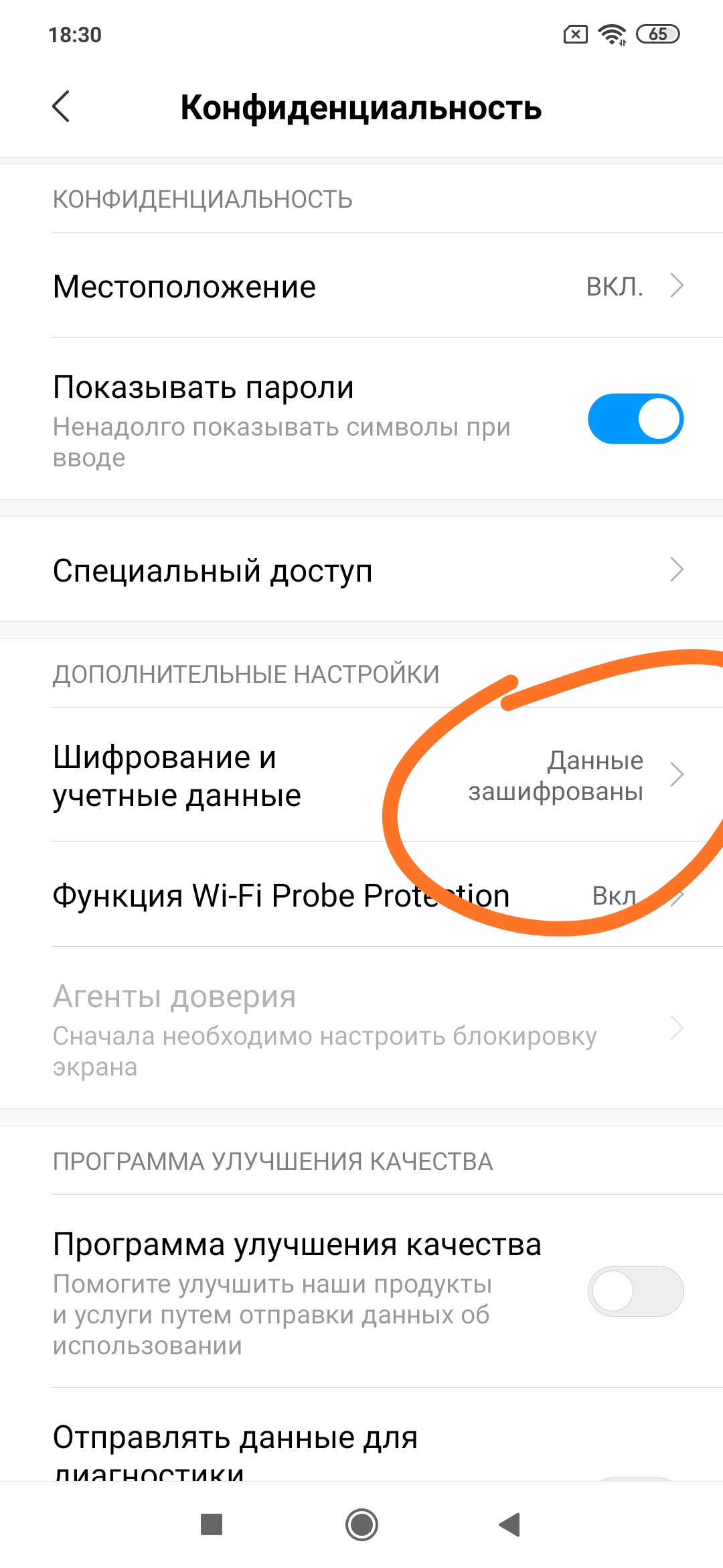

Please tell me, how to disable encryption DATA partition on my Mi9se?
I tried to format DATA partition in TWRP, but after installing firmware, DATA is again encrypted.
TWRP: TWRP-3.3.0-0421-XIAOMI9SE-CN-wzsx150
