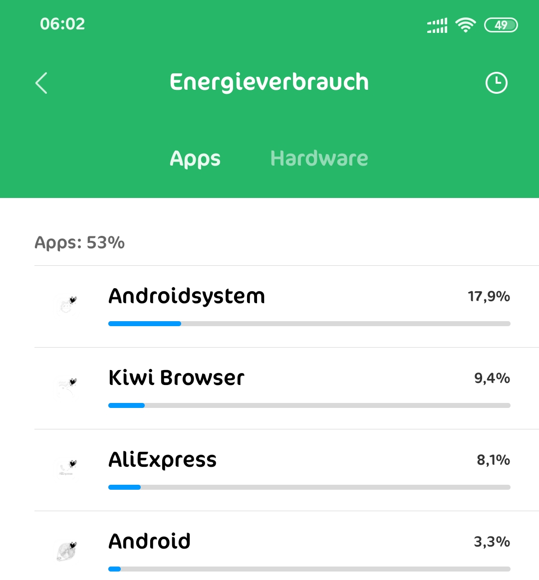

Mi 8 high battery drain Android system in 9.4.26. At 9.4.25 it was only 8%.

Did you have battery issues / androd system drain with the last couple releases ?
Yes, I had severe problems in the beginning of April.
So I tried a re-installation.
In TWRP I formatted manually cache/dalvik and system partition before flashing.
And since that drain was ok again.

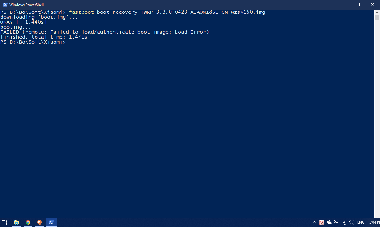

After flash eu rom on Mi 8 SE it doesn't boot to Android, instead it shows fasboot screen
Also I can't boot to twrp using either combination button or using fastboot command
Input:
fastboot boot recovery-TWRP-3.3.0-0423-XIAOMI8SE-CN-wzsx150.img
Output:
FAILED (remote: Failed to load/authenticate boot image: Load Error)

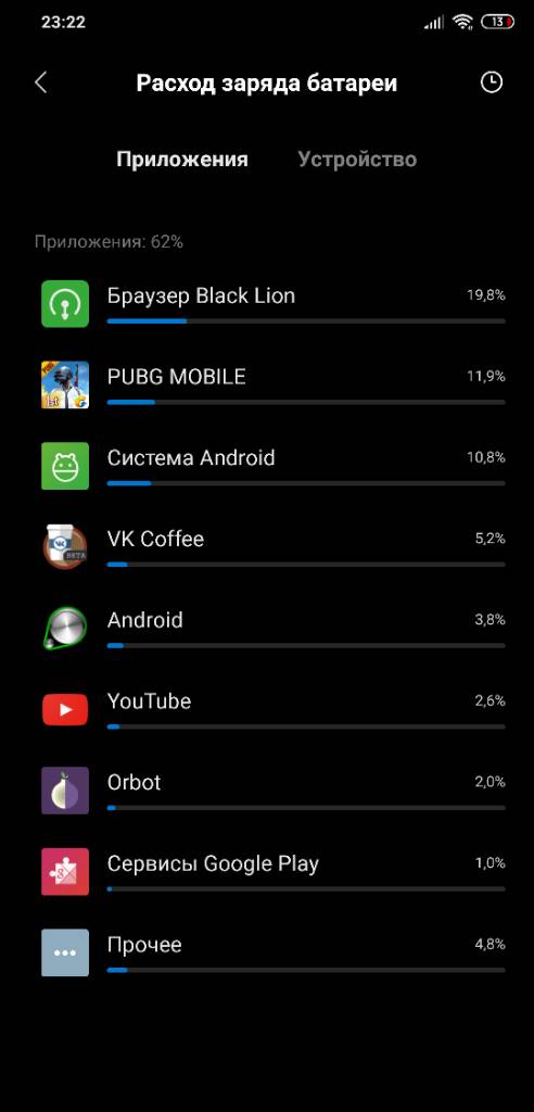

The latest update for MI 8 SE is better than the last the luncher became more responsive and less laggy but not not as smooth as 10.3 plus there is a slight battery drain on MI 8 SE
Same here
Input:
Output:
FAILED (remote: Failed to load/authenticate boot image: Load Error)View attachment 24508
Try to use this TWRP-Batch-file from trading shenzen, if your device won´t work: https://***************.com/de/cont...sh-tutorial-global-firmware-xiaomieu-firmware
All needed files are inside the download and after 1st start of TWRP you must change the language in english, if you don´t speak chinese. I flashed directly successful and use this twrp since then. No problems at all. Fot the stars write trading shenzen without space between the words, maybe the name is deleted by the forum rules or ads.
Input:
Output:
I flash the zip file from TWRP on Mİ 8 SE. The operation was successful. 3.3.0 updated.
