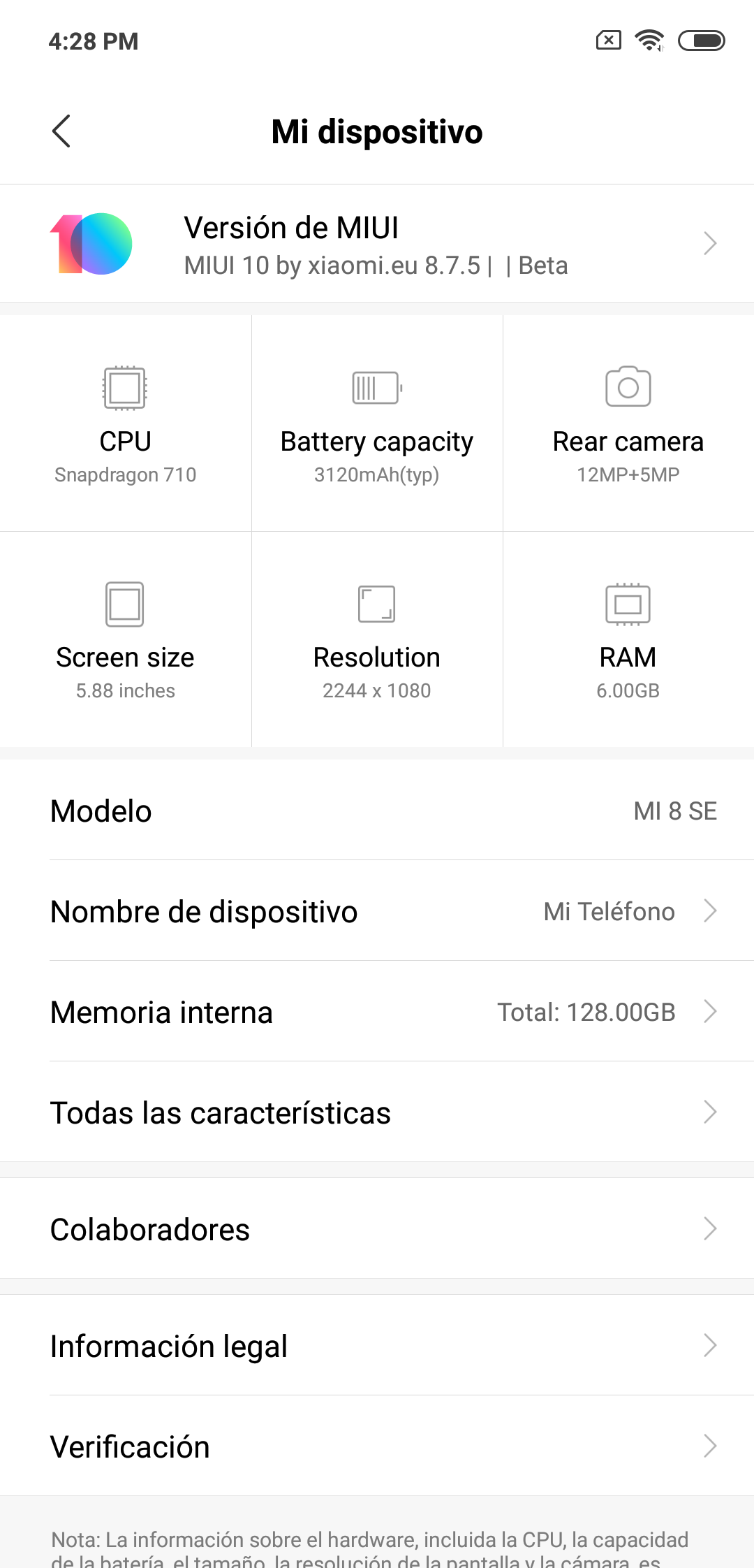

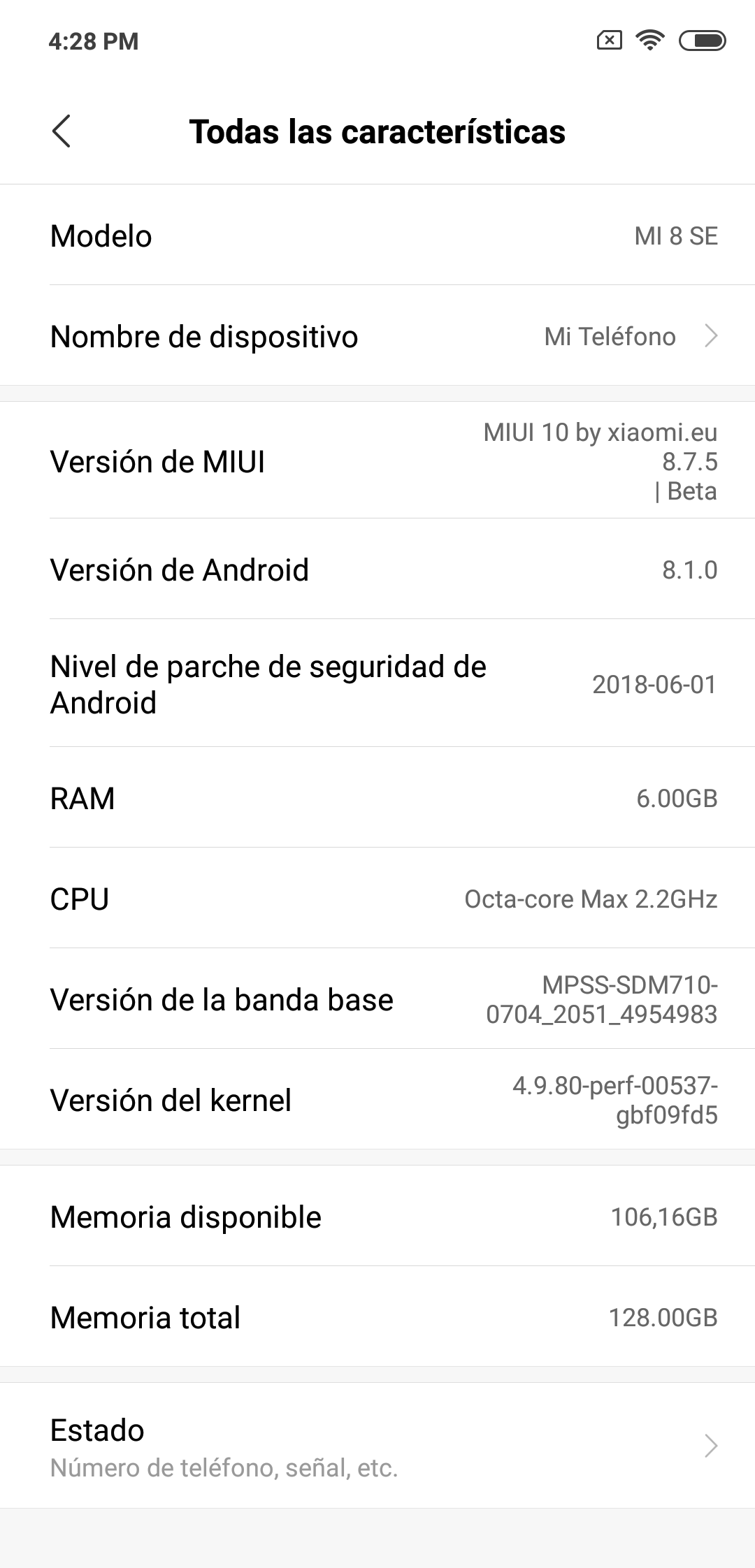

I think you're wrong
As I understand, xioami.eu's ROM doesn't touch recovery partition
Seems like you understand something wrong, send screenshot on information of your device
ok look

Xiaomi.eu is updated by OTA too, just from other recovery
These ROM's in my opinion rather better than official
You have official recovery, I think you used command "fastboot boot *.img" instead "fastboot flash recovery *.img",you should use second command and TWRP won't go anywhere

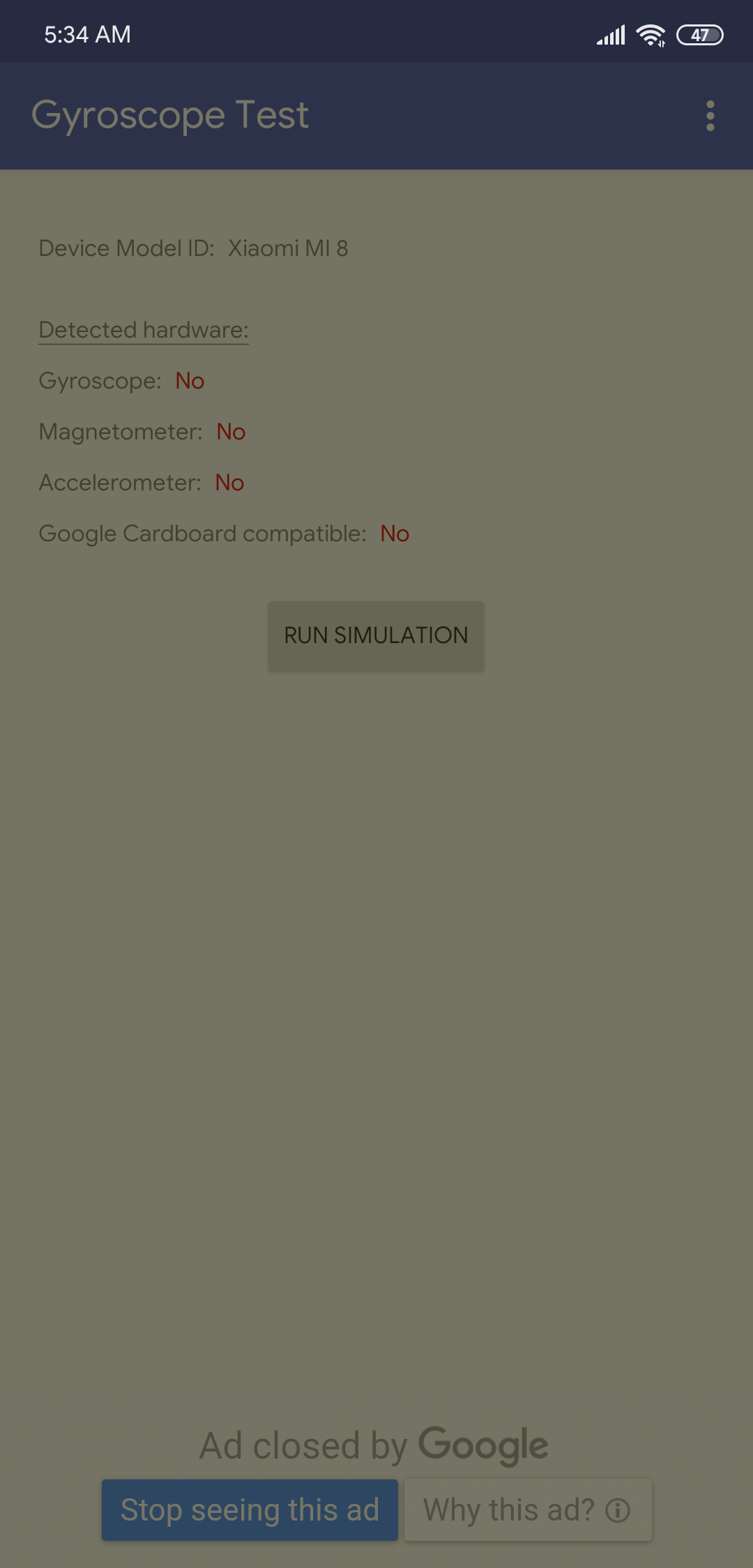

I think you have specifical problem
I has workable gyroscope at least in PUBG
So how i can fix it?
  • Screenshot_2019-04-28-05-34-02-911_com.blogspot.novalabsandroid.gyroscopetest.png
