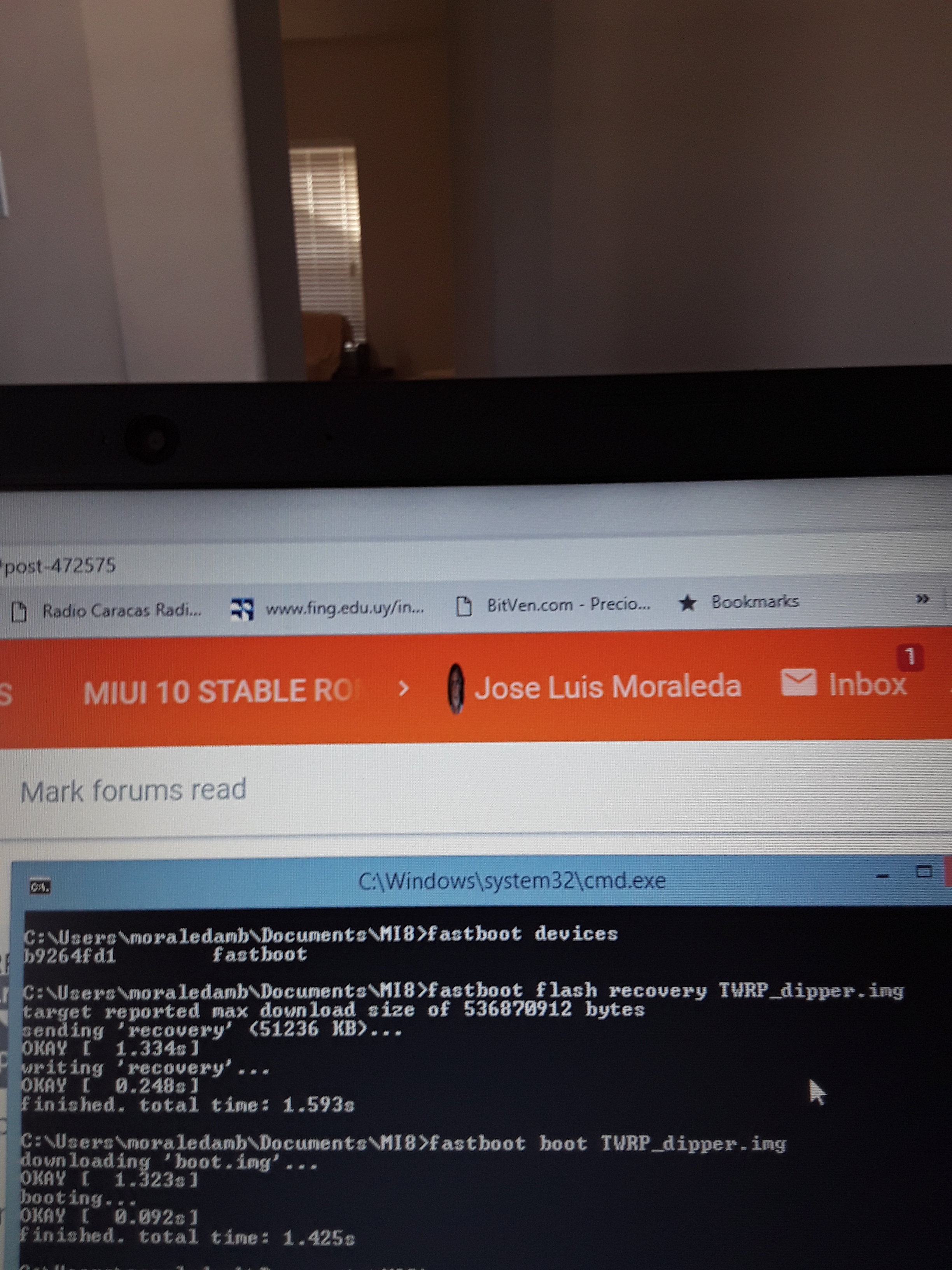

Just to make sure you followed all needed steps, phone in bootloader mode, then
Code:
fastboot devices
showed a line with your phone's serial number then:
Code:
fastboot flash recovery TWRP_dipper.img
fastboot boot TWRP_dipper.img
When the booted TWRP is ready, tap REBOOT > Recovery
It will load TWRP again if installation was successful
- Tapatalked from my Mi Max 3 -
I followed your instructions , but still not loading TWRP:
The antivirus is disabled. Some fellows ask if I perform data wipe, but I understand that this has to be done with the TWRP recovery already installed.
Greetings.

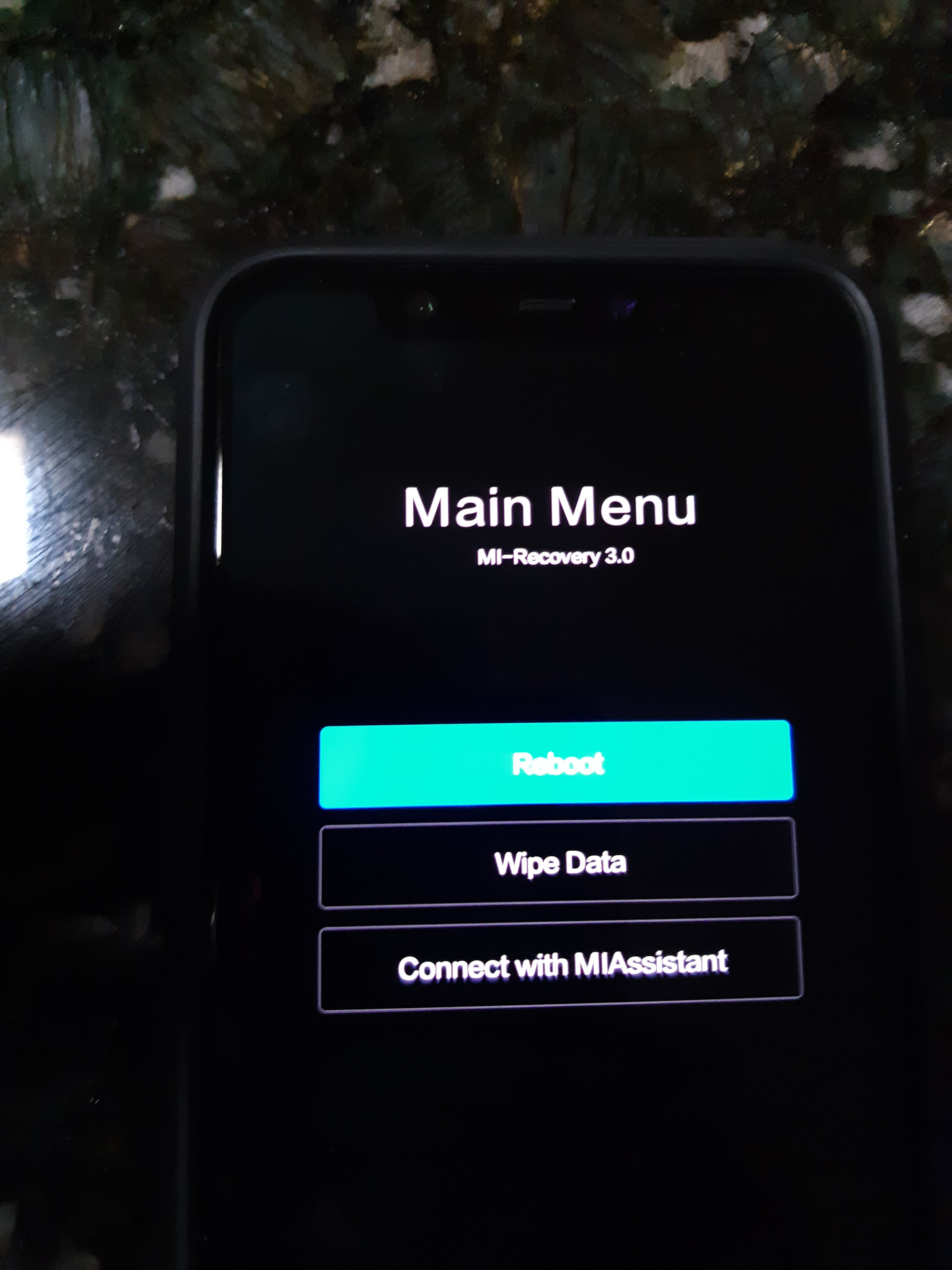

Ok graw2 .I downloaded the latest unlock tool you had sent and I can unlock the bootloader. Then download the TWRP_dipper and install it via adb using the commands:
fastboot boot TRWP_dipper.img
During the process there was no error message and when I finish and restart to see the result in recovery mode and shows this:
By the image I can understand that TWRP_dipper.img was not installed. What may have happened here?.
Did you use Official TWRP recovery by TeamWin?

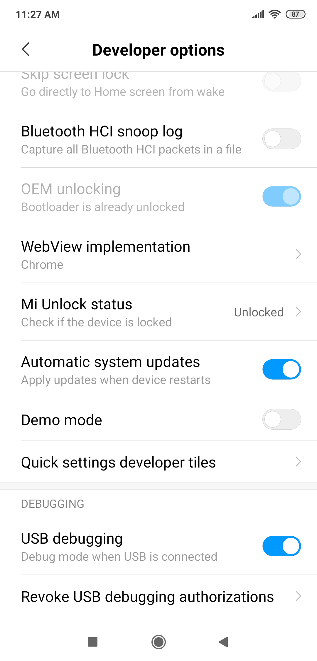

I don't own a Mi8 but as far as I know, when TWRP is not even booting from fastboot command, it's because bootloader is still locked...
Do you see the "Unlocked" mark at the bottom of your screen when switching on or rebooting your phone?
I mean this one below the red arrow:
Yes, this can be done from inside TWRP only so it's not your case for now
