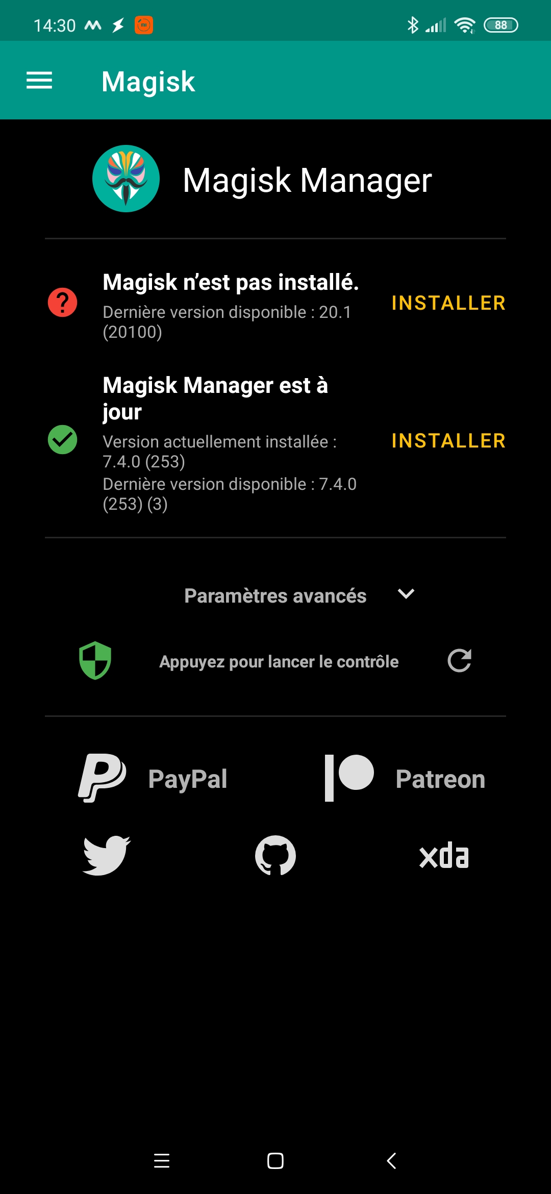

I do not do anything special, after installing magisk, for a few days it goes well, then I see myself, he is no longer install

It never does for me either. What I do is keep a local copy of the latest Magisk and just re-flash it after each ROM update.
I had the same problem and I fixed it.
i will try to explain it as good as possible.
From twrp you will enter and first put on sd the rom, magisk.zip, magisk manager,and magisk uninstaller.
You enter twrp first install the magisk uninstaller after reboot to recovery. Then wipe dalvic cache, cache, and system.
Then go to mount and tik everything.
Go into the file manager and look in the root for anything related to magisk.
Check every folder one by one the folders for anything related again with magisk or topjohnwu name file and delete it.
After deleting everything you re-wipe and reboot to recovery.
Then you install Rom and start without magisk.
After booting first time then you will install magisk and magisk manager and it will all be ok.
Don't worry you will not lose any of your data.

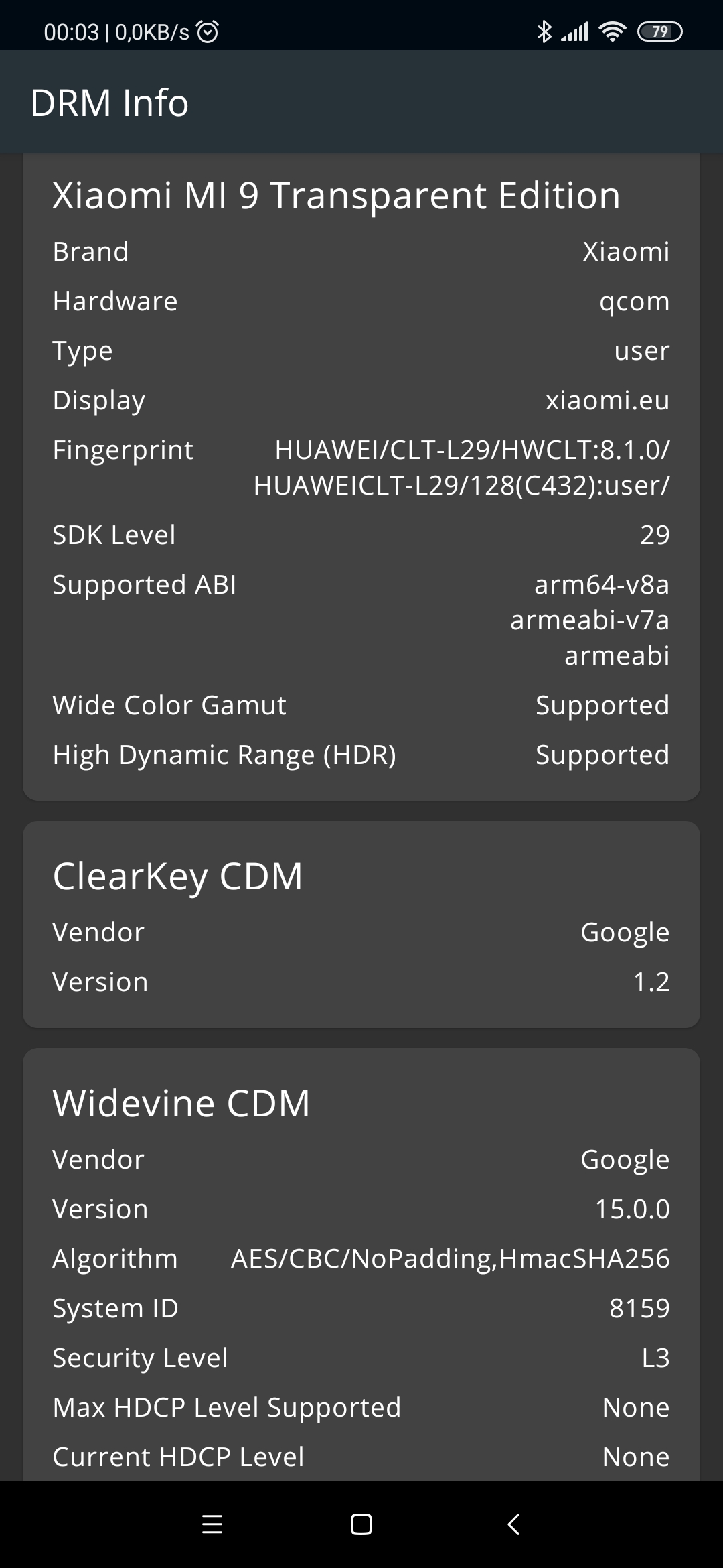

My Chinese Mi9 Transparent Edition is still on Widevine L3 in fact as far as I have checked it has always been on L3. DRM Info tells me fingerprint is Huawei CLT-L29 ?? Can I push it to Widevine L1 ? Is this fingerprint OK ??
