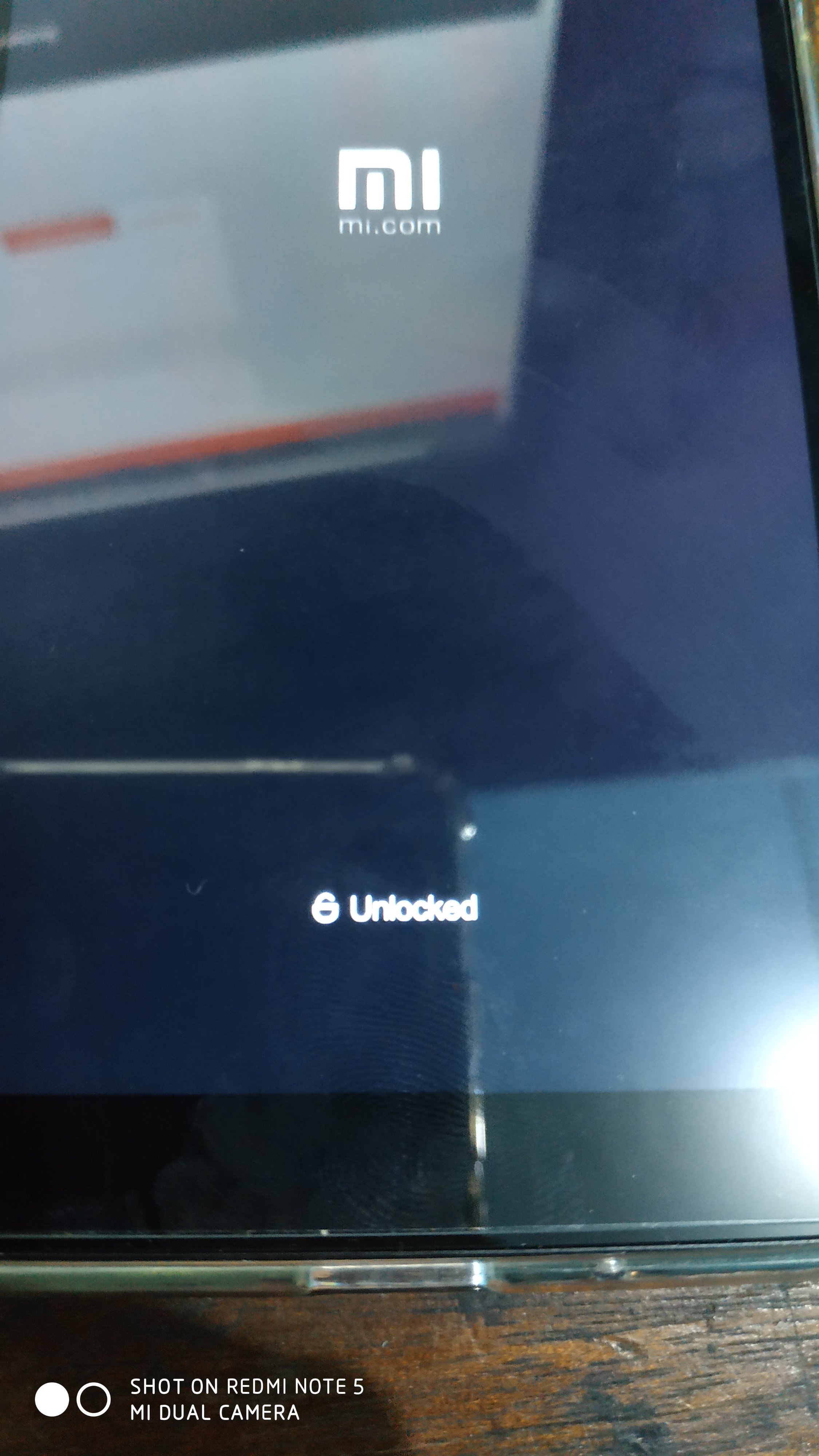

After updating to the latest build of my MI 8 SE , the recovery isn't working anymore.
It stays at the MI (unlocked) logo forever, even after I've flashed it again using "fastboot flash recovery recoveryMI8SEandroid9.img"
Yes, the recovery was already the updated one for android 9, I was using android 9 already just fine and the recovery used to work until this latest update.
Any help would be appreciated.

Then I press power + up or typing "fastboot boot recovery recoveryMI8SEandroid9.img" and it stays stuck at the mi logo

What rom are you now?
install twrp1217 flash rom 8.12.27 (https://drive.google.com/file/d/1U_D0-N0Tf0cRMuuD0eCEWsXi28L_29H8/view)
after that install twrp 1227 (https://drive.google.com/file/d/1CKDNVE9Wm68T1UwToVY6Q6XC2bzFn3o-/view) it should work
and then install rom 9.1.3
it should be ok
I always clean and format data before installing new rom.
I've tried this and I was able to boot in the recovery.. thanks!

So your device shows the Unlocked mark on boot screen?
I supposed that because your getting the tipical locked BL behaviour
As i sad my bootloader is unlocked.

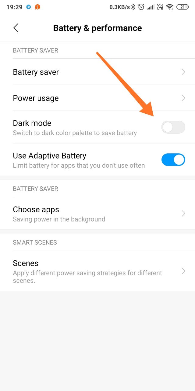

Very much looking forward to an actual Dark mode!
All those "dark mode" MIUI themes got issues...
