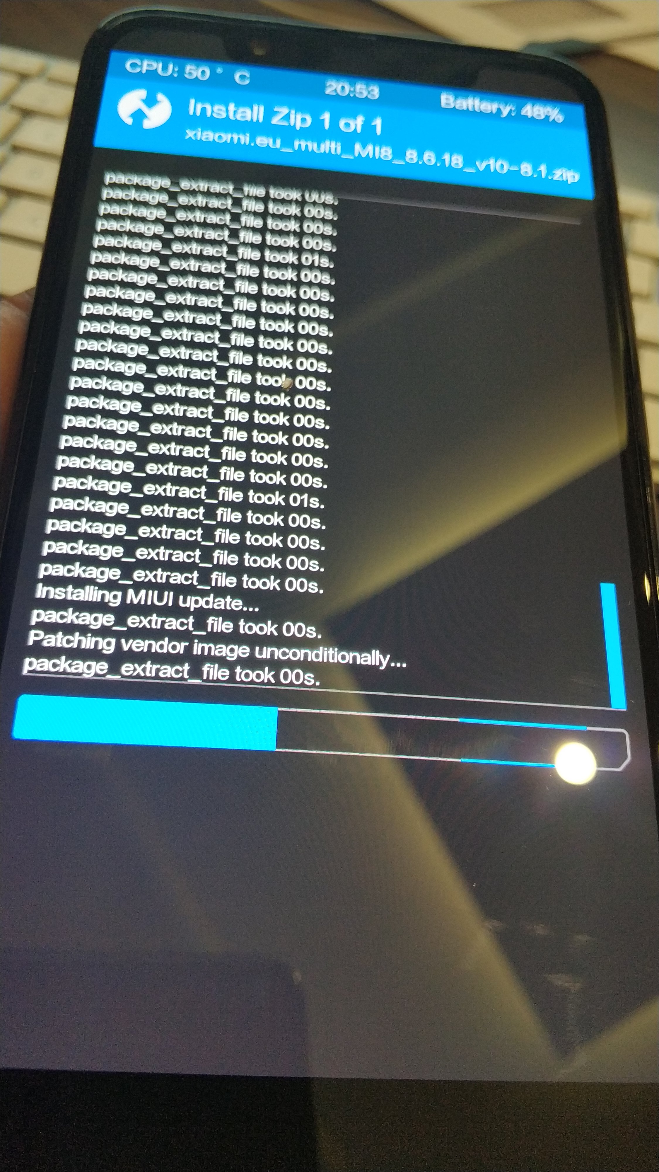

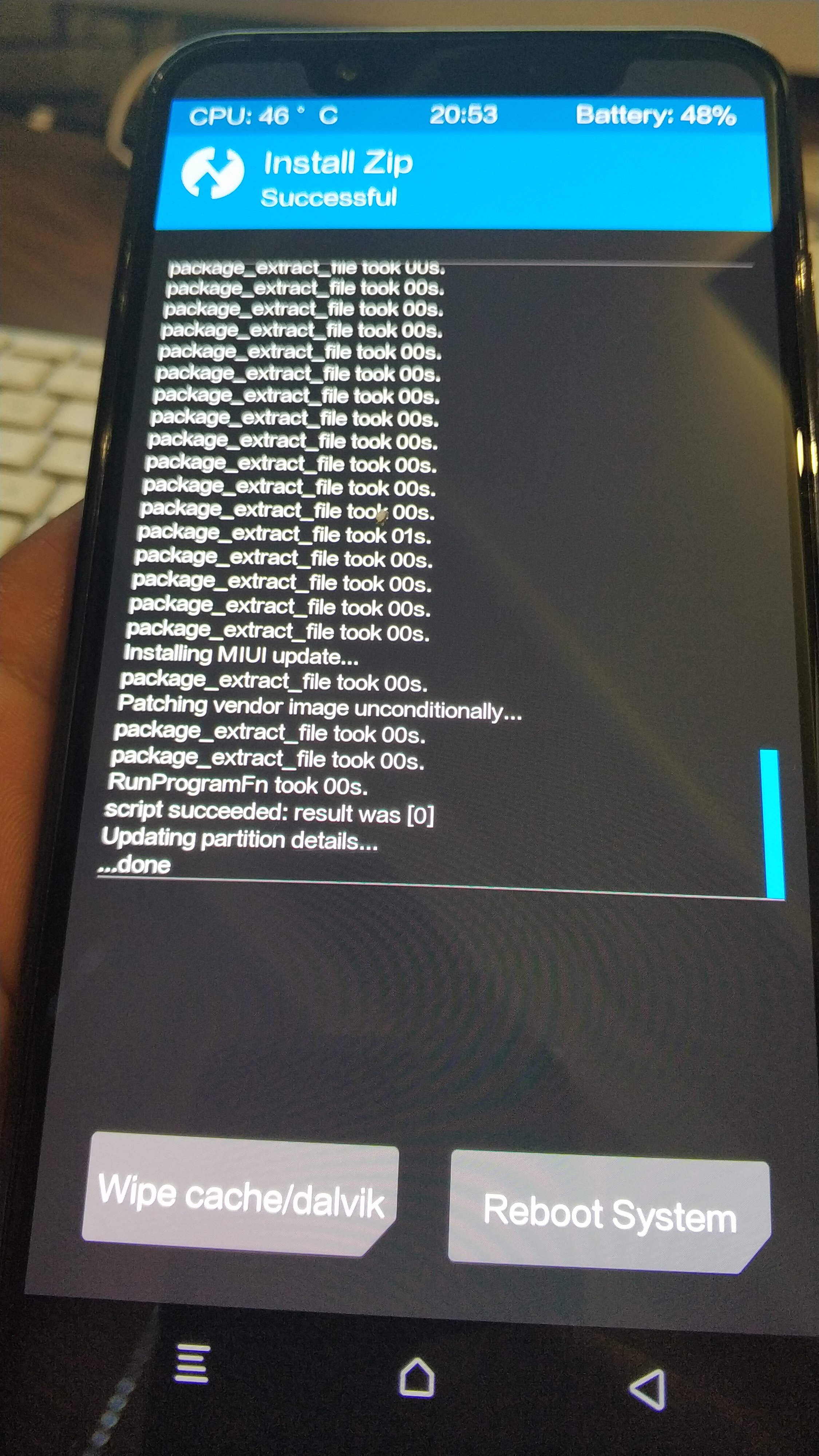

I can not install my mi8.

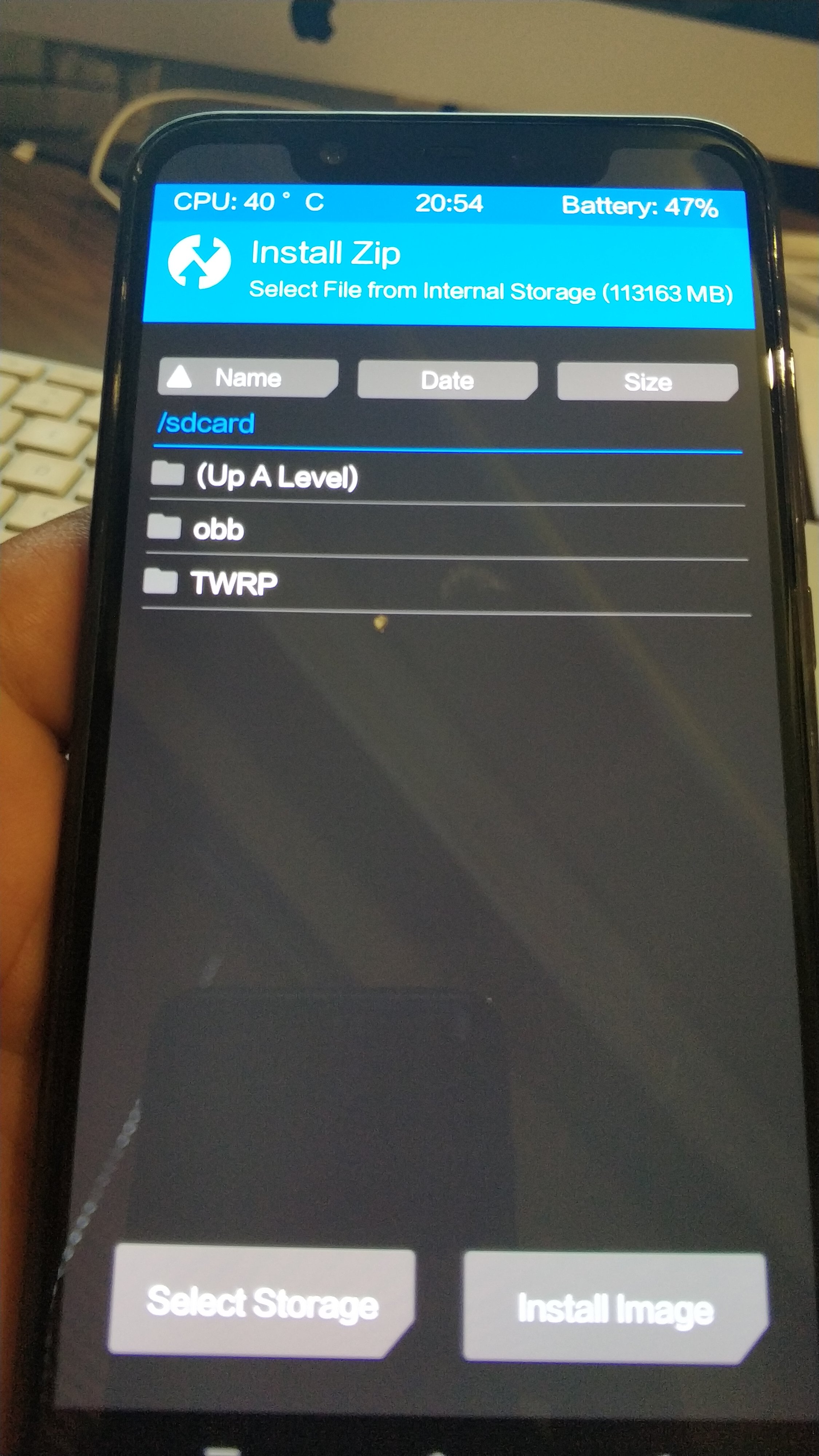

Twrp is ok. install zip. no any error. but only twrp and obb folder in sdcard. no other file or folder.!!
pls help
Have you formated data?
Format all data,factory reset, wipe everything. But not solved.

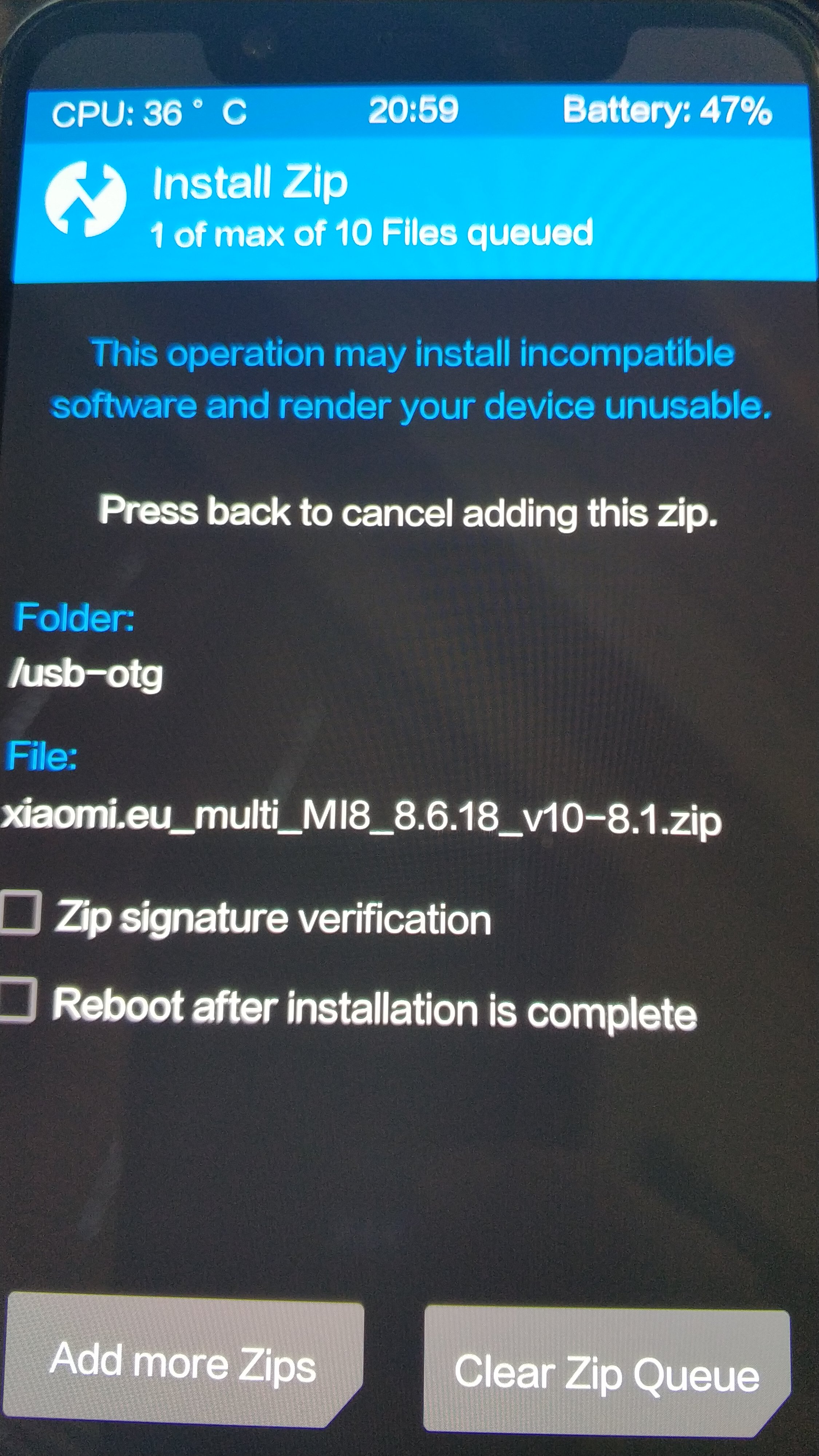

What is mean "this operation may install incompatible software and render your device unuaable" ??
If you already installed it, just reboot?

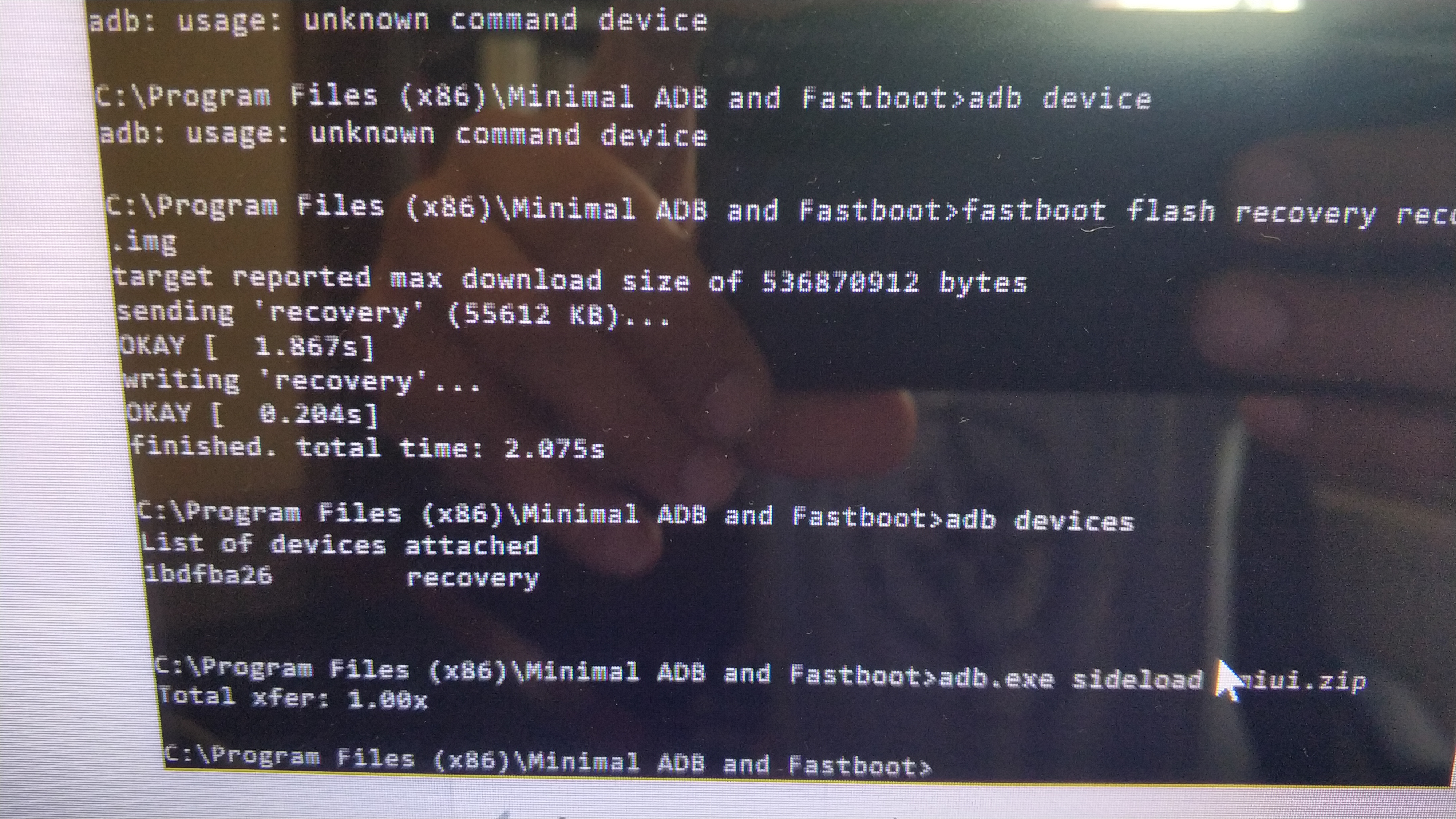

Otherwise: You can use "adb sideload" via commandline, to install a zip that is not on your phones storage. Simply go to TWRP -> advanced -> adb sideload
then open a commandline window on your PC and type "adb devices", this should list your phone if adb is running correctly. Then you can type "adb sideload yourMIUI10.zip"
If the adb PATH variable is not set correctly in Windows, you can go to the location of adb.exe and open a commandline window here. type ".\adb.exe sideload yourMIUI10.zip"

I tried to install from usb. and also tried copy the zip file from usb to internal storage. and then install it but any file or folder in the sdcard
Did the installation via adb sideload work? I installed it that way on my mi6
