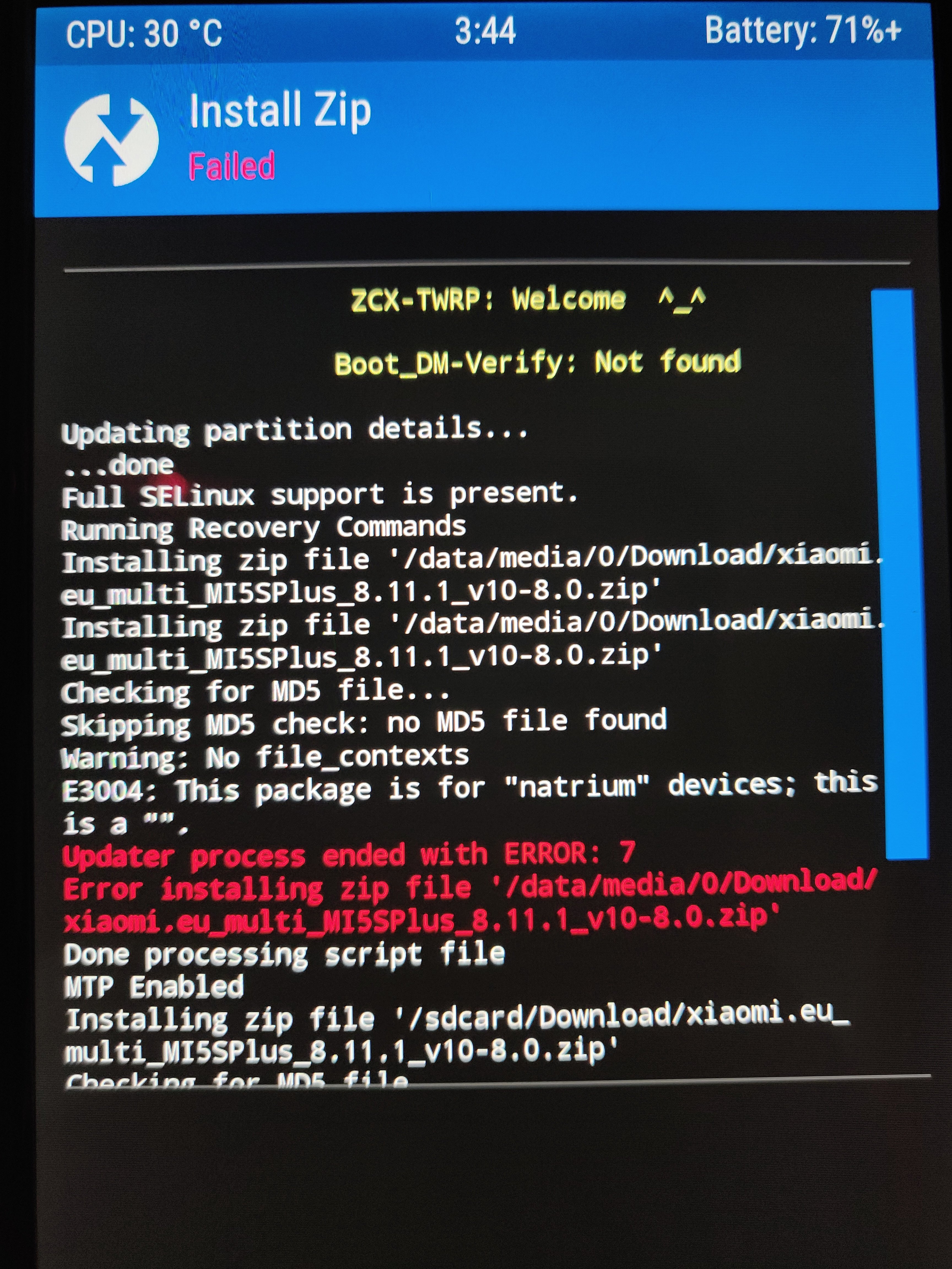

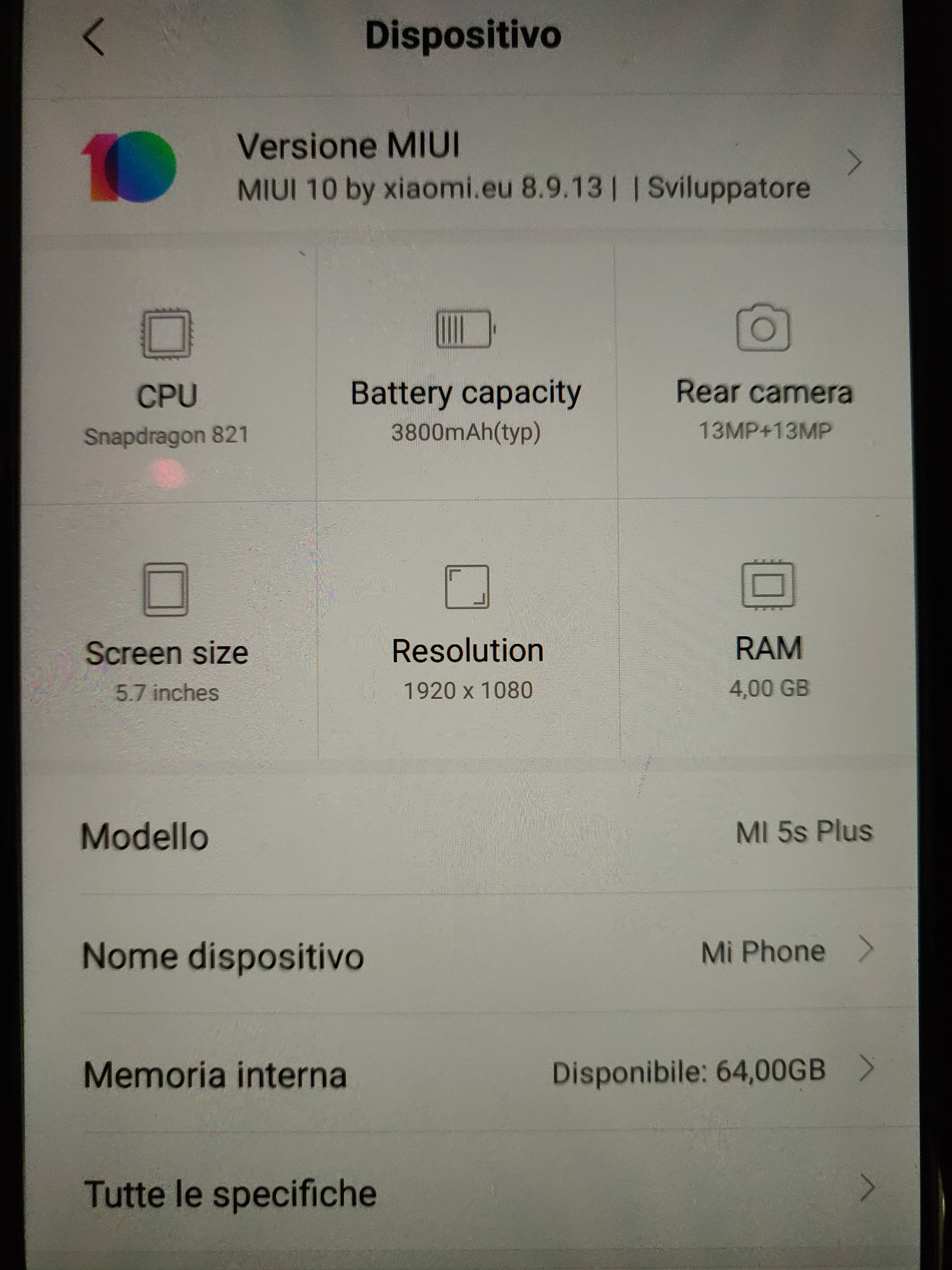

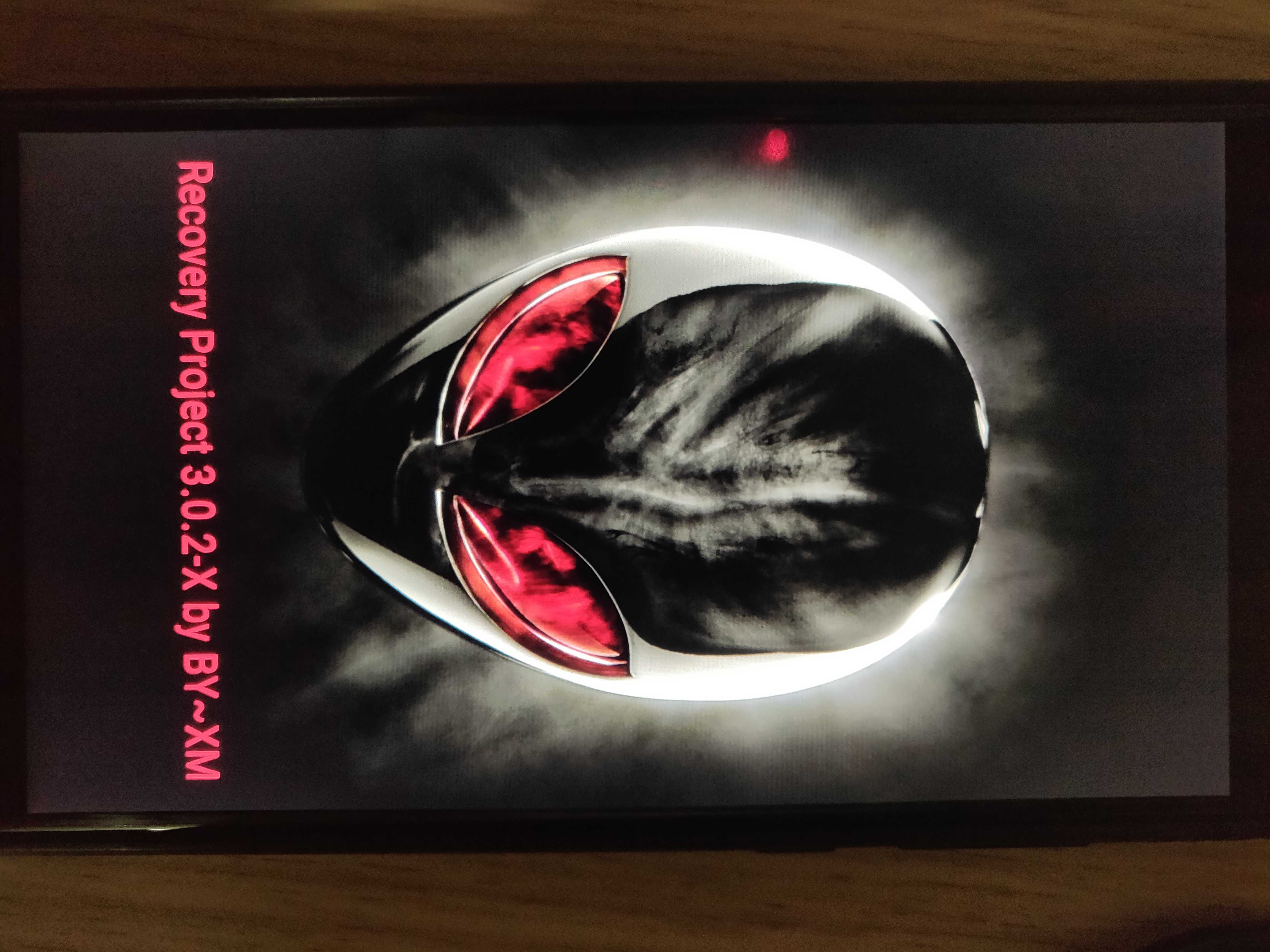

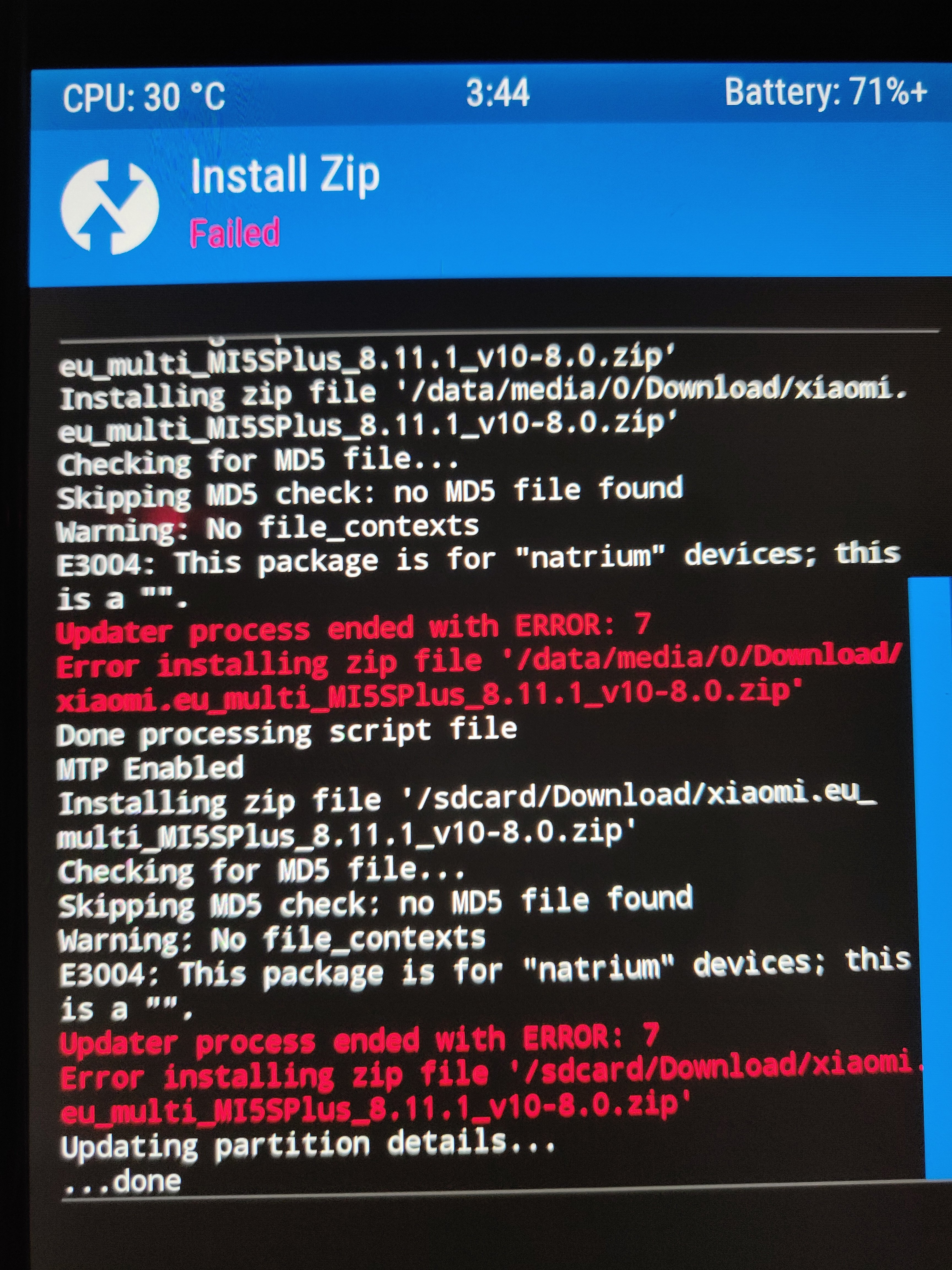

I can't update my mi5splus anymore...I tried to flash the weekly rom using both twrp and the update app but the result is the same...It returns an error saying that the rom is for natrium anche my phone is ""...looks like the phone model is not recognized....cancellare someone help me please? Maybe is the update from Android 7 to 8.0 version? I attach the screenshots...
