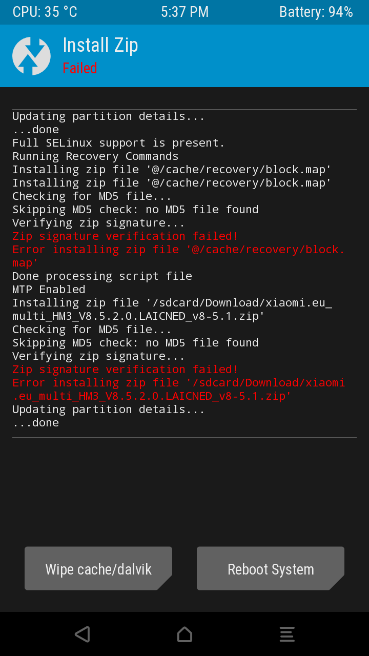

I have tried to install stable for my redmi 3 (file:
xiaomi.eu_multi_HM3_V8.5.2.0.LAICNED_v8-5.1.zip
) but i got a zip verification error upon flashing in TWRP
Please see enclosed screenshot
un-tick zip file signature verification >> swipe >> try again
Isn't that unsafe as this verification is to control the integrity of the file?
No! The Firmware zips are not signed.
If you are Worried about the integrity of the zip file, you can download it to your PC and do the MD5 verification, then you can install it by sideload.
The file/version you are referring is this: https://www.androidfilehost.com/?fid=817550096634790152
