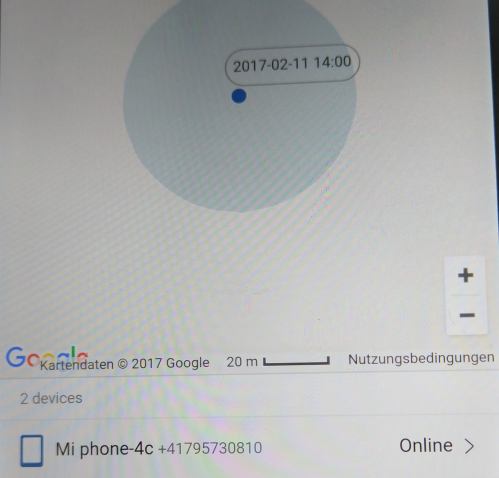

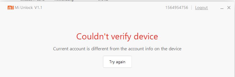

Hi
anyone who can help?
I am not able to unlock bootloader. Maybe I need CN developer ROM.
But also not able to install. In the moment nothing can be installed.
Unlock process stopped at 50% "cannot verify device". But tracking is active on the handy and also in the account.
So what can be done? I have no solution.View attachment 15206 View attachment 15205
Have you switch on usb debugging and oem unlocking at developer options?
Sent from my Mi-4c using Tapatalk
