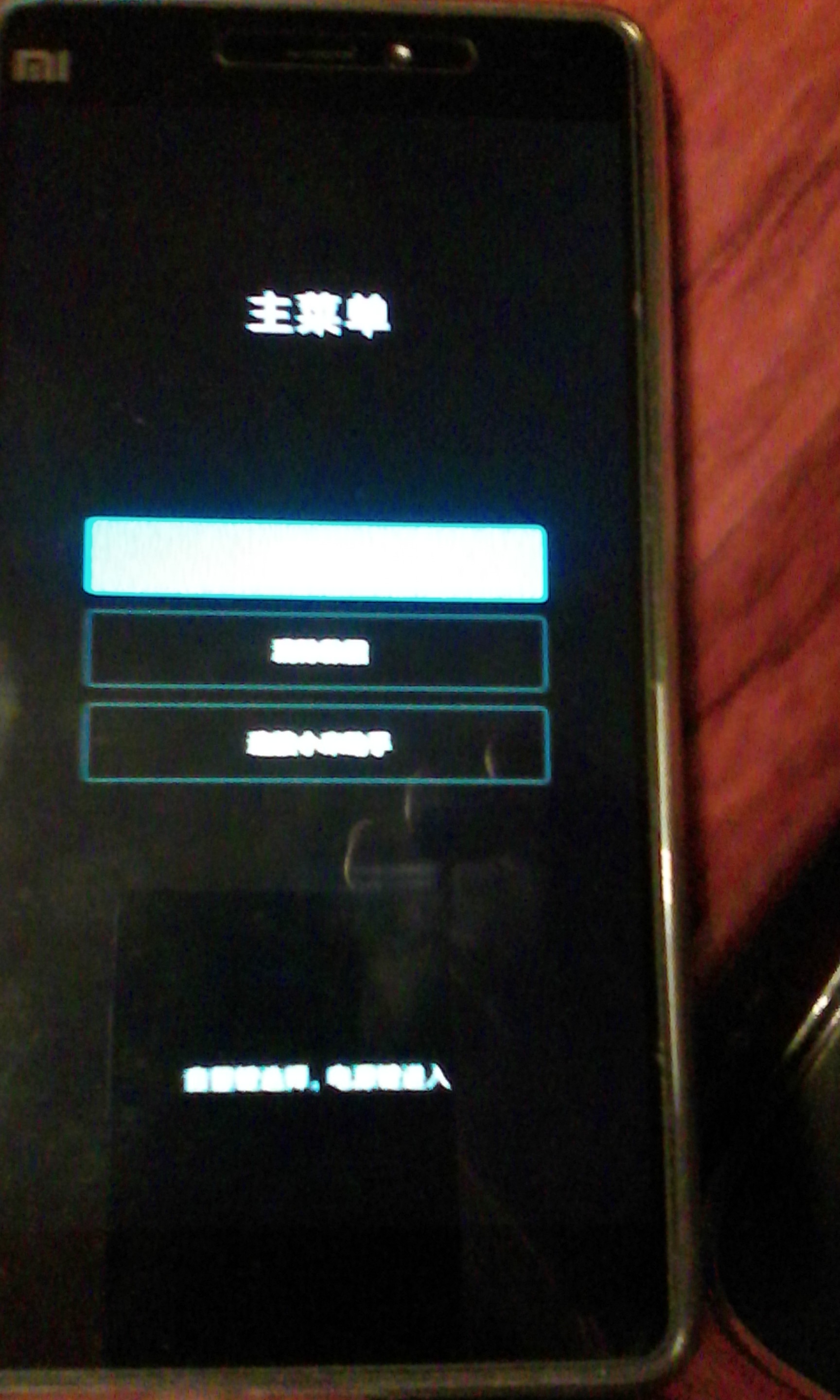

Hi again GuseppiGuliano.
It does not look like the TWRP.
I have tried to put the xiaomi.eu through updater, but will not allow it because they do not validate it.
