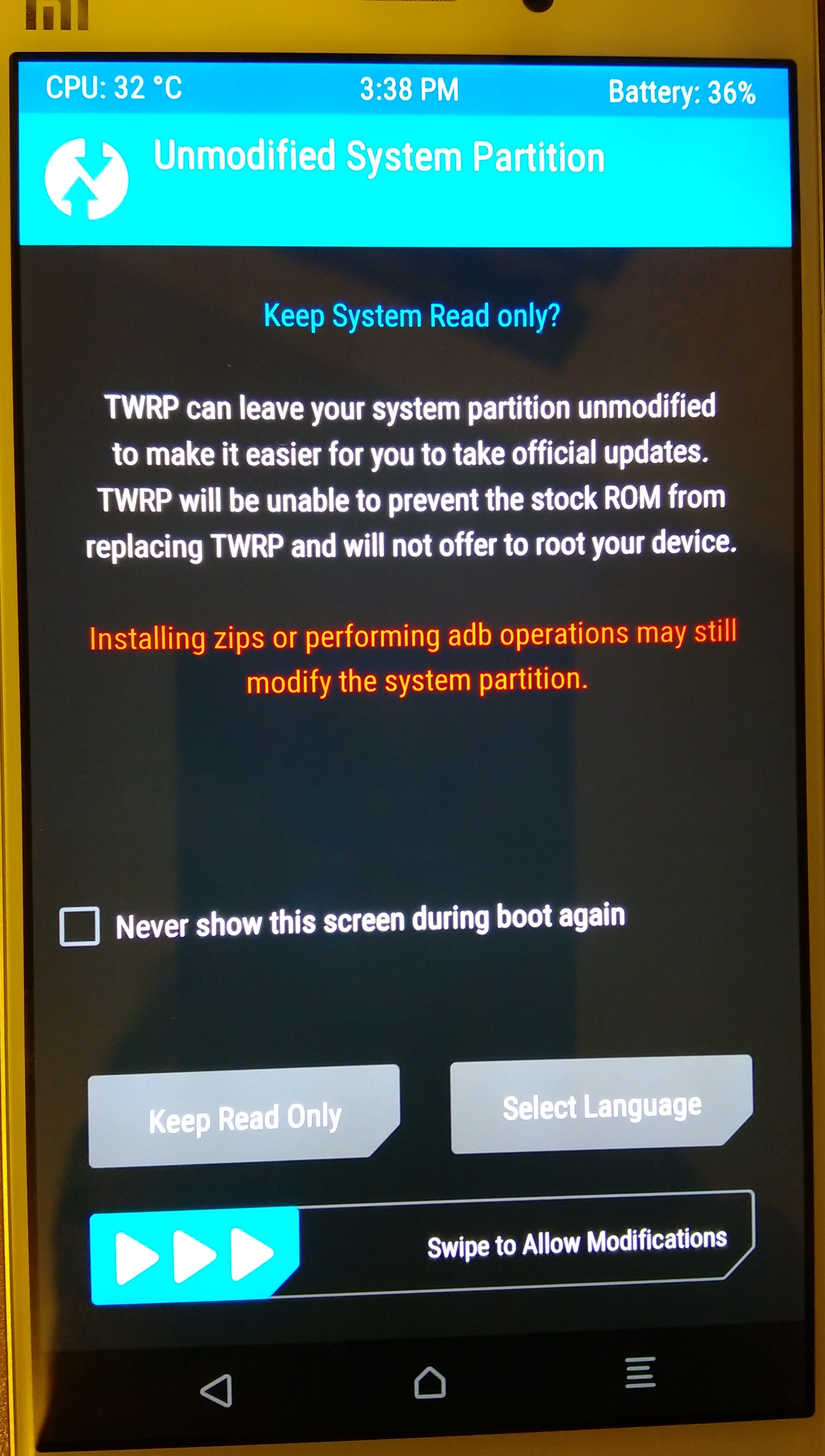

I try to update MiNote Pro (leo) as usually through Updater -> the phone restart in TWRP mode, but the update doesn't start ... what's wrong ? thank you !
TWRP installed by default if version 3.0 and issue = no access to memory phone
you need to reflash TWRP from the first page in fastboot mode with ADB command
I understand, but the update last week (6.3.10/11) worked without problems ... what has changed since then about TWRP?
