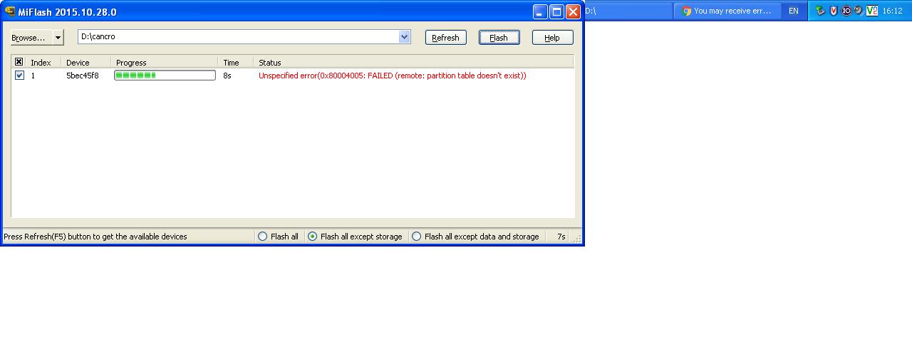

i try to installed global stable ROM with MiFlash in boot recovery mode (after i did wipe data+cache+davlik)
and i get the message in the attached pic
what can i do? please help
