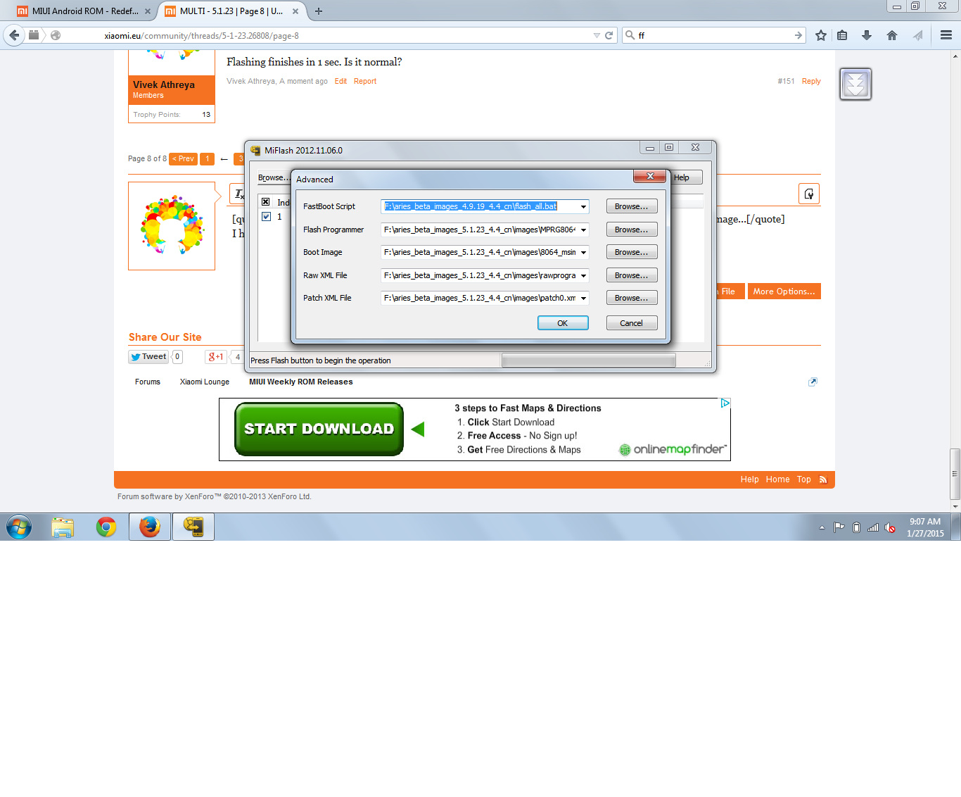

I have tried all the options including flash_all.bat.. But the same result. Flashing finishes in 1 sec.
In the screenshot u can see the settings i used.
Why do you use old version of MiFlash? It does not work with MIUI6. I have already posted MiFlash 20140509 for you...why don't you use that one?
I installed MiFlash given by you. The problem is, my phone doesnt get detected. What other drivers should i install. My phone is Mi 2.
Question:
Did you start the phone in Fastboot mode?
Did you click the refresh button in MiFlash after connected the phone to PC?
I have 64 Bit Windows 8.1 and no need to install any other driver only MiFlash. Must be working perfectly, I have done it many times...

Yes. I did reboot in the fast boot mode. I refreshed it too.
Also, I installed MI phone manager as well. My phone gets detected in phone manager.
My phone gets detected in fastboot mode, when I used an old version of miflash. With the new version given by you, it fails to detect.
Should not be any problem, it has worked at first try for me and I use MiFlash periodically for clean installation without any issues.
I have got MiFlash tool from official en.miui.com, it is the same as I linked for you before:
http://en.miui.com/thread-43681-1-1.html
Otherwise the topic what I linked above is the flashing guide for MIUI6 SE edition for Mi2s. Perhaps it might be useful for you...good luck!
