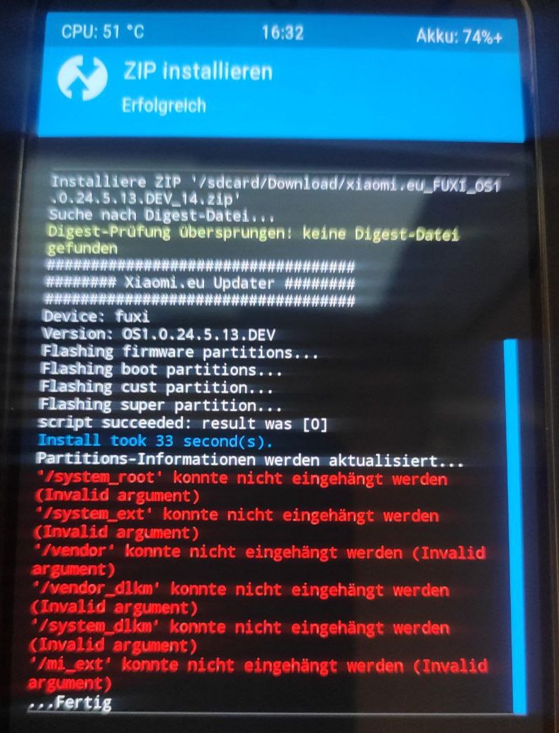

Is it normal in TWRP?
if i flash with fastboot i have bugs like this in this post -> X
However, the ROM seems to boot normally!?

It's normal that on Xiaomi 14 (houji) with every update after flashing the ROM I have to flash the modem because otherwise it doesn't see the network.
I use the fastboot method on my PC because it doesn't work for me via OTG and TWRP
Yes, the other option is to remove the modemfirmware.img from new ROM before flashing it. Then you don't have to flash global modemfirmware.img again.
