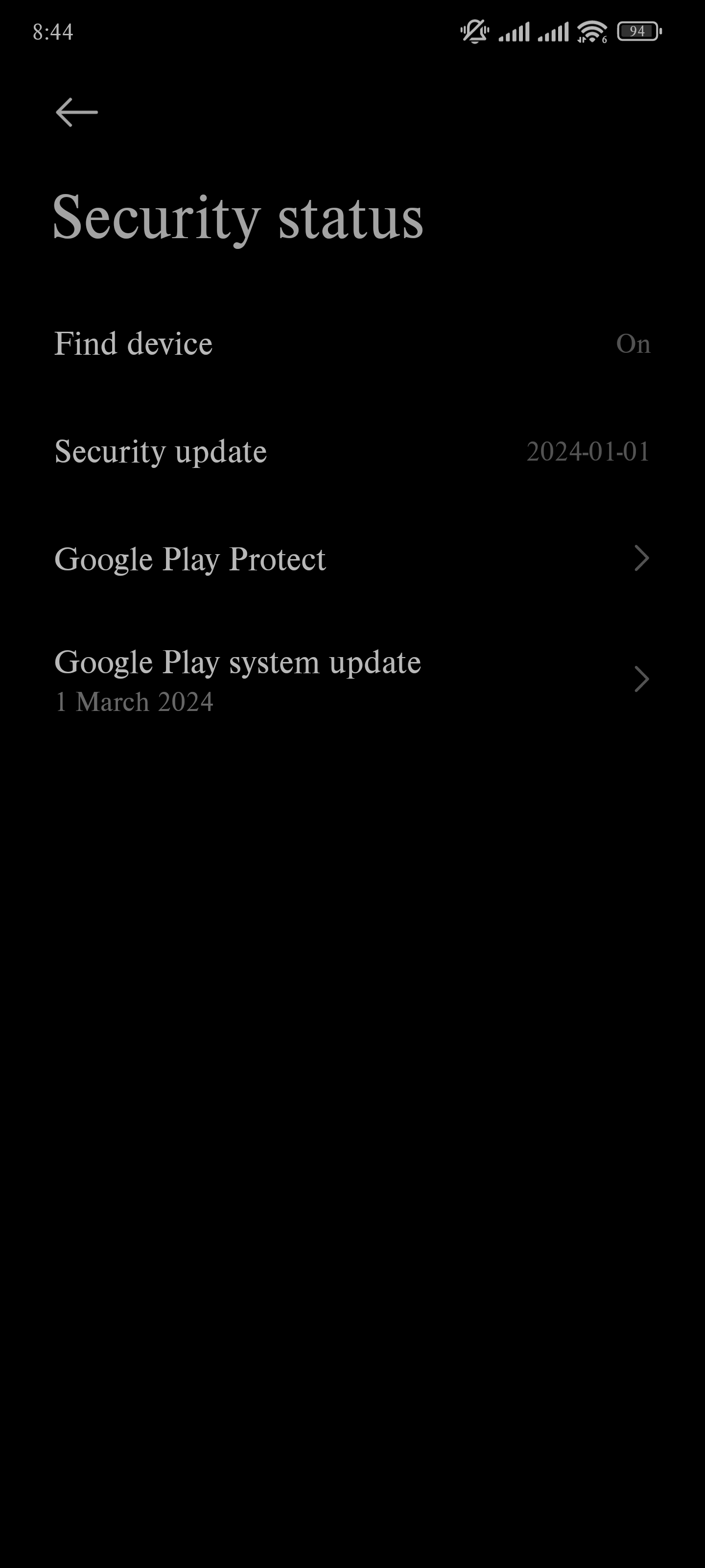

Mondrian (global device) not rooted here. No problems so far. But I just want to verify with other Mondrian users what is their Android Security Patch update date?

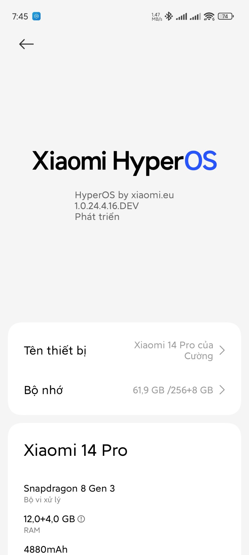

Update ok on Xiaomi 14 pro, everything seem fine, thank devs.

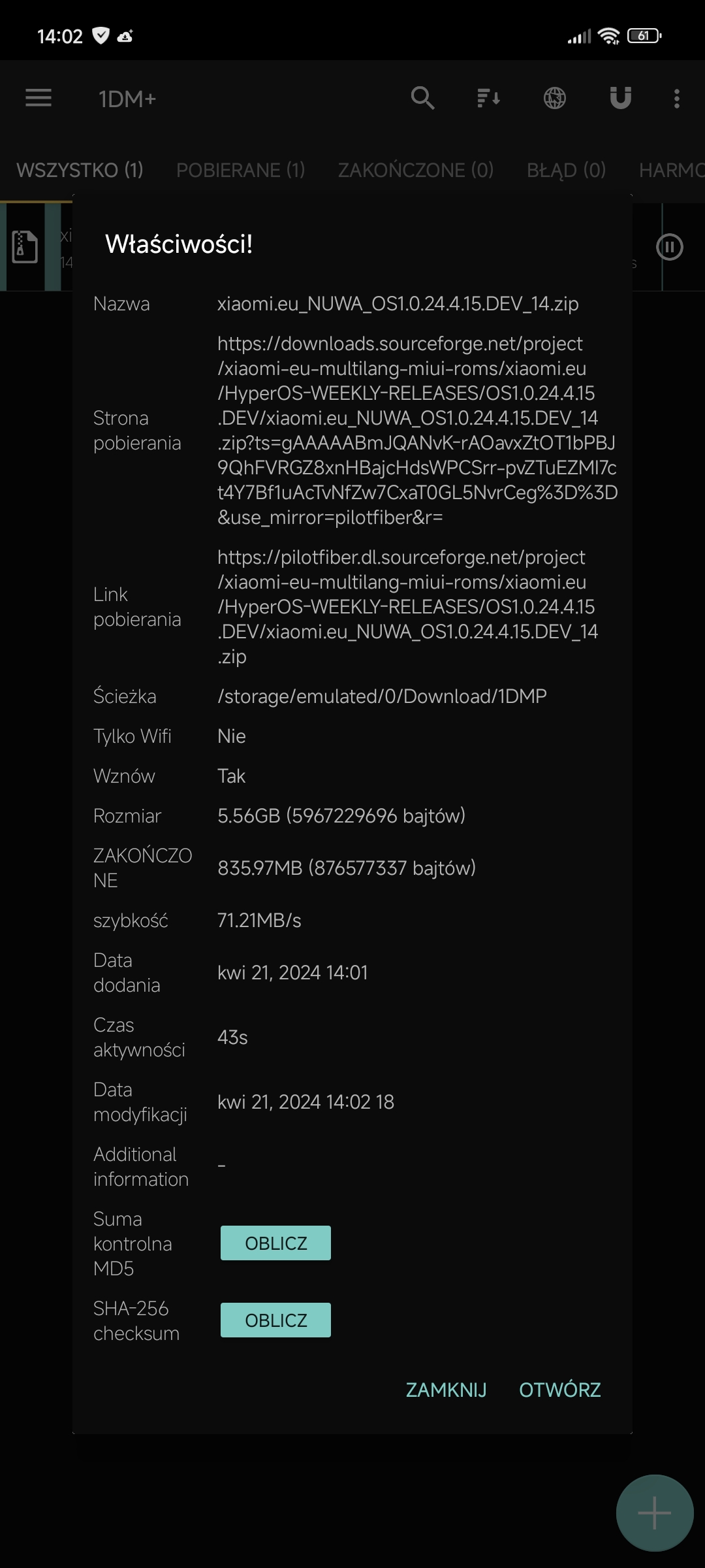

I just wait 1 day and download speed is good.

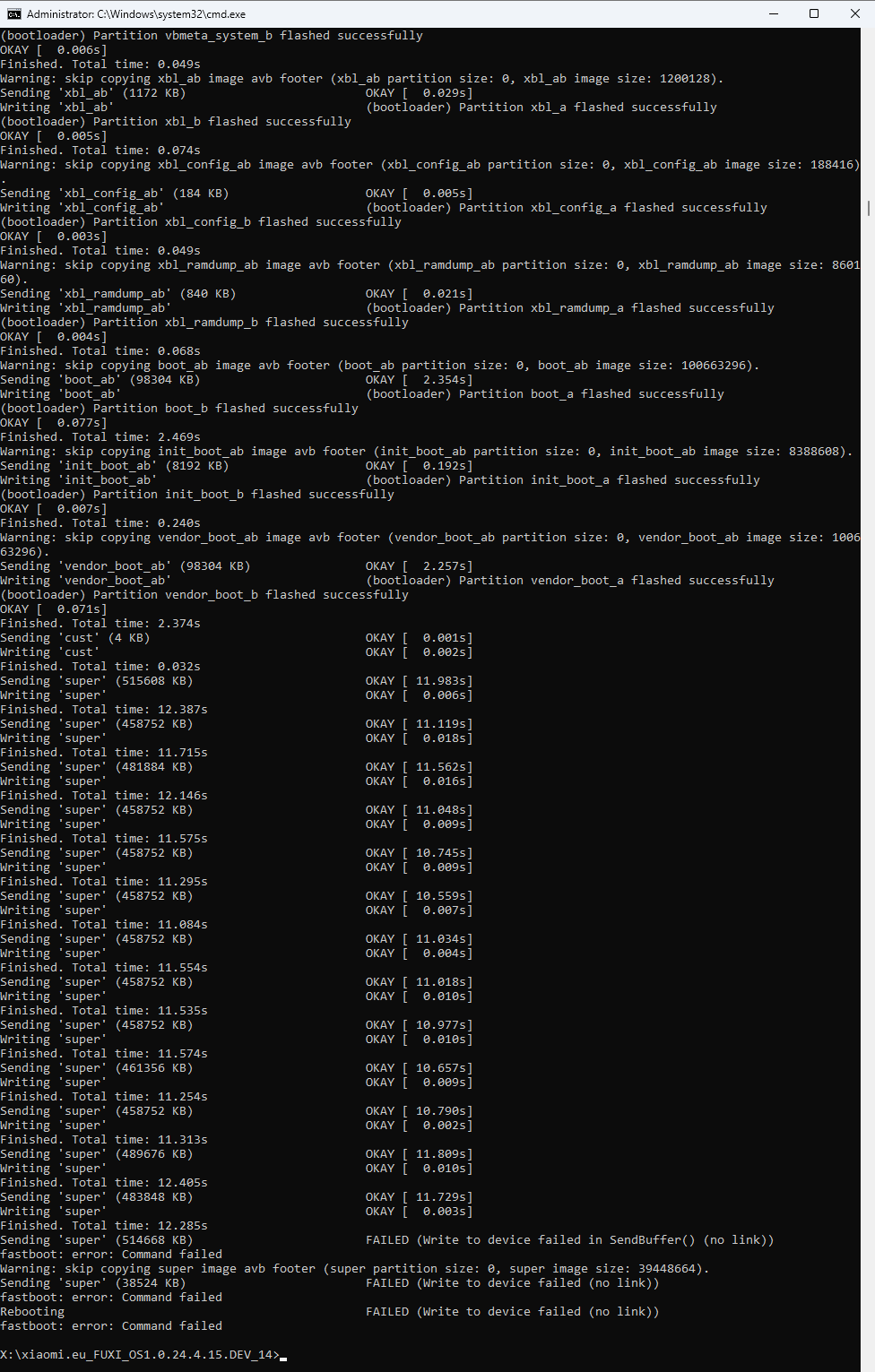

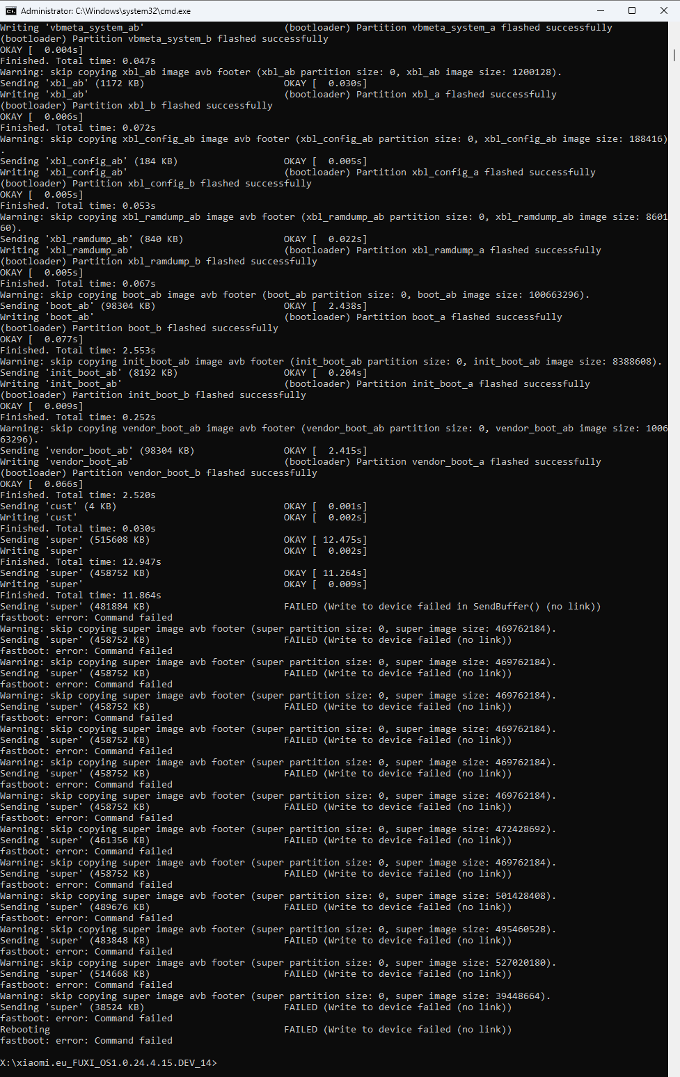

Still the same bug with fastboot update on Fuxi
pic 1 with your bundle fastboot
pic 2 with the fastboot from the google SDK
always the same
