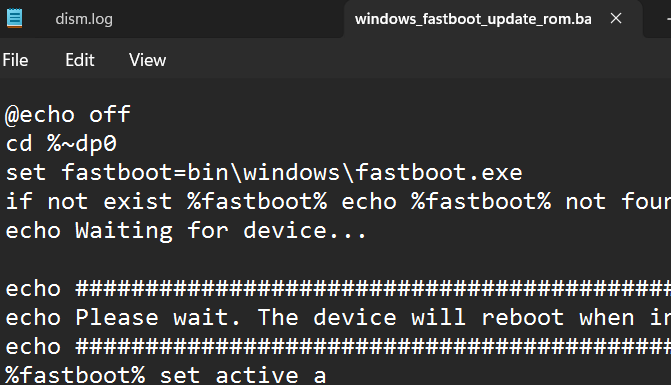

Hello ! @ingbrzy On a friends xm14pro i had to remove the lines of verification for "shennong" in order to install Xiaomi.eu , if i run the script without removing the lines is always failing. Weird problem that i am trying only to understand.. see picture bellow !!

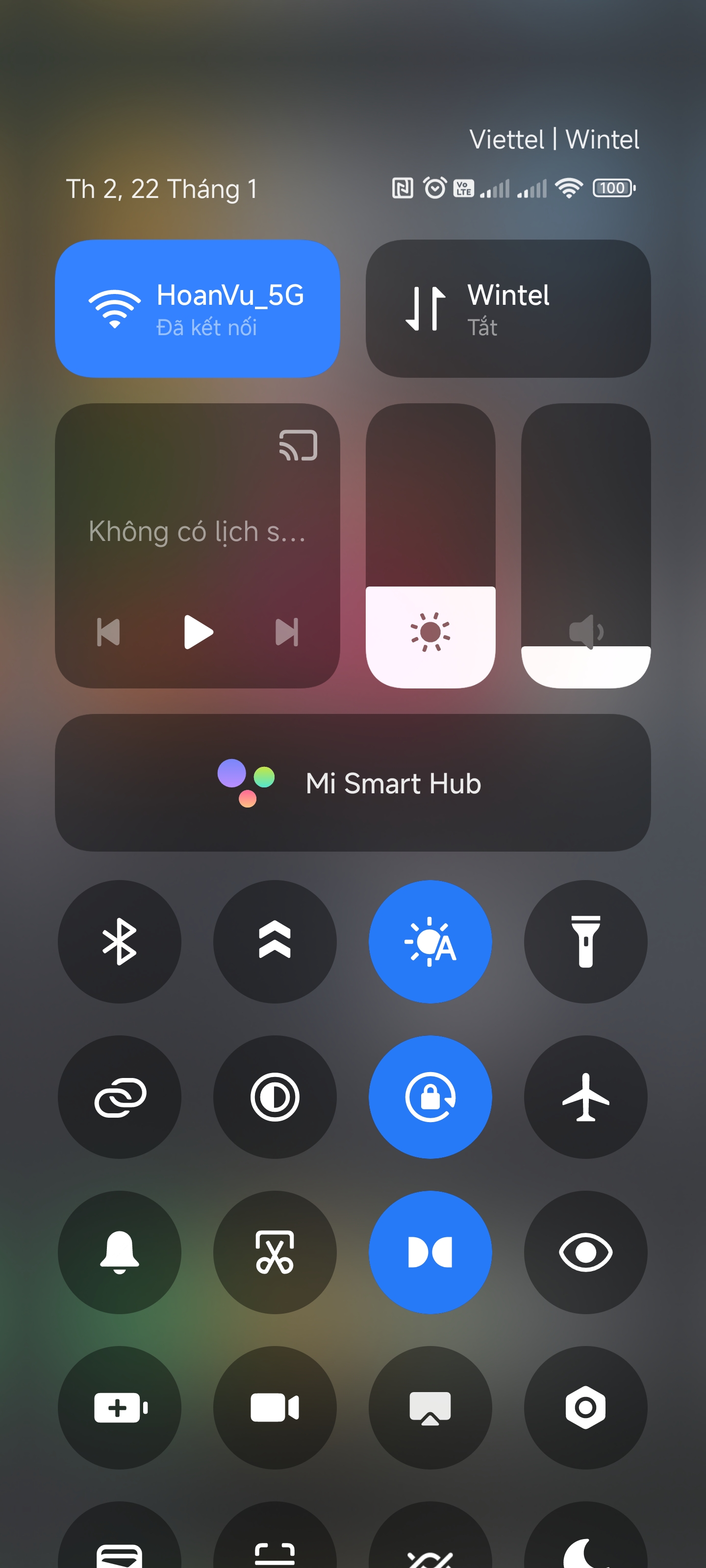

I have the screen brightness set to the level shown below:Screenshot_2024-01-22-06-44-57-189_com.miui.home.jpg
From that level onwards, my automatic change of scanning frequency (LTPO) will work normally (I deleted the rom before), and if the brightness is below the level as shown in the photo, the LTPO will not work and will stay on. Scanning frequency is at 120fps and does not change frequency
I am afraid that this is beyond my knowledge. Maybe one of the developers can explain this. When I display my frequency, it seems to be adjusting correctly / appropriately.
