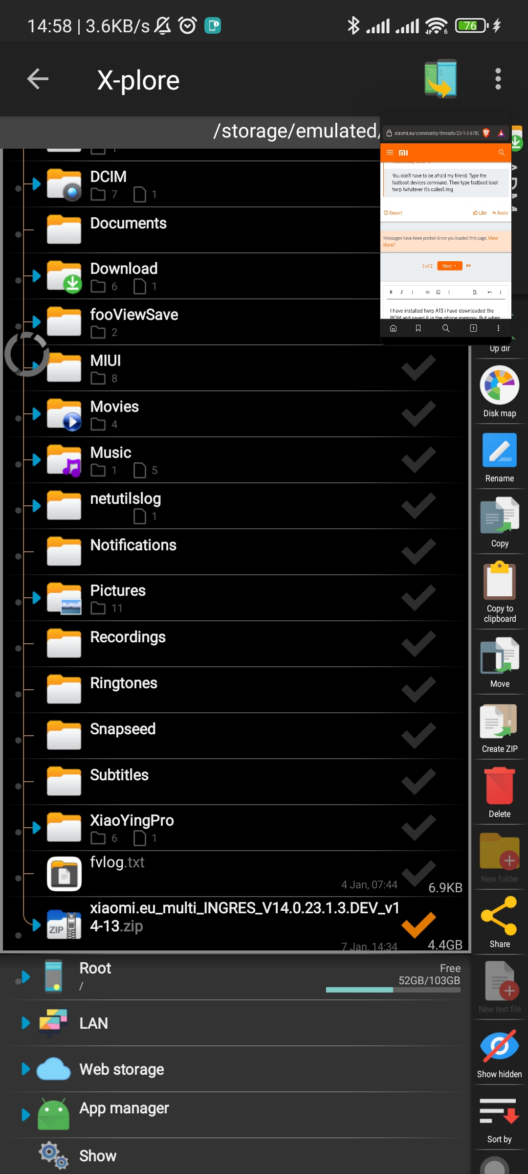

I have installed twrp A13 i have downloaded the ROM and saved it in the phone memory. But when i go to recovery to install i cant find the ROM file. in recovery i found only Mount SDCard and Memory about 60GB. I can't find the downloaded ROM file anywhere in recovery. How do I see the downloaded ROM file in recovery? Thanks.

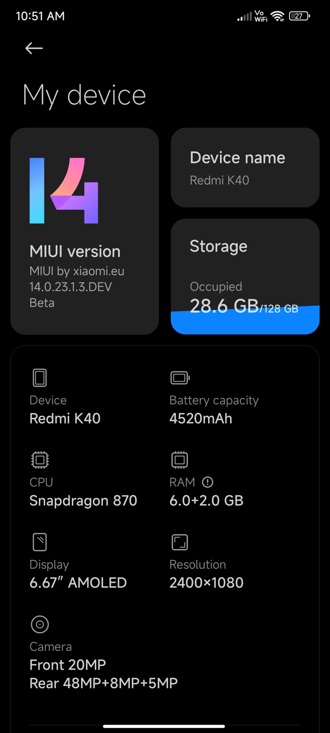

The new MIUl by xiaomi.eu 14.0.23.1.3.DEV Beta (Recovery) updated flawless on Poco F3 using TWRP v6.6 A13 by SKKK
Thanks Dev Team,
