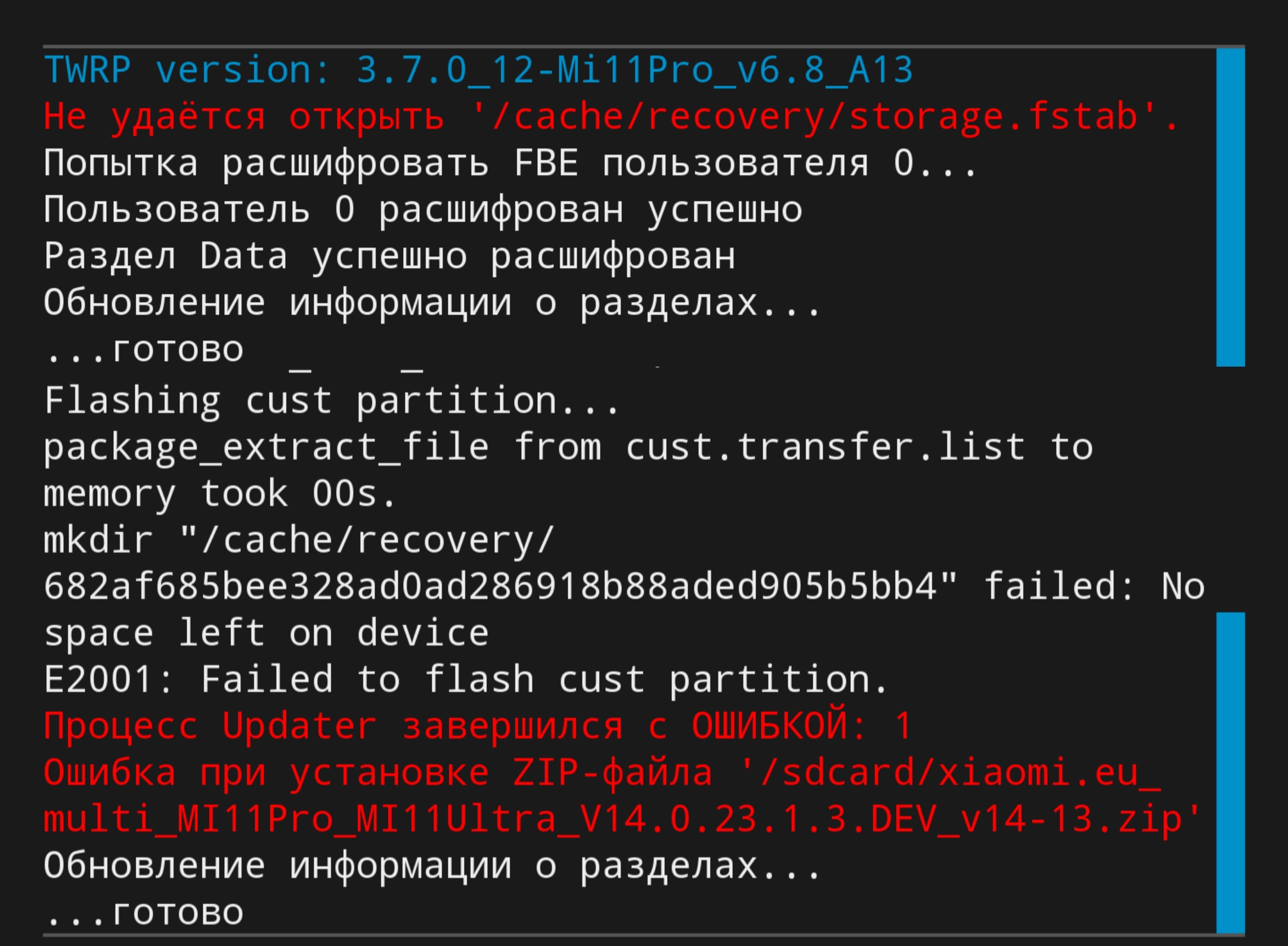

based on your picture - you are tryiong to install a Mi11 rom...Hi everyone.
On my Xiaomi 12 with 22.12.26, twrp-3.7.0_12-v6.7_A13-cupid-skkk installation is OK.
But during ROM installation the attached error appears. I reboot TWRP and try again, but the error reappears. 2, 3, 4 times.
And phone boot always in fastboot.
Then I must install ROM 22.12.26 in fastmode.

You installed the wrong twrp. You can download the correct twrp for your device herehow to solve without format data?
Thanks...I have installed rom finally. Only wake up bugYou installed the wrong twrp. You can download the correct twrp for your device here

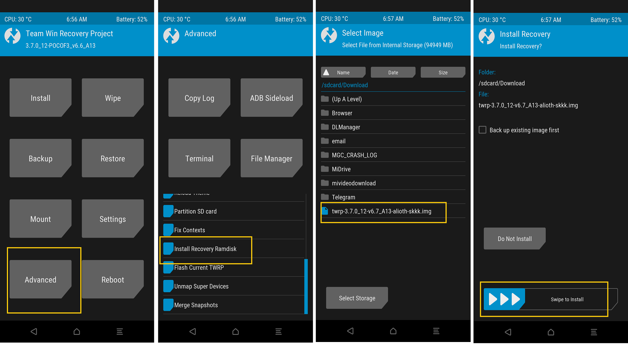

I did it with fastboot boot new twrp (just to be on secure side), then "flash current twrp", that works too. Had installed older twrp before.Put the current TWRP file on your phone, reboot into TWRP and install.
After the update, reboot into recovery.

The procedure I mentioned is for devices with a CPU: Snapdragon 678/680/695/778G/778G+/780G/870/888/888+

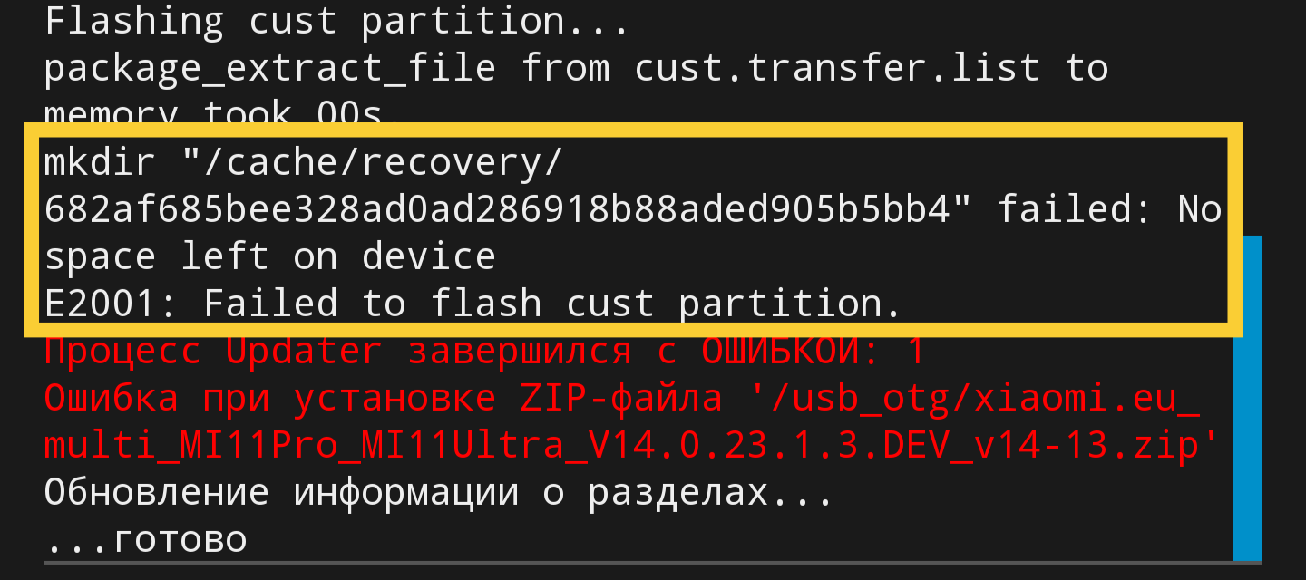

Make sure you are using the correct twrpI'm trying to update from 22.10.26. TWRP 6.7. What's the warning before ERROR 1? Mi11Pro (mars).
Do you mean the new version 6.8?Make sure you are using the correct twrp
The same warning...
