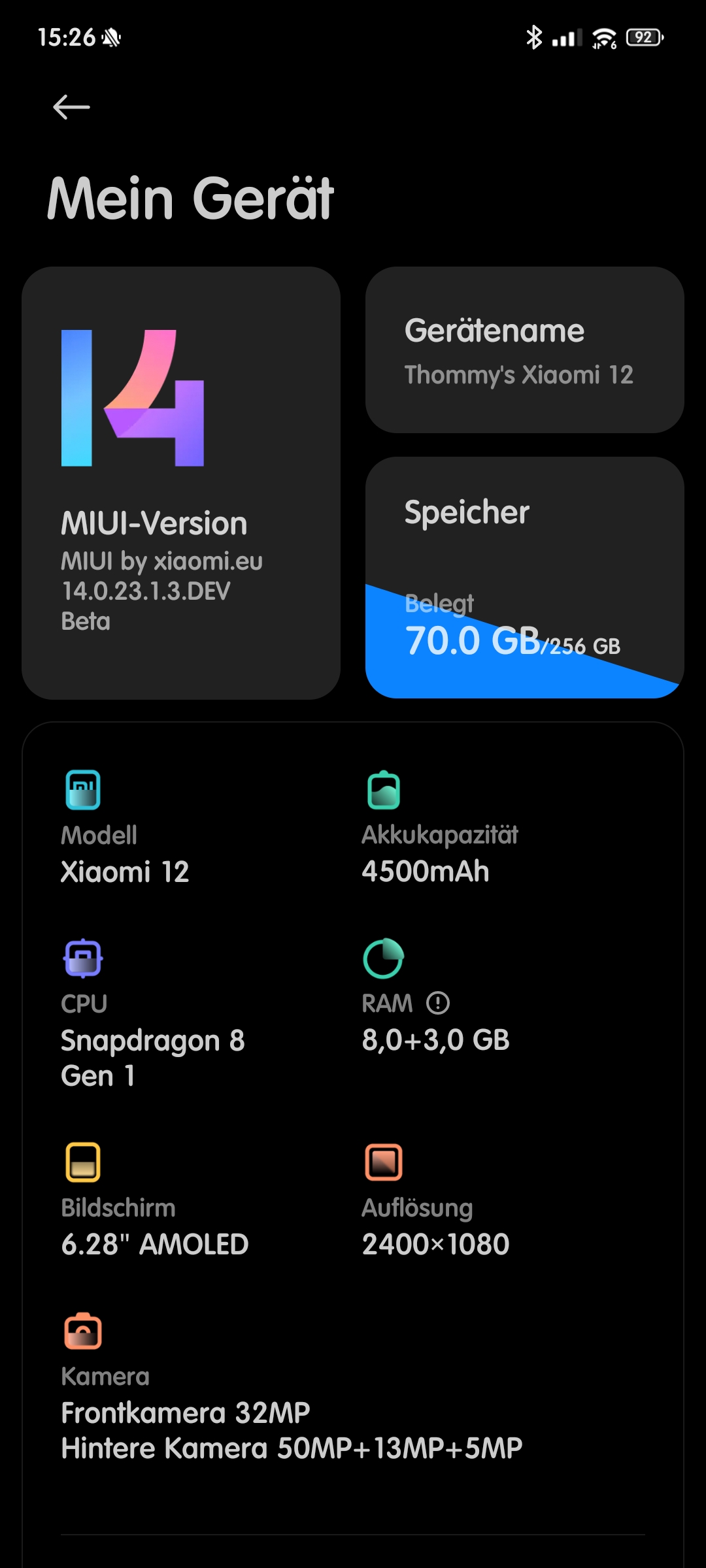

Xiaomi 12 Cupid successfully flashed. 1. "fastboot flash recovery_ab twrp.img" 2. Reboot into TWRP with power button and volume up. 3. In TWRP "flash current twrp" 4. Flash ROM 5. Reboot into the system 6. Have fun with the new version
