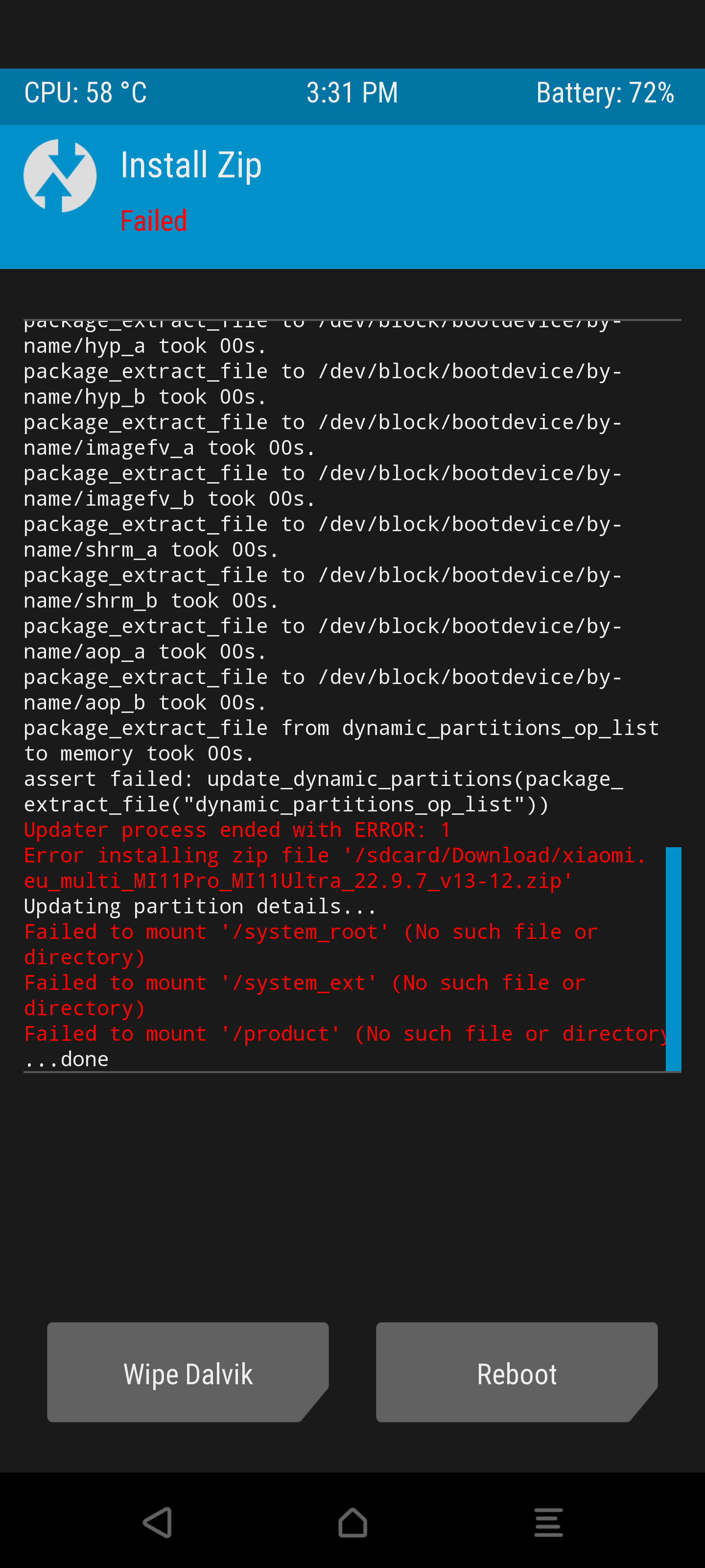

Hello, I tried to update but this error message appears. Can you please help me?
What I have tried:
1. In TWRP reboot to recovery - flash
2. Wipe - data - repair - reboot recovery - flash
Thanks for your help.
