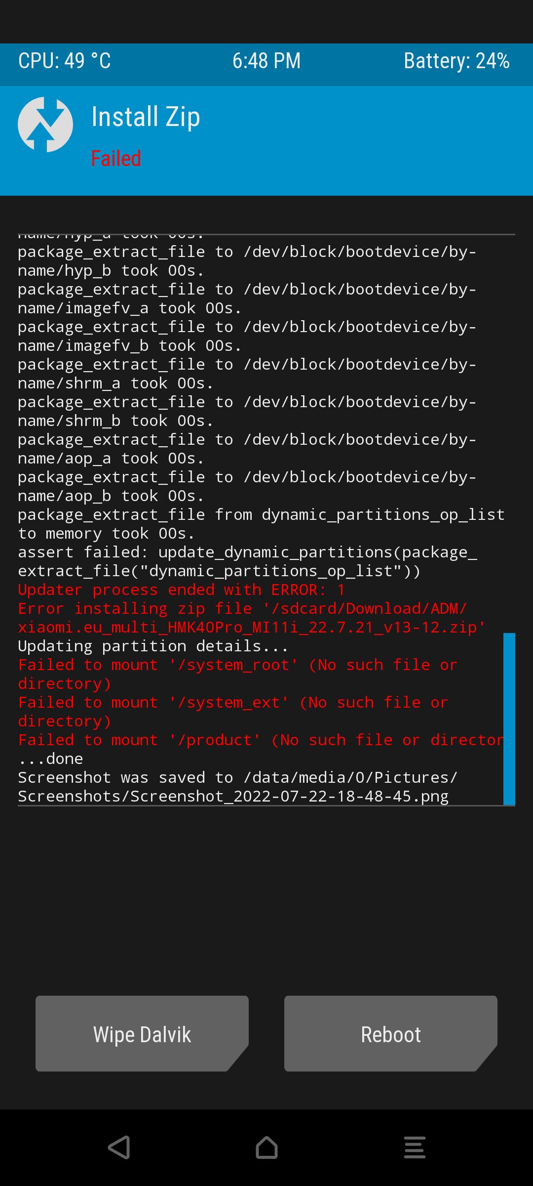

Mi 11 ultra unable to install with this error.
Using twrp v3.8.3.
Any advice?

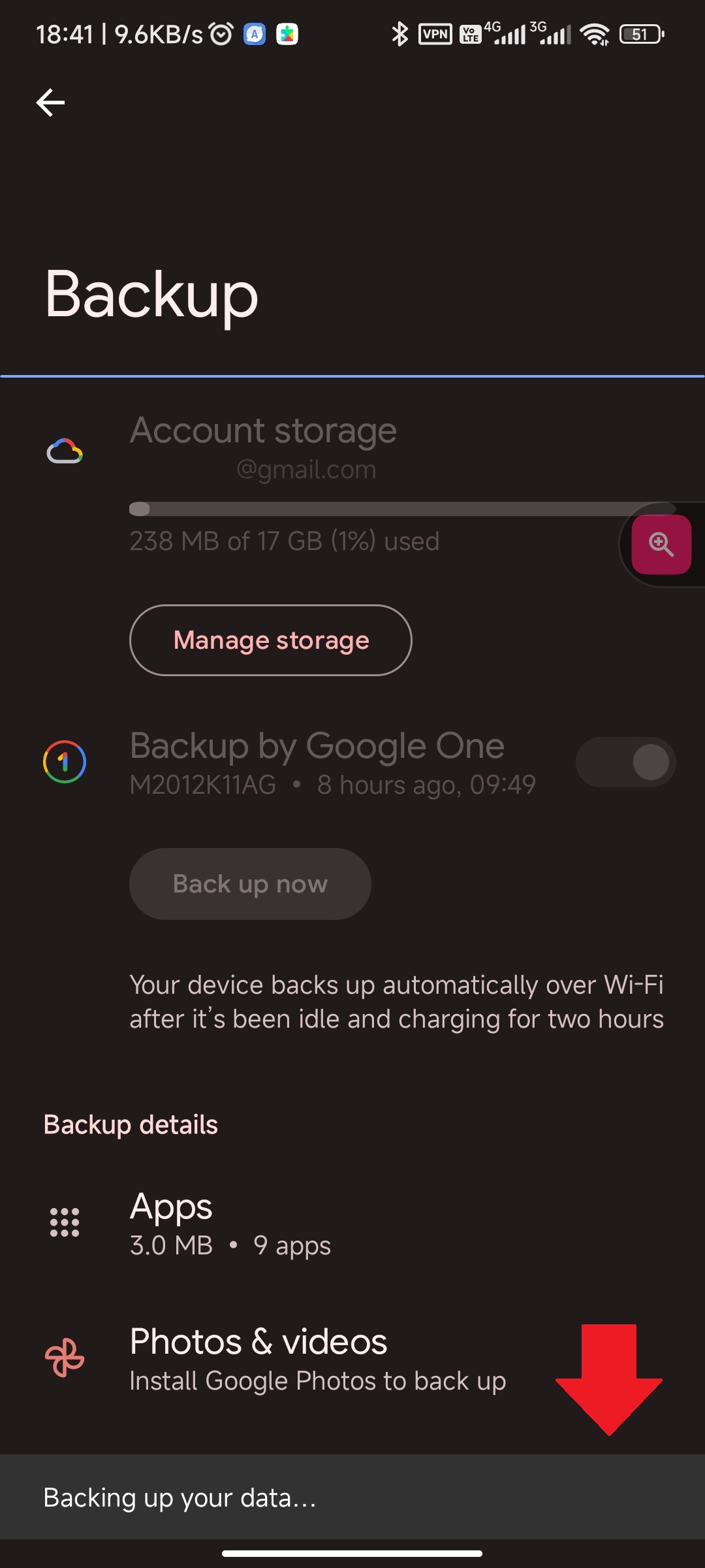

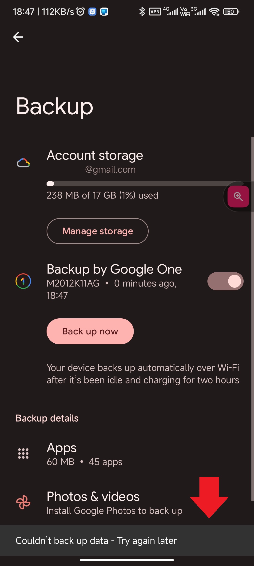

"Google One Backup" still doesn't working on my Poco F3.
I'll wait for a reliable fix in the next Weekly build.

I'd try to used this version of TWRP but still the same error it still failed to install the new Rebuilt ROM, thanks by the way.
I also have now the problem with the rebuilt rom to install on my mi11 pro. My solution in a view posts bevore with twrp restart in recovery mode and install the rom also does not work anymore
Strange,
I just restarted my phone the fitht time into twrp ( without twrp restart in Recovery) and at once i get no error and i could install the rebuilt rom without error. So it looks like gambling
Mi 11 ultra impossibile da installare con questo errore.
Utilizzando twrp v3.8.3.
Qualche consiglio?
after trying to flash go back to clean / advanced flag dalvik art execute, then without exiting recovery restart in recovery and once restarted in recovery flash the new rom
I tried that but still same error...

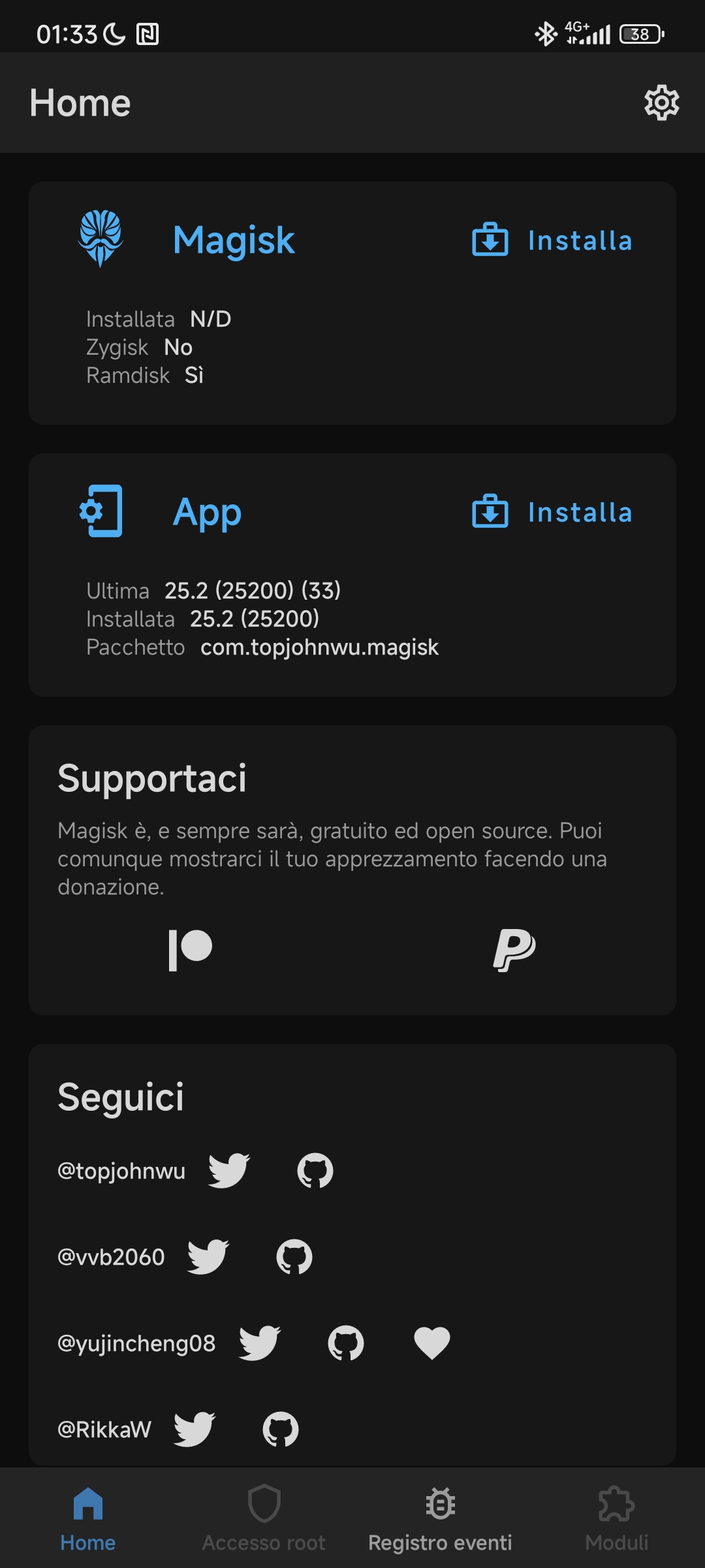

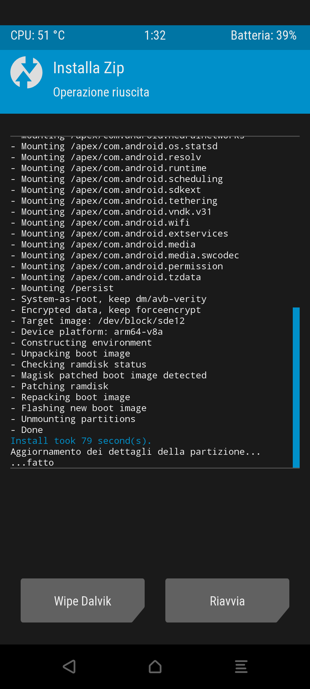

I guys, I have a problem installing Magisk on Mi 11i (Haydn).
Basically (as you can see in the screenshots) TWRP tells that the zip was installed successfully but when I open Magisk it shows that there is no root access available... What can I do?
