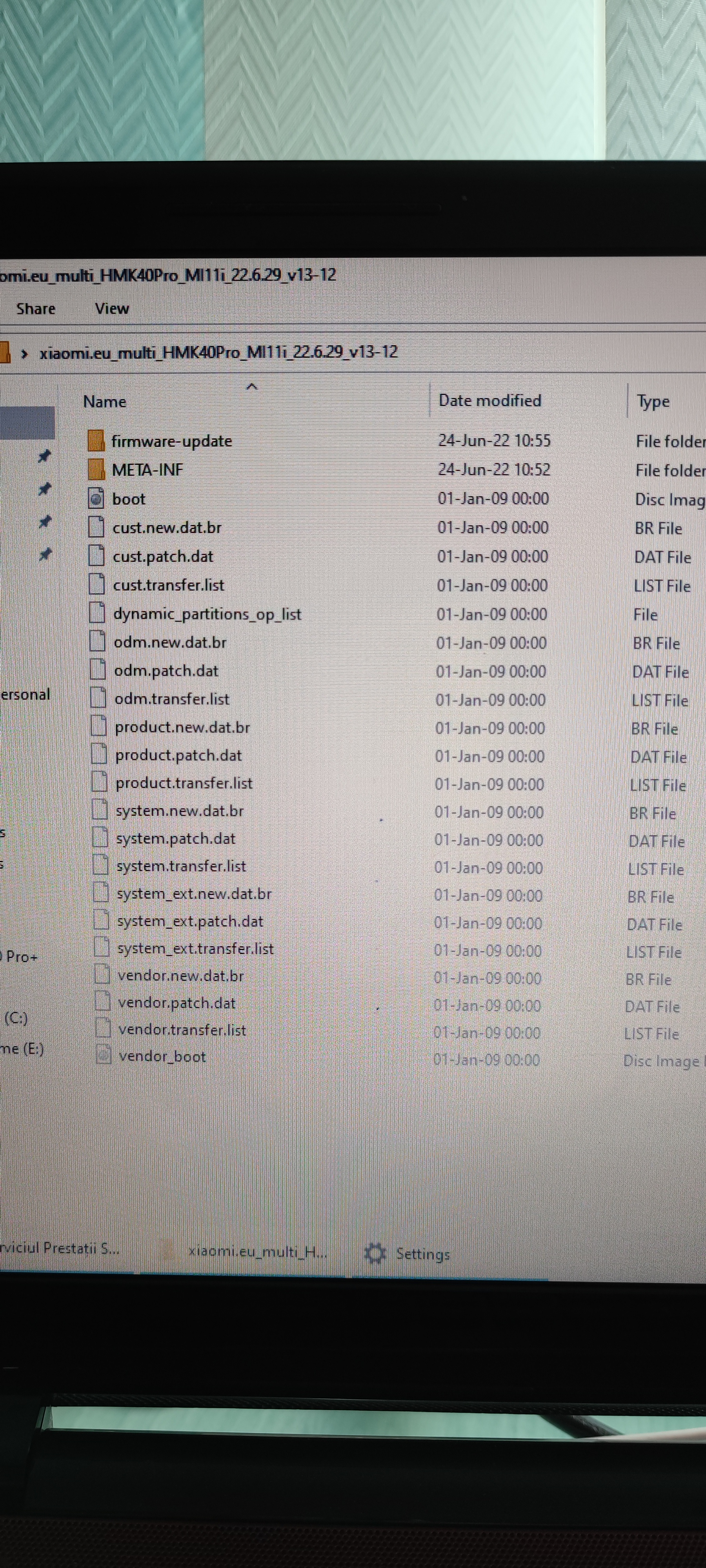

Just download the file for Mi 11 i , extract the file but i do not see the script for update rom.

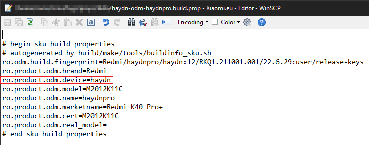

Thank you very much. I just flash TWRP from the link,but now when i try to install the rom i got this error : this package is for haydn devices this is an haydn pro
I found something.
"For Mi 11i , Haydn you have to change updater script to something like that below ..
Only the first line , make it ..
getprop("ro.product.device") == "haydn" || getprop("ro.product.device") == "haydnpro" || abort("E3004: This package is for \"haydn or haydnpro\" devices; this is a \"" + getprop("ro.product.device") + "\".");
This way can read haydn or haydnpro and installation will be completed just fine ..
You can even delete whole first line ..
This is a twrp issue .."

Solved.Thanks a lot . Many thanks to developers for this update.

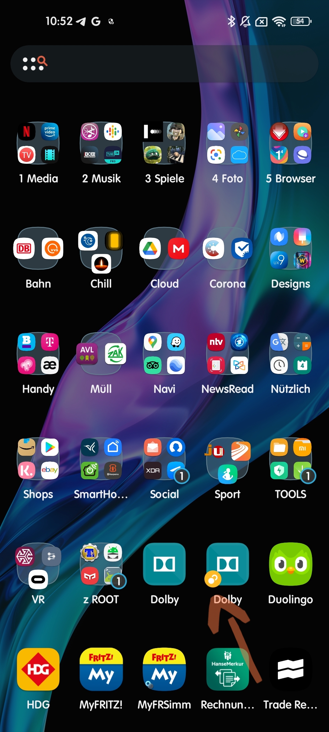

Sorry for asking, but it's a long time since last update for me. What is that sign meaning in this app and why is this app twice here?

when edit updaterscript get error on zip when try to install on twrp
