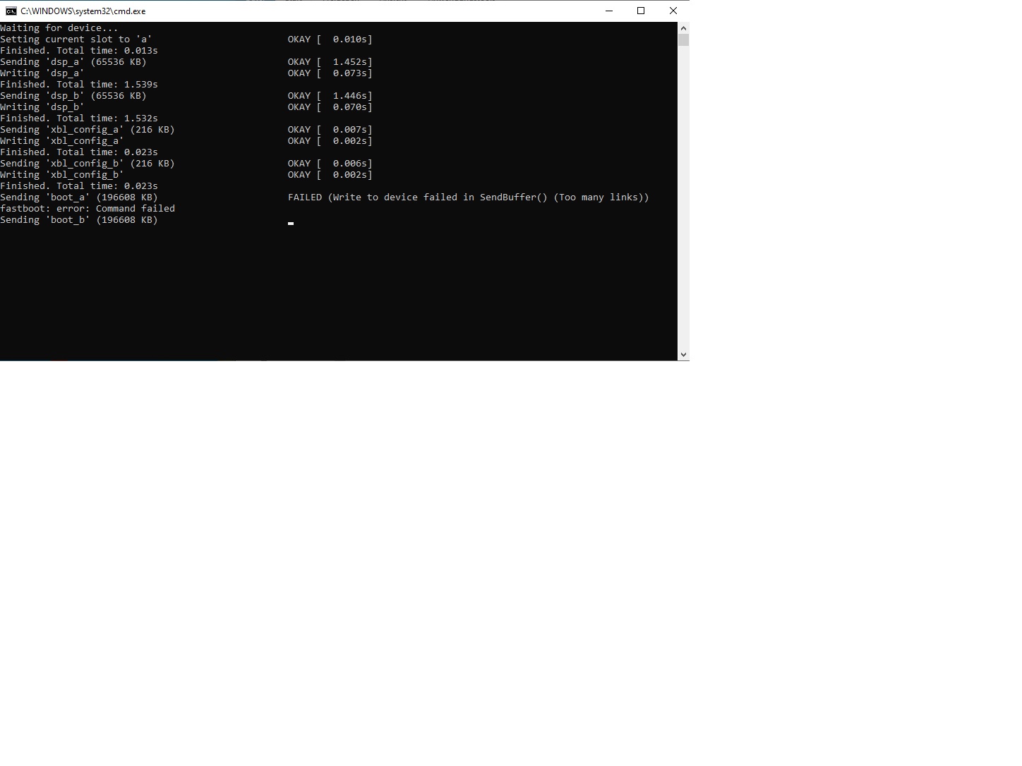

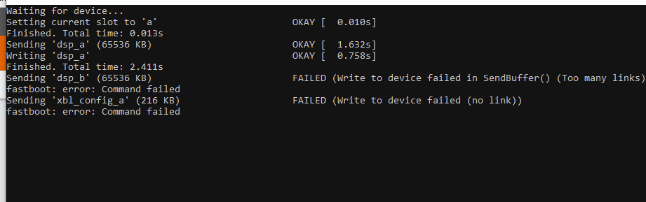

I I am getting this error when trying to install new weekly.
Any idea to solve this problem???

Sending 'dsp_b' (65536 KB) FAILED (Write to device failed in SendBuffer() (Too many links))
fastboot: error: Command failed

cable are orginal and yes it USB 3.0 should be cancled close command again ?run
edit
yes use USB 2.0 to working flash done

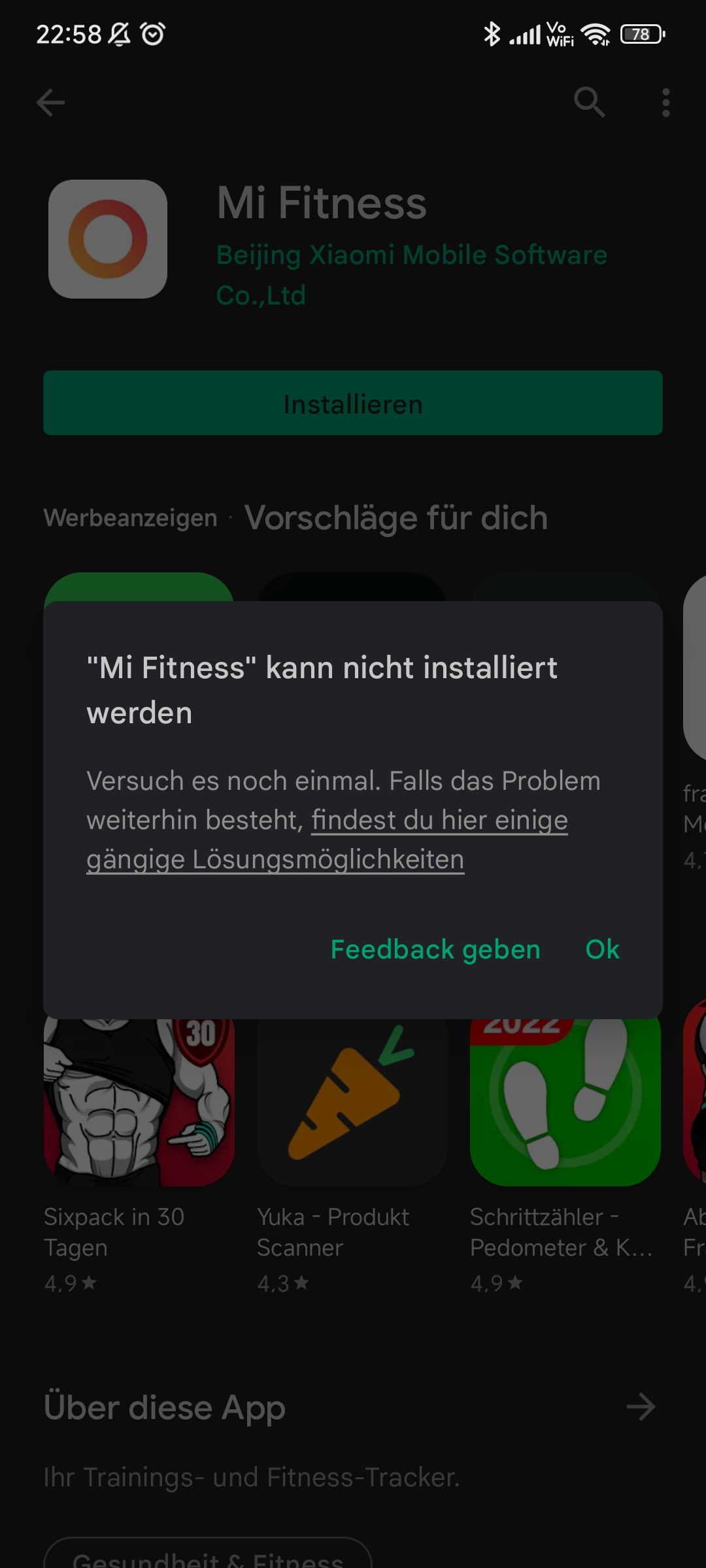

I do lots of workout and wanted to check on Mi Fitness with new built, but it doesn't seem to be installed on my F3. Install from Playstore is somehow not allowed and apk from apk mirror I can download, but not install since it is a system app. Permission is granted (from files, Chrome etc) but because it's system it's still blocked.
Any idea?

China Mi Fitness (com.mi.health, same as Health app) and Global Mi Fitness (com.xiaomi.wearable) are not the same app, but they are conflicting due to some identically-named components. You can't install the Global Mi Fitness on our ROMs.
Why not let the user decide whether to install the global version instead of the Chinese version, especially if it has the global language translations?
