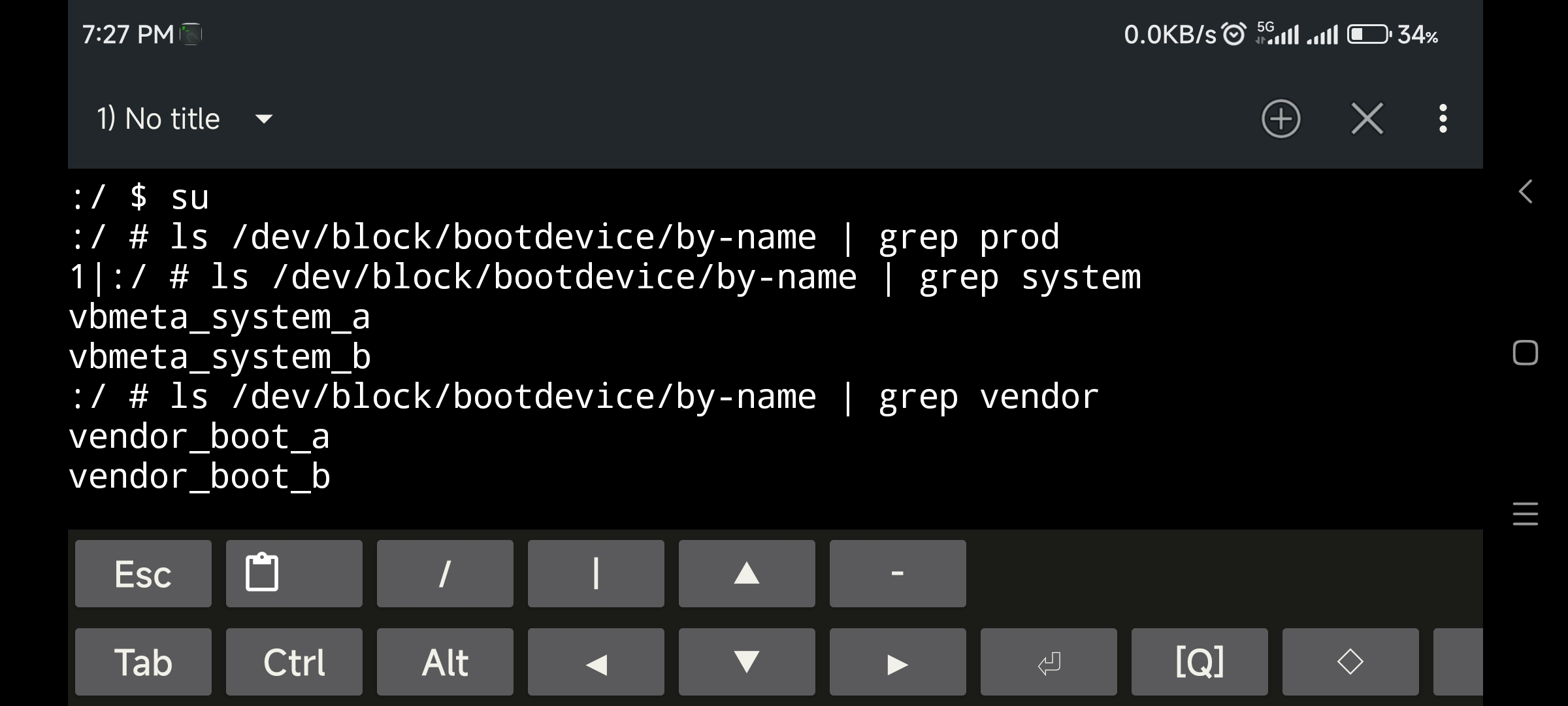

The five 'super' or 'resizable' partitions (system, system_ext, product, vendor and odm) are not preset in
/dev/block/bootdevice/by-name - screenshot attached
Strange, it usually lists all active file-systems
Additionally, in /vendor/etc/fstab.emmc, those five plus metadata are defined (and only them) with

Btw, slot _b is not fully empty, those not resizable partitions are properly flashed, Eg, I successfully disk-dumped boot_b and it was (as supposed) your boot.img
Ie, I tested then:
fastboot boot <disk-dumped boot_b img>
and it perfectly booted to the 22.10.12 System
Just let me 'flash.out' few more findings
first_stage_mount:
<mnt_point> <type> <mnt_flags and options> <fs_mgr_flags>
system /system ext4 ro,barrier=1,discard wait,slotselect,logical,first_stage_mount
system_ext /system_ext ext4 ro,barrier=1,discard wait,slotselect,logical,first_stage_mount
product /product ext4 ro,barrier=1,discard wait,slotselect,logical,first_stage_mount
vendor /vendor ext4 ro,barrier=1,discard wait,slotselect,logical,first_stage_mount
odm /odm ext4 ro,barrier=1,discard wait,slotselect,logical,first_stage_mount
Seems, it is used for Treble enabled ROMs:
Sorry for going wide and OT
My answer was to why it's unbootable. I'm not saying that ALL of the partitions on slot b are empty, but some of those necessary for booting are.
As to why it's not bootable to recovery at least, that I do not know and don't really care.

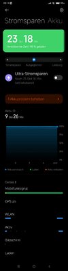

Battery drain at Bedtime running smoothly on Poco F3.
Ok, I gave it a try, Werksreset and fresh installing all apps step by step. Not yet all reinstalled and battery drainer not yet identified, but so far battery overnight is now obviously superb and 1A :)
