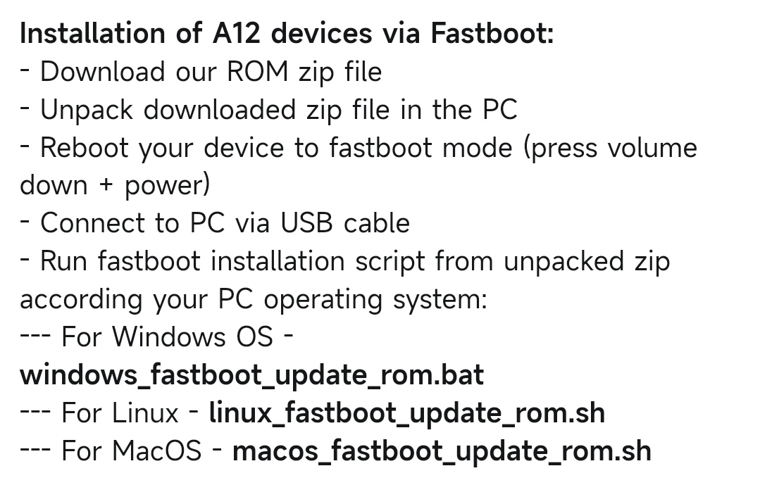

Good morning, I can simply install this version via my 21.7.14 via Rom update or rather first install with data format
Good morning, I tried to flash miui 13 on my xiaomi mi 10T 5g, when I finished, it did not go out of the original mode and I tried to return to my previous version, it was installed and raised my phone but when I turned it off and on I did not want to turn it on. If someone can help me please I would appreciate it with my heart
Hi, ingbrzy. Adb sideload failed .... File bat Mi 10T _22.1.6_v13-12-fastboot .... But install any zip rom ... ???

Yes, TWRP is not needed for fastboot ROMs.
Reactions: mza77
did u follow this instruction?
Reactions: geoorg

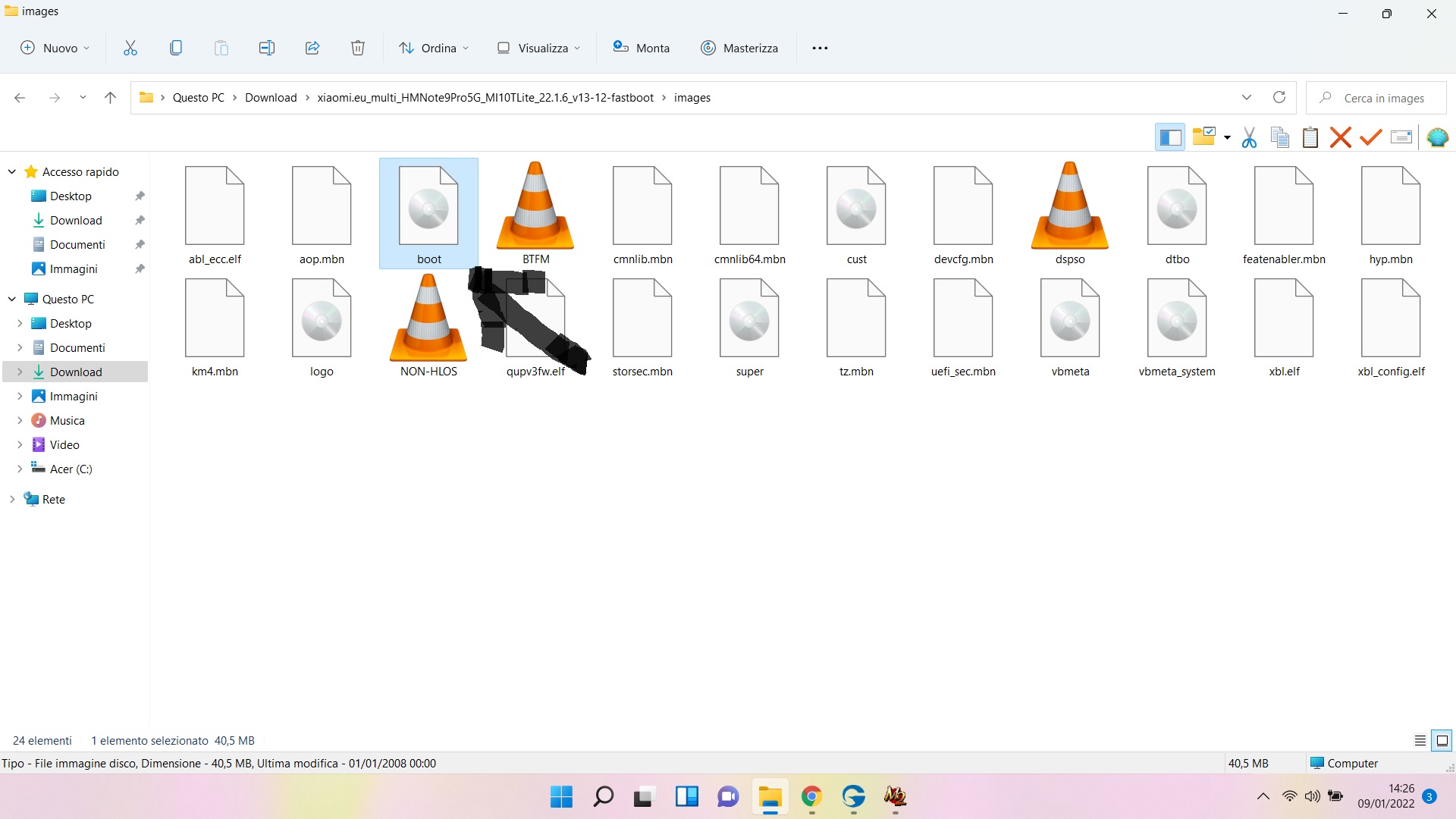

Smartphone: Mi 10T Lite
Rom installed: weekly EU (xiaomi.eu_multi_HMNote9Pro5G_MI10TLite_22.1.6_v13-12-fastboot)
Hi guys.
I would like to root my smartphone installing Magisk without recovery.
I installed the Magisk app and I noticed that I have "ramdisk: yes"
Now i was wondering how to find the boot.img file that i need to patch.
Is this the proper file?
Hi guys.
no discussion about magisk here but u can follow this thread
Thread '[HowTo] Magisk install without TWRP' https://xiaomi.eu/community/threads/howto-magisk-install-without-twrp.64511/
