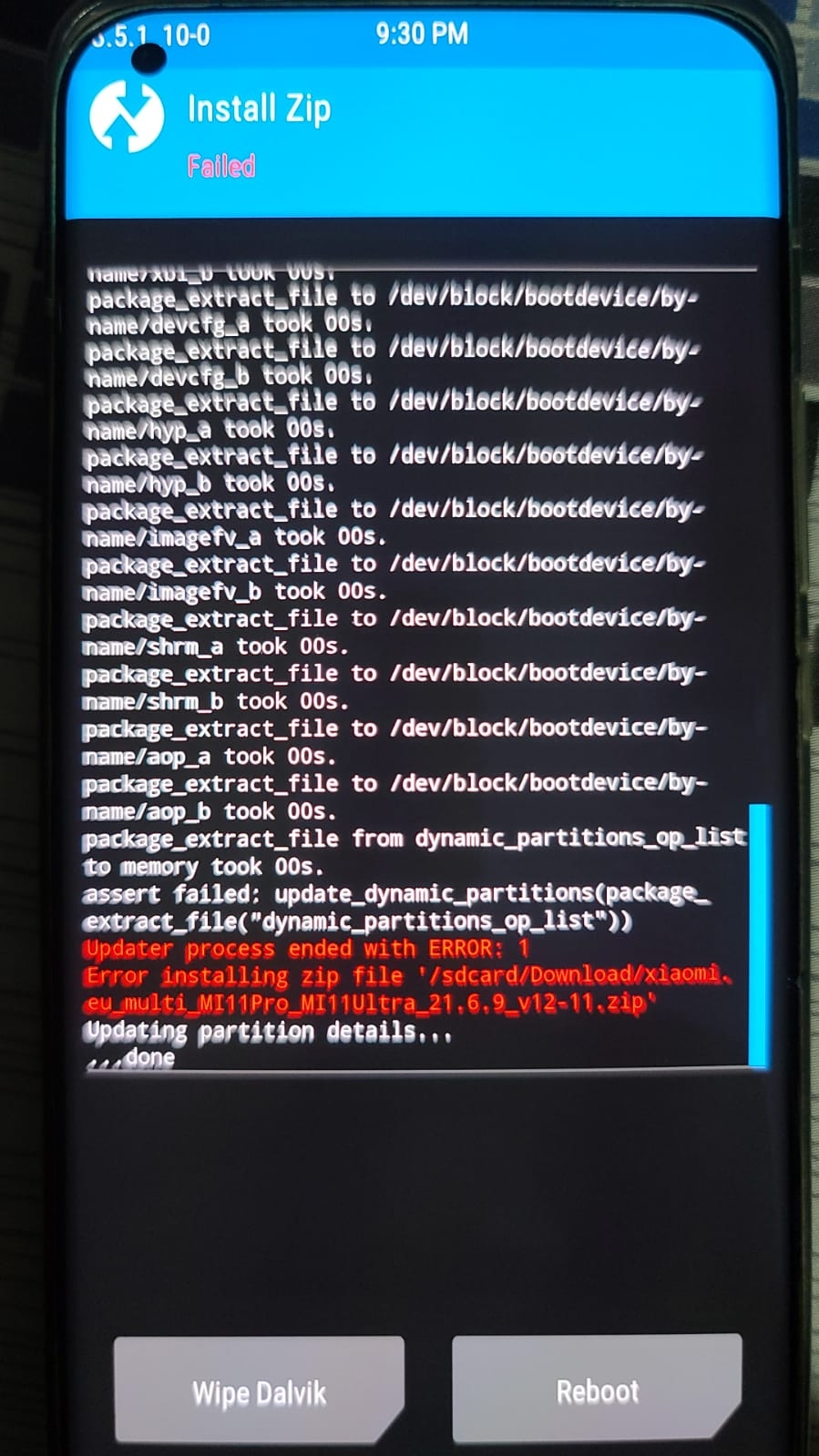

Hi Igor Eisberg! I am using Mi 11 Ultra weekly version 21.5.26 trying to update to the latest 21.6.9 but the below error stop me from updating. Please help to see what I can do.
I'm not a TWRP developer. I have no idea.
