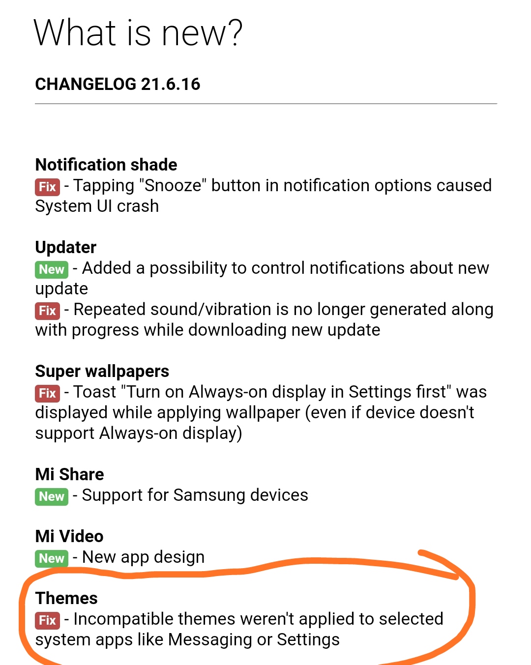

I know what incompatible means. And If it was not a rom issue at all, it wouldn't have been mentioned in the rom's change log, would it?
Please read the change logs before replying...

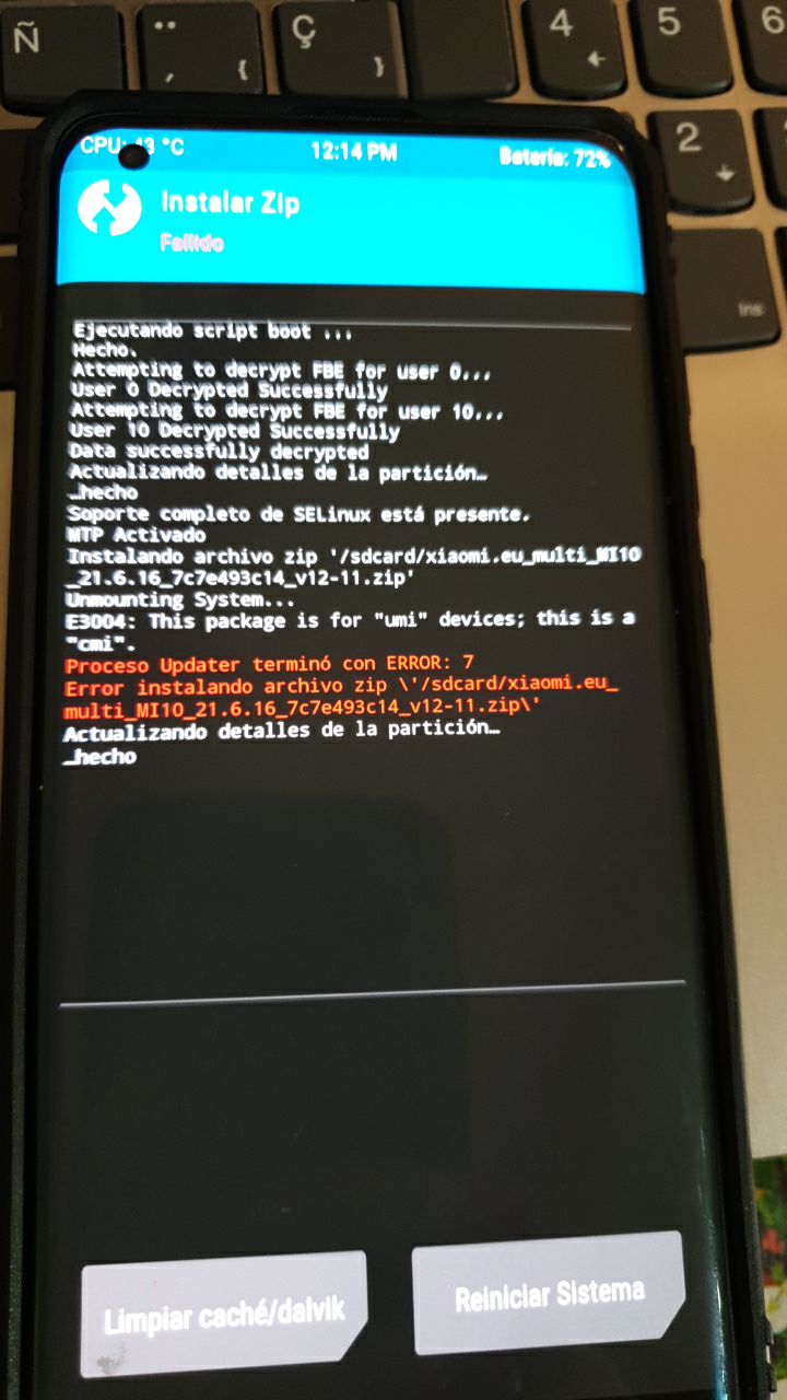

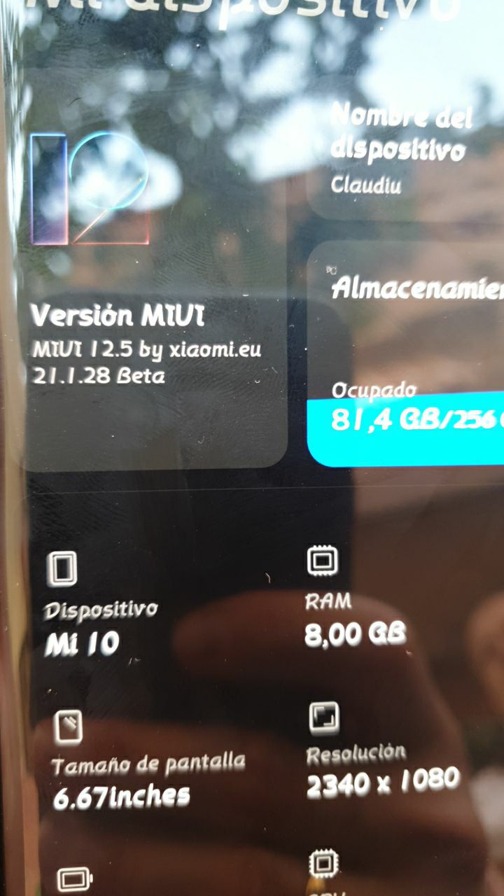

Hello, I have a friend with the Mi 10 and he gives an error when installing anything update via ota.
Neither download the rom manually and go to twrp allows you to install it.
Any solution?
Amy solution?

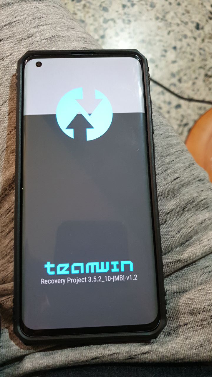

have you ever tried to install a different version such as 21.4.x? Is the latest twrp on the Mi10?
Latest rom and latest twrp only
I have managed to install 21.6.9 but I can't install the latest one (this version of the post)

Install TWRP made for umi (Mi 10) and not for cmi (Mi 10 Pro). ;)
You can try with this TWRP => https://androidfilehost.com/?fid=14943124697586336684
This is a new one that I haven't seen yet.
Any idea of the differences between this one and the 3.5.1 (MB) which I still use, always without problems (except for the delays!)?
[Edit: just tried booting into it and my phone just rebooted back to system, so I cannot comment on it. I probably won't be trying it again.]
Any solution?
Something is wrong somewhere with the phone name.
Your flash is rejected because of this. UMI and CMI.
check that and update your TWRP to latest if not done.
