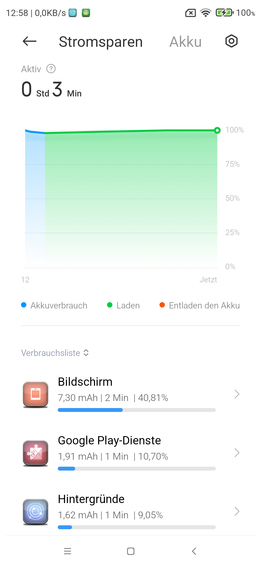

Yes, I noticed that on my MI9 yesterday too. I had it on the PC to copy the backup and other files and it dropped from 51% to 49%. Then I put it on different chargers because it wouldn't charge any more and only came up to 100% when I switched it off.
But today it responds normally again and also charges from 98 to 100% when running on the PC!
34720
Maybe this is related to the new smart charging feature of Miui 12.5
