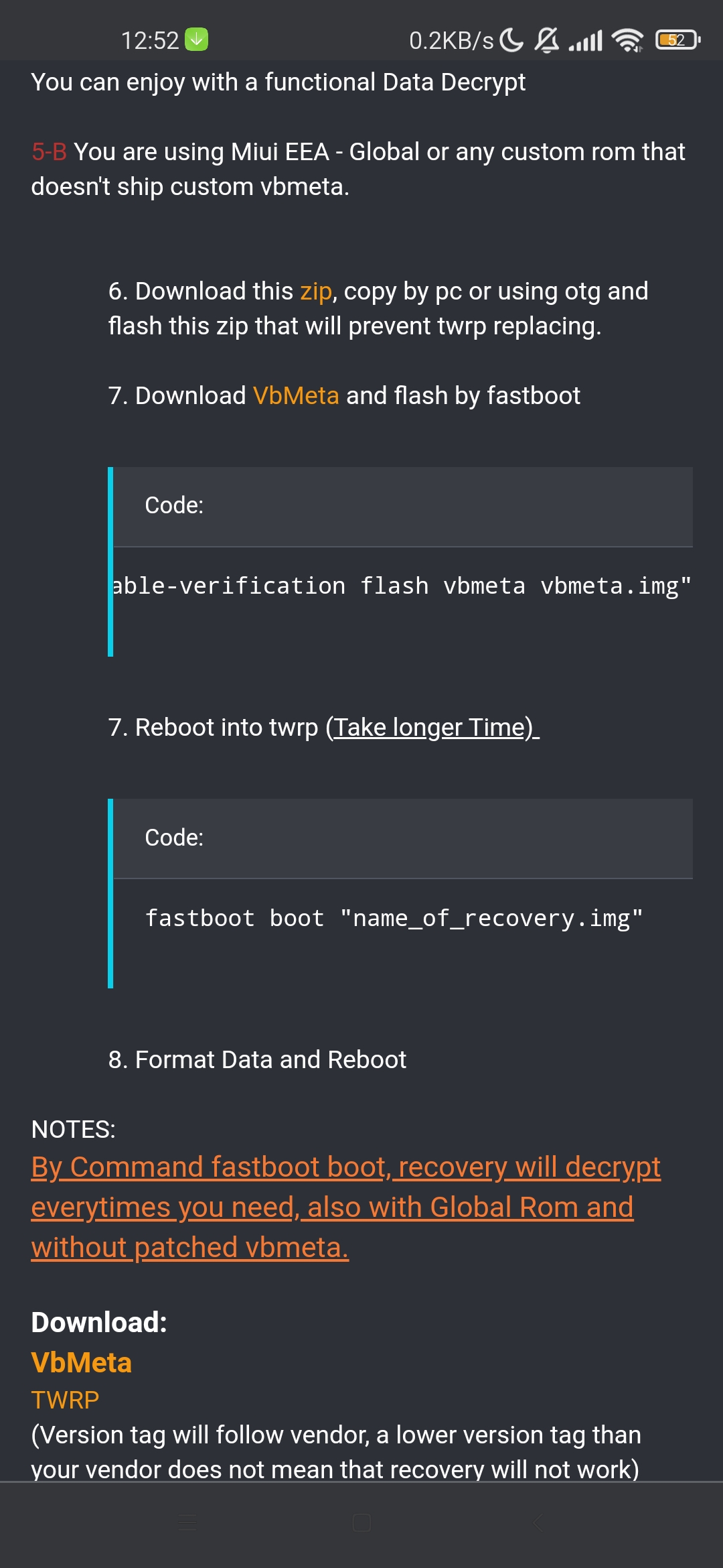

Wow, new twrp for mi 10? In the guide the guy says to flash vbmeta and format data? Why?
EDIT:The vbmeta flash and data fromat is probably for those with stock roms:
I didn't flash vbmeta and didn't format data because it is not a first time flash..
Usually vbmeta and format data needed for flashing for first time after unlocking..
Data was decrypted so i didn't formated , anyways i will see the behaviour of data decryption after flashing the new rom today and will see if it needs format data or we can skip this ..
At this time data is decrypted and twrp works like a charm ..
