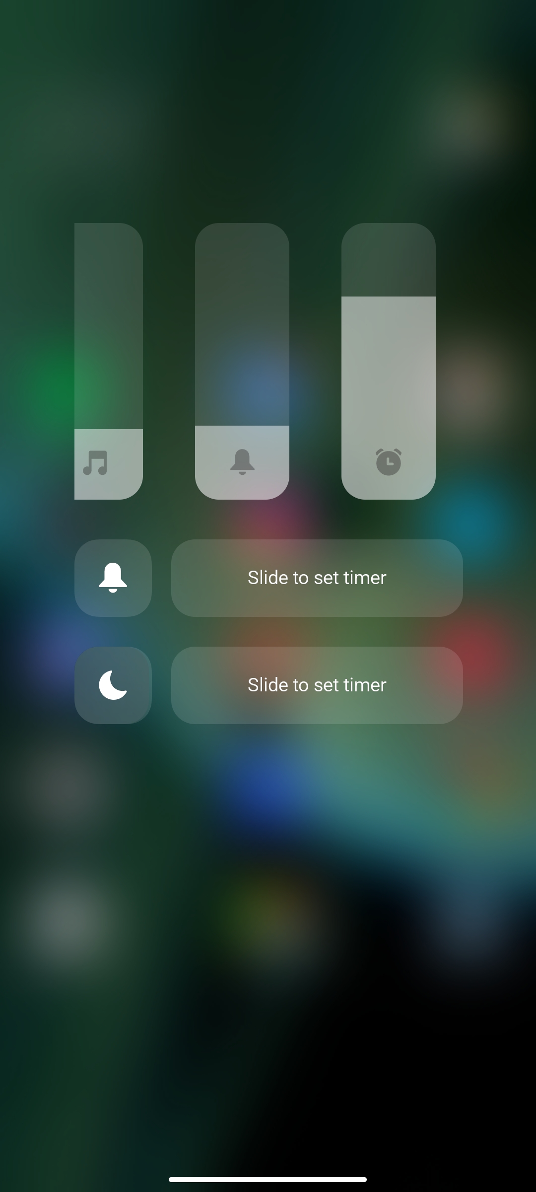

I have an issue with the Mi mix 4, when casting via Chromecast volume control panel is broken as below.

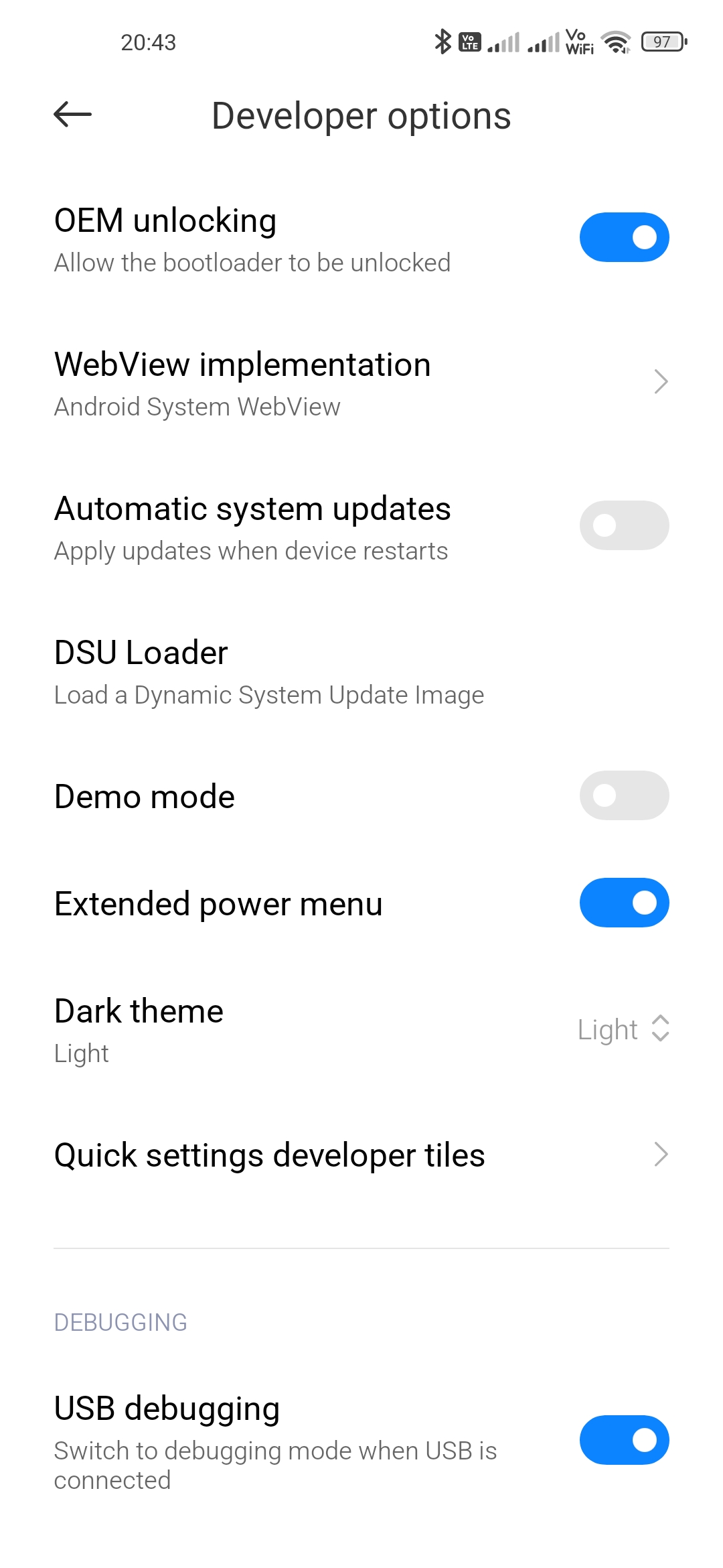

ok for all with fastboot issue , if you wanna update and have black CMD screen and nothin happens, here is fix..use this driver watch this video how to install driver if you dont know, check if you have developer usb debug on, unlocked bootloader, run bat as administrator and you need to put phone into fastboot mode before update - driver works for all Mi devices, on any windows even 11, have fun!
really appreciate your help, not something you should have to be doing. But even doing that I have no options, still just a black cmd screen.
I've followed advice on other posts (removing driver signing authorisation etc) and what you have put.

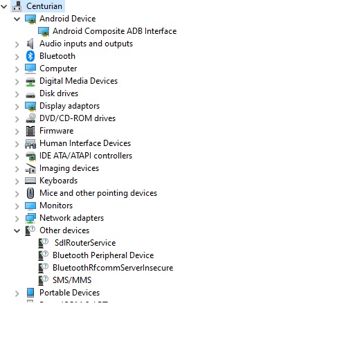

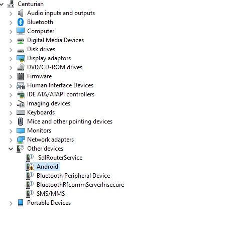

When I connect my phone normally, I get Android Composite ADB Inteface within Device Manager, but in Fastboot mode this disappears and have just a plain Android device showing with exclamation mark.
Update the driver manually then (select from installed drivers list Google > Android Bootloader Interface)

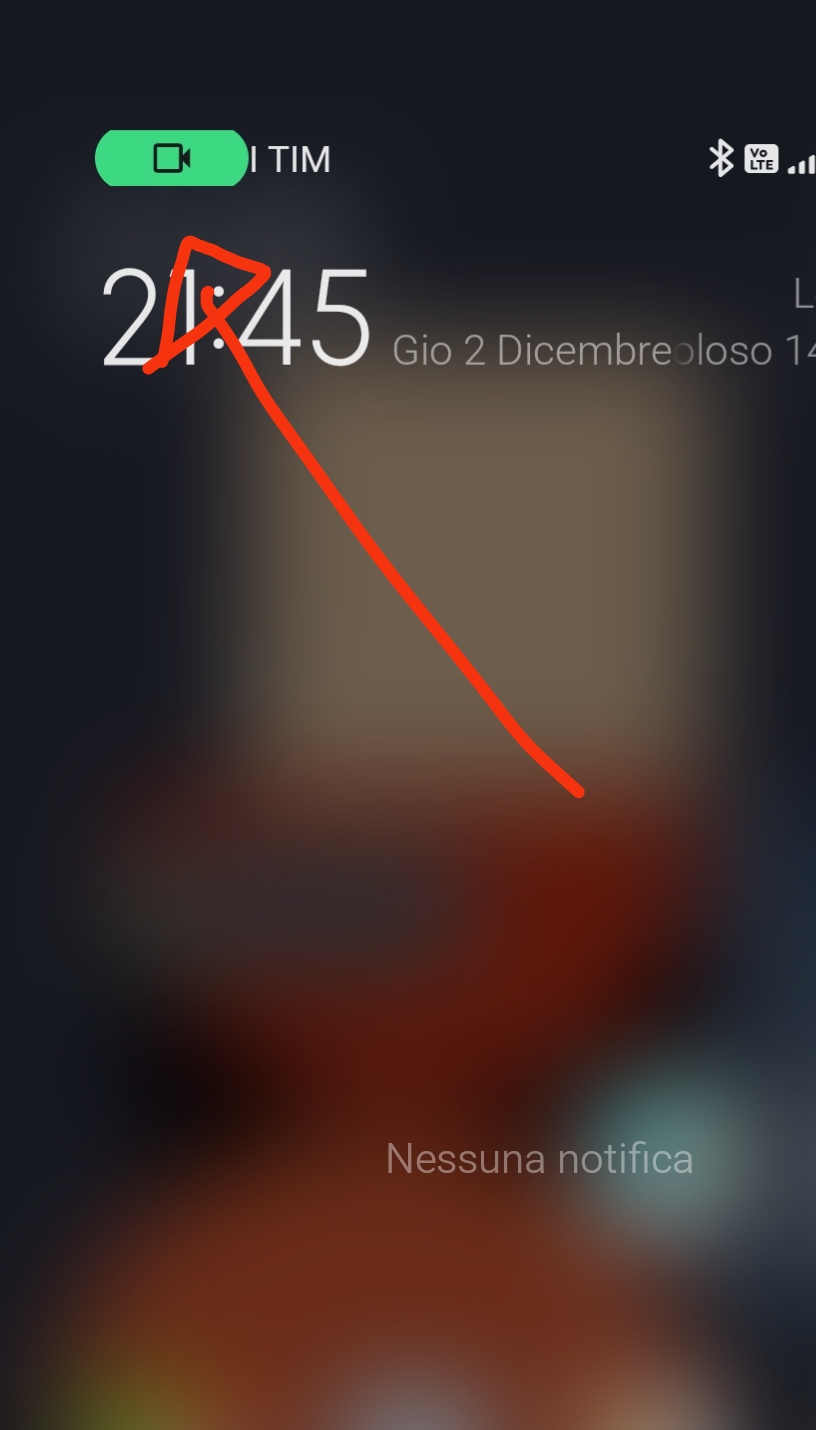

Guys, what's that green camera in the top left corner? It appears sometimes...
Welcome to Android 12. This is a feature added by Google.
Those who wish to permanently temporarily (until it's reverted automatically) disable the camera/microphone usage indicators , use this command using ADB:
Code:
adb shell cmd device_config put privacy camera_mic_icons_enabled false default
And to disable location usage indicators (if you still have them visible for some reason) use this command:
Code:
adb shell cmd device_config put privacy location_indicators_enabled false default
* To re-enable, replace "false" with "true".
The following command will add a "Status bar location indicator" switch at the end of Developer options:
Code:
adb shell cmd device_config put privacy location_indicator_settings_enabled true default
Unfortunately, there is no equivalent Developer option for camera/microphone indicators as of now.
