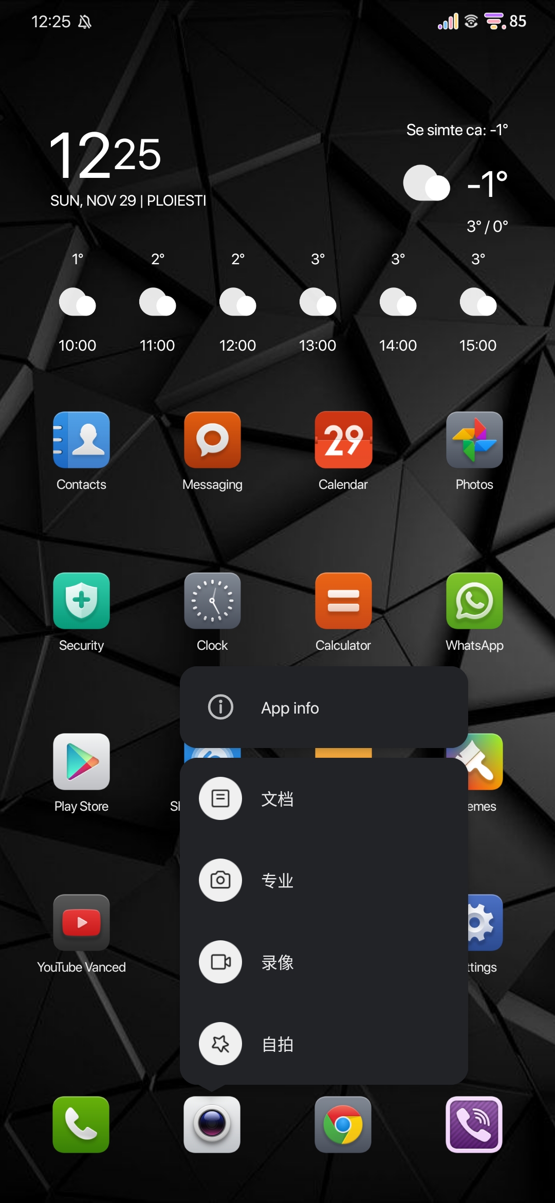

Mi9 camera with chinese caracters

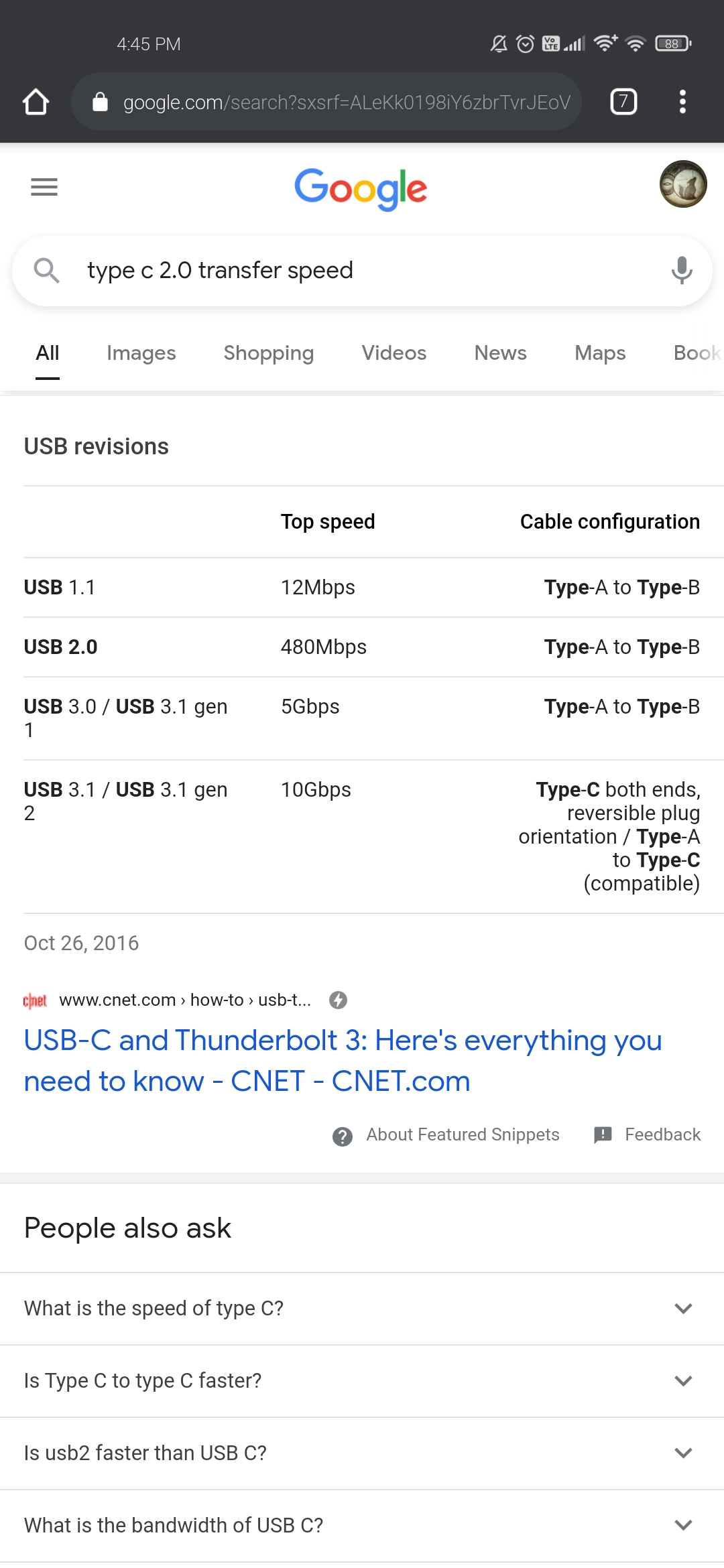

Hi base from my knowledge and what i saw, 400 to 300 mbps drop to 50mbps to a average 10mbps file transfer...
If you are saying type c is base on a usb 2.0 why does it show 400mbps?
Type c is already equipped with high data transfer rate and hardware cannot be faulted, do not educate others that type c is slow.
I see that this has been answered already. What I don't understand : "do not educate others that type c is slow". Why? Are people not supposed to know that devices with USB C connectors sometimes only support the USB 2.0 standard (theoretical maximum 480Mbps)? It might affect the marketing hype "USB C is fast", but ultimately it just confuses people not to know. Some consumer-level information states this; it's not confidential; e.g. "USB Type C even technically supports USB 2.0 speeds at a pathetic 480Mbps. So when you see a USB Type C port, the only assumption you can make is that its transfer speeds can vary from as low as 480Mbps to as high as 10Gbps."
Type c is already equipped with high data transfer rate and hardware cannot be faulted, do not educate others that type c is slow.View attachment 33081
Whatever makes you happy...
