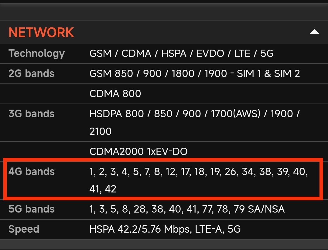

As far I could search Vodafone NZ 4G network uses (B28) 700MHz, (B3) 1800MHz and (B7) 2600MHz frequencies.
The current Xiaomi 12S Ultra version is made and available for China market only and doesn't support (B28) 700MHz frequency (annex) that is mandatory to get strong and stable signal when directly connected to the Carrier but far away from the Base Station like the rural areas at Global markets. Since the radio frequencies (enabled/disabled) are Snapdragon's processor hard coded there is nothing that MIUI.eu can do to handle it. But the signal should work fine in the metropolitan areas. The radio frequencies are the main difference between China and Global models versions.

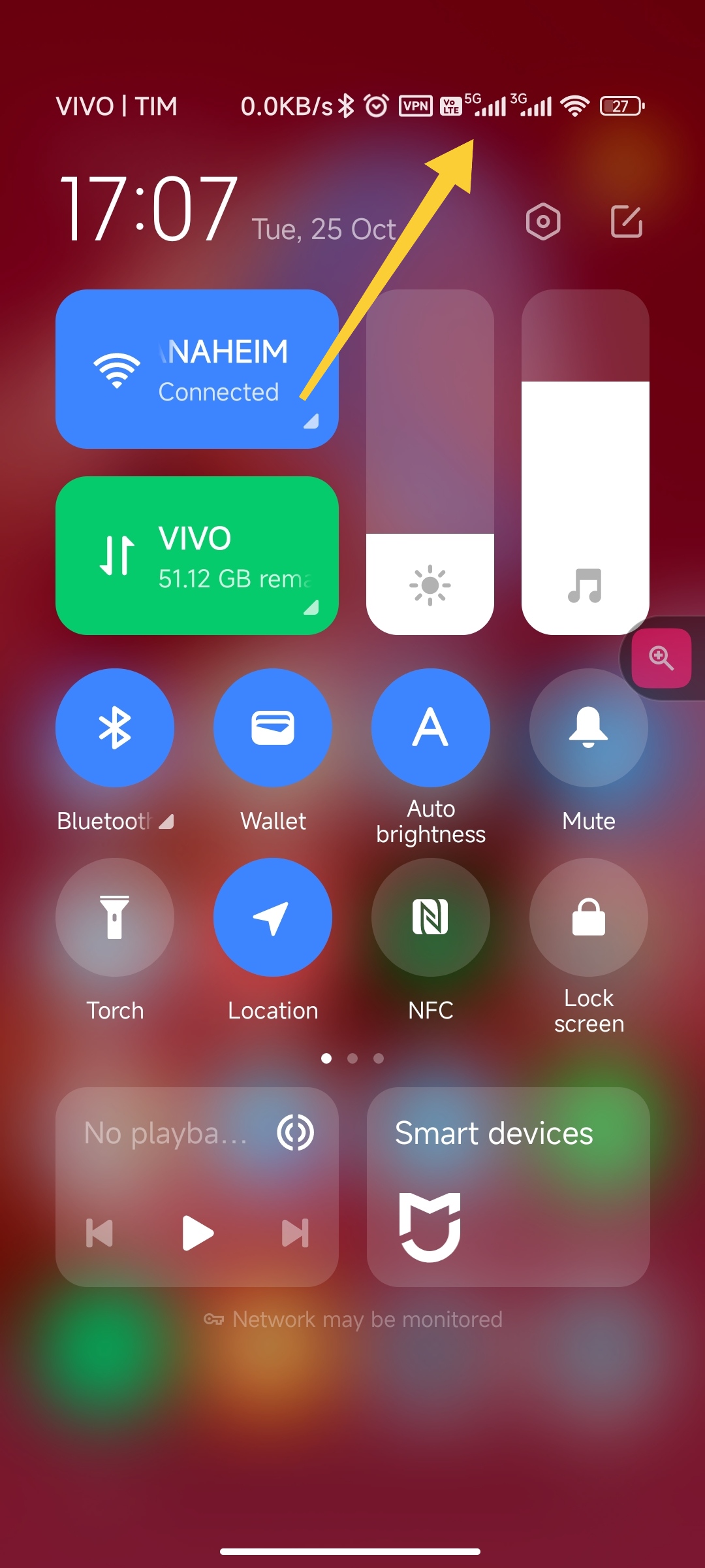

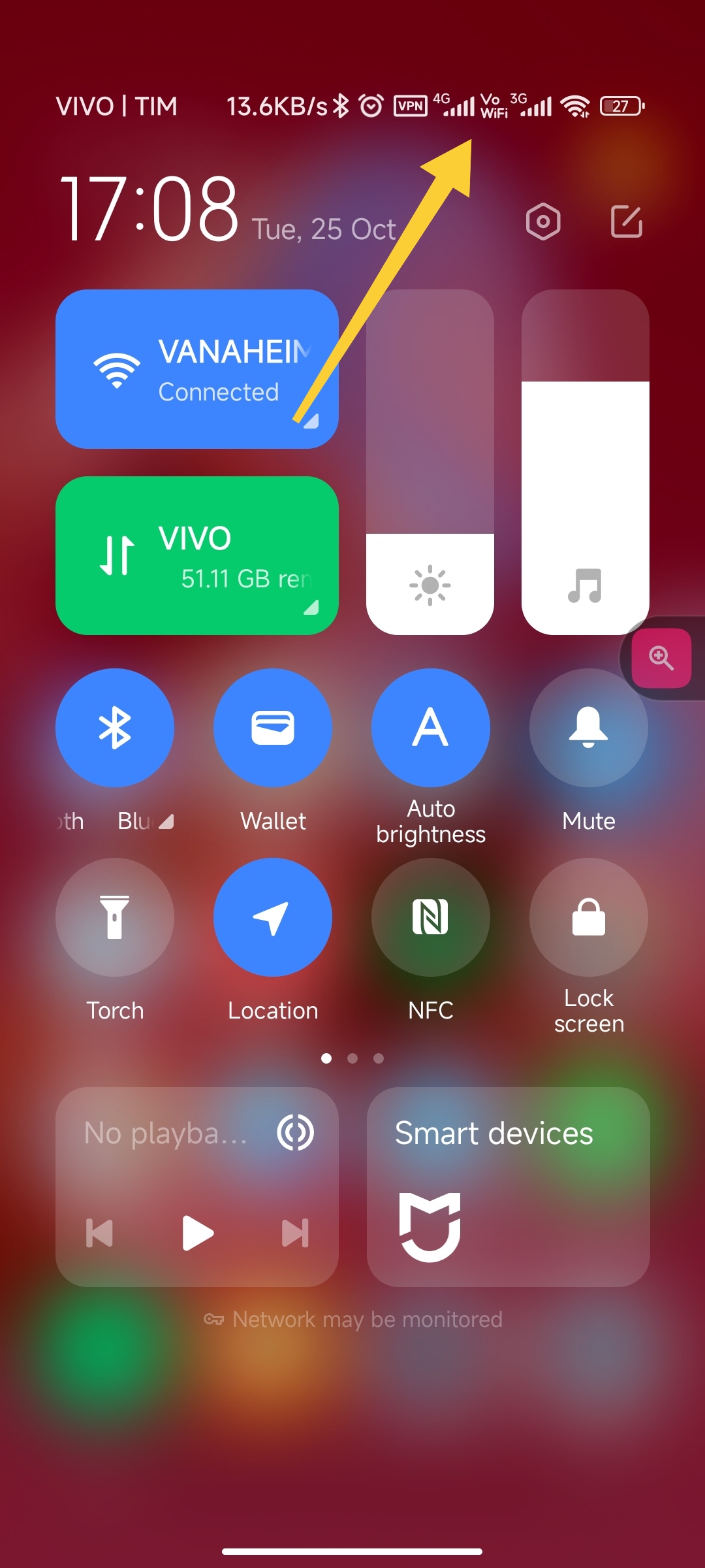

The only workaround I could suggest to you is to enable the VoWiFi (Voice Over WiFi) then all incoming and outgoing calls will be completed over data network when WiFi connected. You can do a try enabling it dialing without spaces * # * # 8 6 9 4 3 4 # * # * and then Settings / SIM cards & mobile networks / <SIM 1 or 2> / Make calls using WiFi <turn ON>

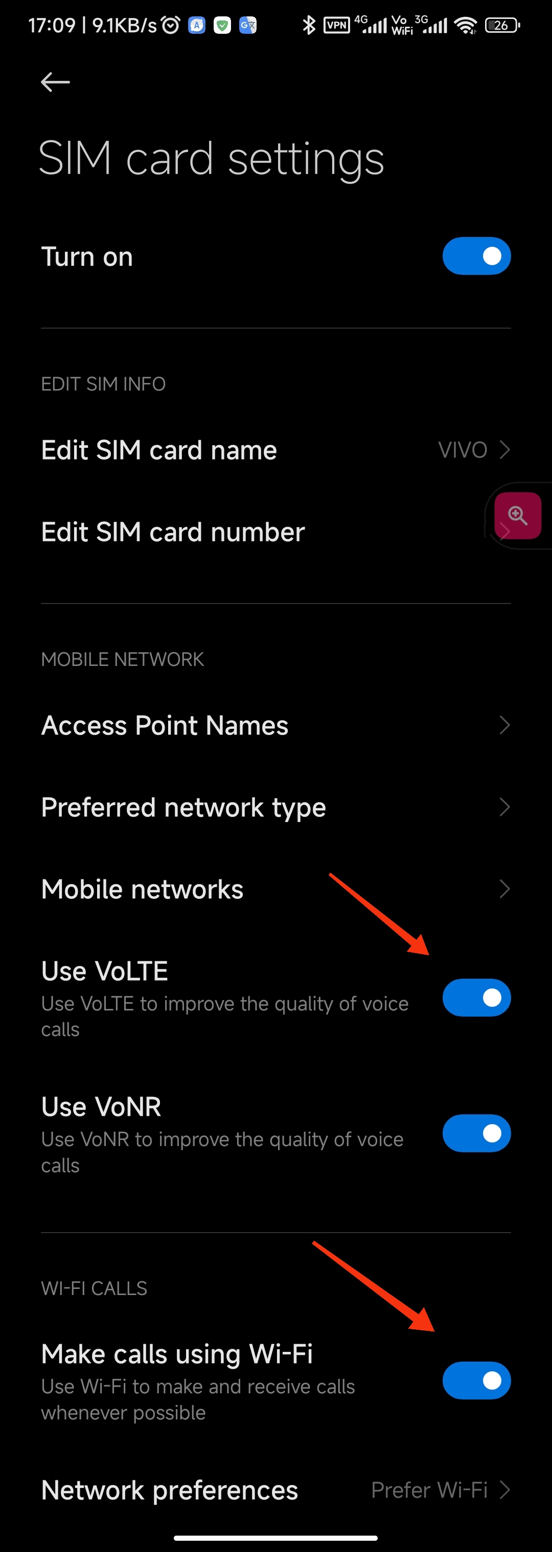

The VoWiFi will handle the indoor signal issue but won't address the outdoor one.
You can also try to enable VoLTE (Voice Over LTE/4G). "Maybe" it helps when outdoor.
The procedure is almost the same, dial without spaces * # * # 8 6 5 8 3 # * # * and then Settings / SIM cards & mobile networks / <SIM 1 or 2> / Use VoLTE <turn ON>
Note: You can leave both options (VoWiFi and VoLTE) enabled. The phone's modem/radio will switch to Data or Base Station when needed.

I really appreciate your recommendations, @Birraque, this solves my issue flawlessly. Thank you heaps for sharing your knowledge with me, it makes my day
