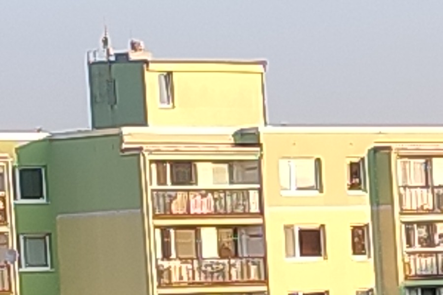

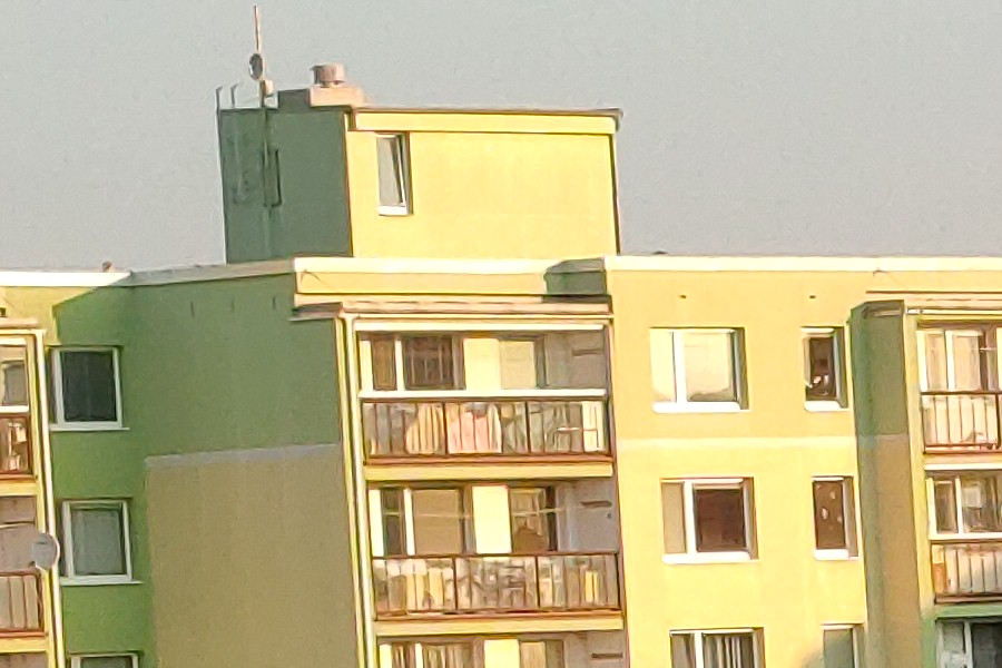

I noticed that the 108MP does not work with ISO>100 on the Redmi note 10 Pro. Affected are both the standard 108MP mode as well as the Pro mode with 108MP turned on. With "does not work" I mean that the resulting photo with ISO>100 (e.g. 125) still has 108MP resolution, but it is fake - it is just upscaled 12MP to 108MP.
I attach only small crops from the 108MP photos, because the originals are too large to be uploaded (101_cr.jpg uses the real 108MP, 112_cr.jpg the fake 108MP).
Photo settings:
- Both photos taken about 10s apart, with the same lightning conditions
- Both photos taken with the stock camera using the pro mode and 108MP mode
- Both photos taken with all the settings automatic except of using a fixed ISO (100 ISO and 125 ISO)
- Both photos taken using a tripod and 2s self-timer to avoid camera shake
Several notes to the behavior:
- When I manually upscale the 12MP photo in the PC I get the same result as the "108MP" fake photo.
- When the fake 108MP is active, the photo is taken very fast (<0.5s), whereas when the true 108MP photo is taken it takes about 1s-2s for the photo to be taken.
- The real 108MP file is usually a lot bigger than the fake 108MP (attached originals are 22MB vs 14MB)
- The real 108MP tends to have a greenish tint
- The fake 108MP is oversharpened, even when viewed zoomed out - exactly like the 12MP photos
- I know that the quality of the photo should decrease with increasing ISO, but the decrease should not be this sharp. Moreover, the quality is almost the same for ISO 50-100 and then for 125-500, the sharp jump is only at ISO 100.
- I reported the issue several weeks ago using the phone Services and feedback function, but have not received any feedback yet.
- Even with ISO <= 100 the real 108MP photo is not always captured - I did not find the reason for that yet. It seems to do with the lightning conditions.
- I tried reseting both phone and camera cache - did not solve the issue
- I use MIUI Global 12.0.13 Stable version. Previously I had some earlier version, which showed this behavior as well.
- I tested this on 2 Redmi note 10 Pro phones, both behaved exactly the same.
I love the potential of the 108MP photos, with it I can do some cropping even on 4K monitor, therefore I would really love to use them. Unfortunatelly It is quite hard to do so. The worst think about this issue is that even with ISO <= 100 the real 108MP is sometimes not taken and therefore I cannot compose the photos as I would if the 108MP would be reliable.
Thanks a lot for support.
