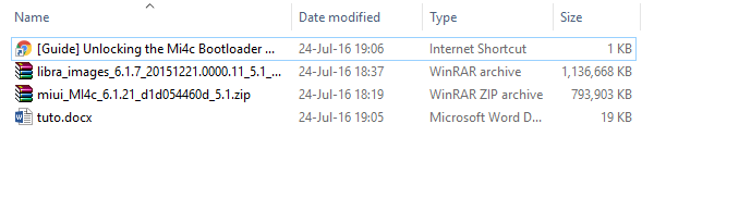

Reactions: amarsriv22
Hi Kudo93. Thanks for your answer.
But the major problem of the method you gave to me is that in the first step, you have to downgrade with the phone update app, and when y try to choose the rom in it, the phone is saying : "install file explorer first"...
Any idea ?
