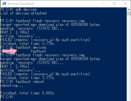

Someone please tell me.
I couldn't flash the TWRP in K40. ”FAILED (remote:(recovery_a) No such partition)"
How that solve it? Thanks in advance.
Read the first page for instructions to install correctly the twrp.
There is a link to go to the xda

Thank you for your advice.
Ahh, This time procedule is not same usual. This can't be installed directly from the flash of Fastboot command. This was necessary to start TWRP once by boot command.

No need to install it prior flashing latest EU rom.
Just load the ROM zip into your phone and boot TWRP from fastboot instruction.
Once booted in, install the rom.
TWRP will be installed in a row for next purpose.

Thank u.I made it ! I didn't decrypt my phone before,haha.
