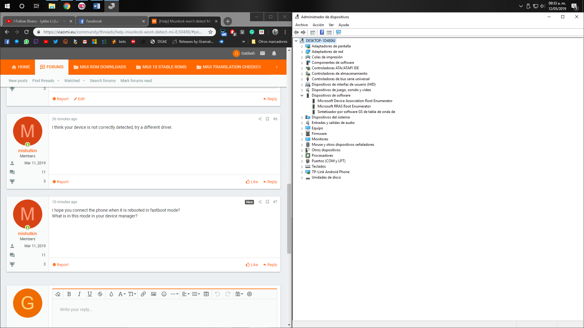

I hope you connect the phone when it is rebooted in fastboot mode?
What is in this mode in your device manager?
nothing shows, as you can see, even the usb devices are not showing :0

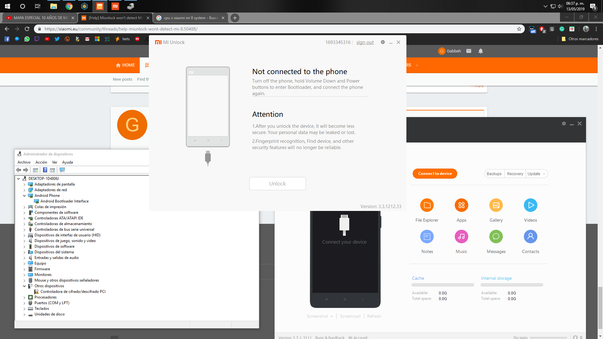

i made it work for a sec by installing mipcsuite but when i click on unlock, miunlock just stops and did nothing

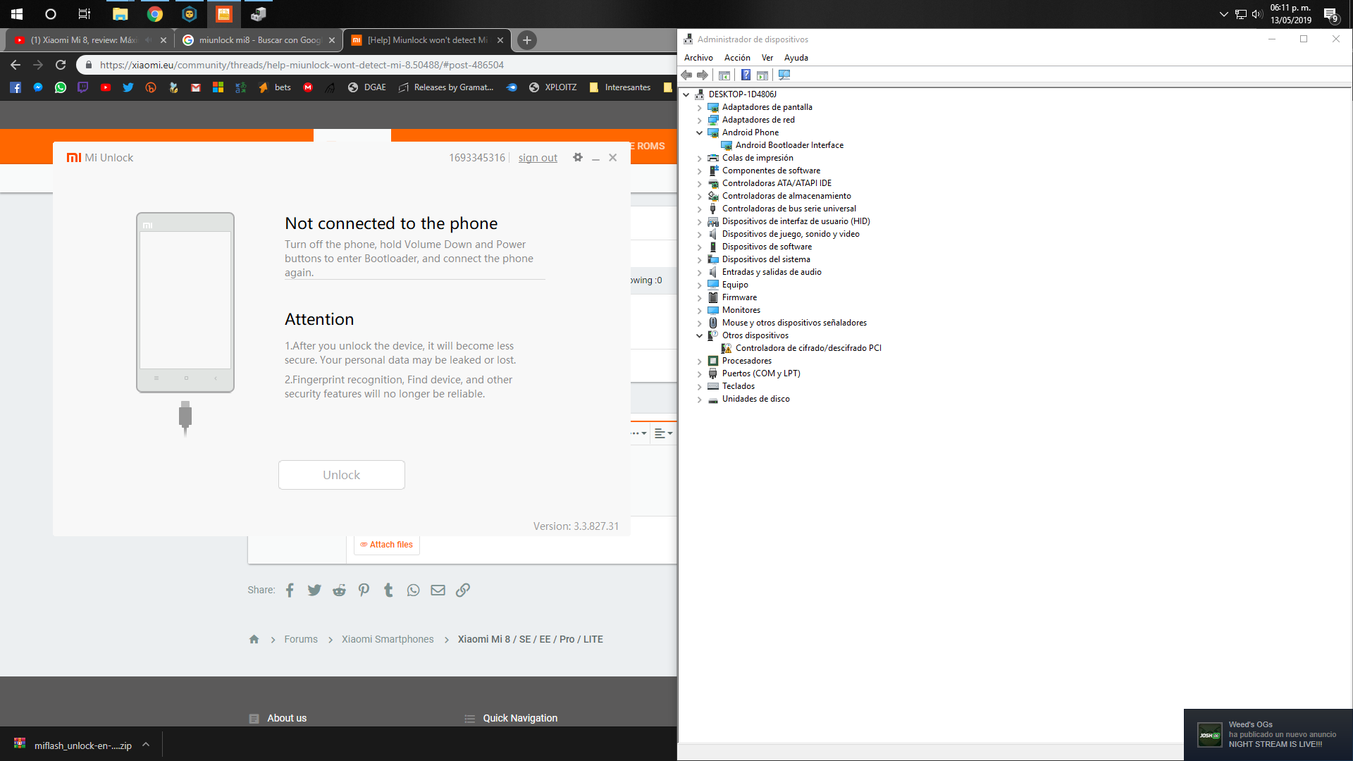

update #2:
I did it, just move to another computer which is virgin from xiaomi drivers, used miunlock and the drivers that comes with, everything worked
