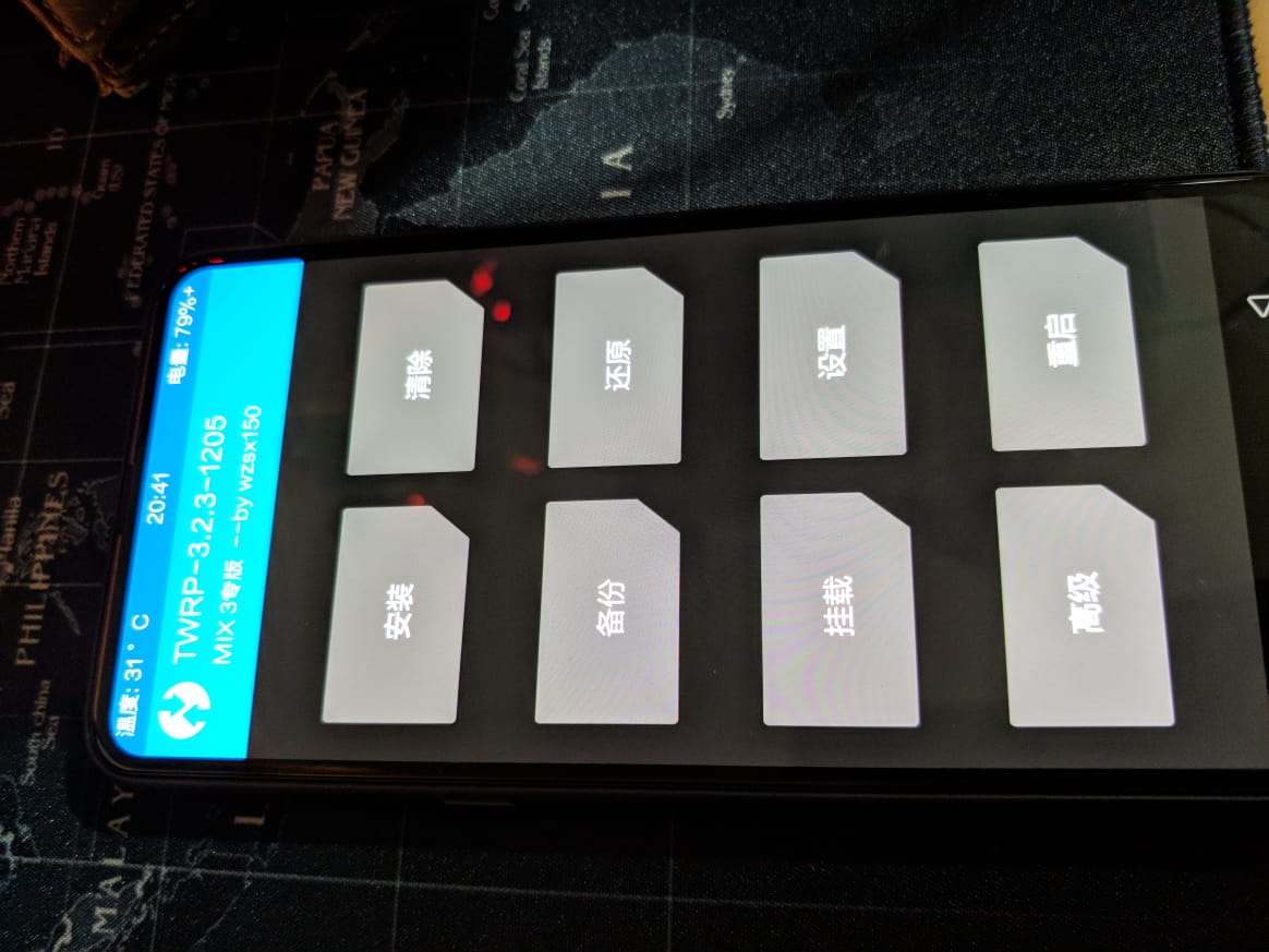

This TWRP doesn't answer to command boot...so after u flash recovery just boot in recovery manually (power + volume up).
Then when u r in TWRP go in wipe choose format data typing yes...copy the rom in ur device via pc. When u copied choose install n flash rom via twrp. Then go in wipe make swipe n boot to system

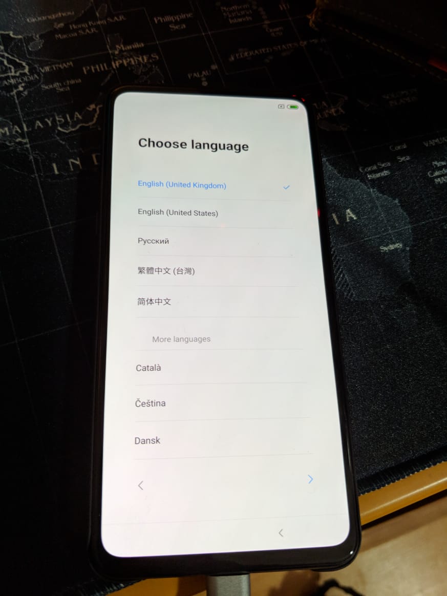

even with power + vol up it does not boot in twrp
it boot to mi recovery
Put it in English, choose the 3th on the right n then go on the globe...I'm not able with chinese
Inviato dal mio MIX 3 utilizzando Tapatalk
okayyy now is english
i think iam ok
